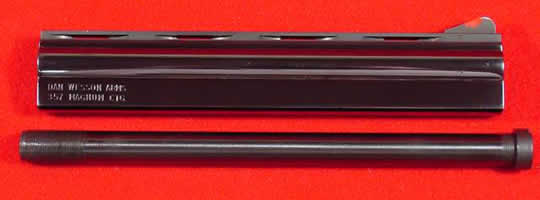

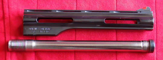

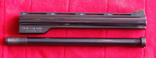

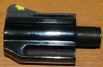

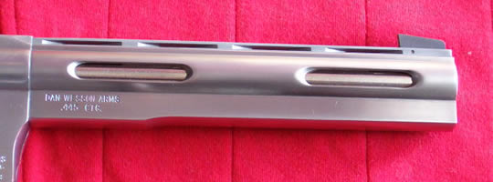

Orginially Dan Wesson Revolvers were offered with ‘Pork Chop’ type shrouds. Â The ‘Pork Chop’ shroud was replaced around 1975/6 by the straight shroud. Â The images below show the different types of shrouds offered by Dan Wesson over the years.

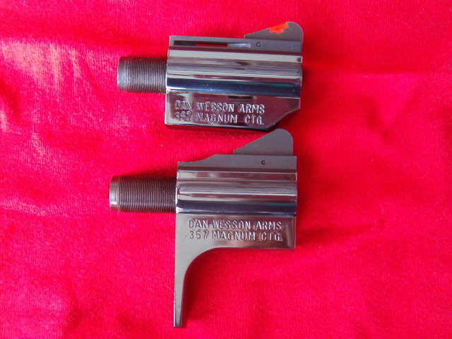

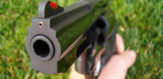

Below are two images that show the difference between the older pork chop shroud and the newer straight shroud.
| Straight Shroud | Pork Chop Shroud |

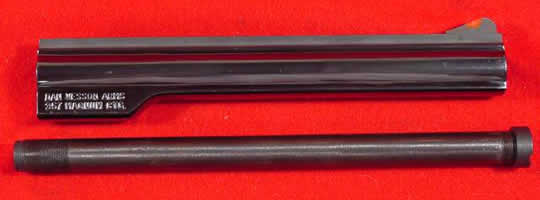

As you can see the pork chop shroud has a tang that extends down which is missing on the newer straight shroud. Â The following photo shows the shrouds side by side:

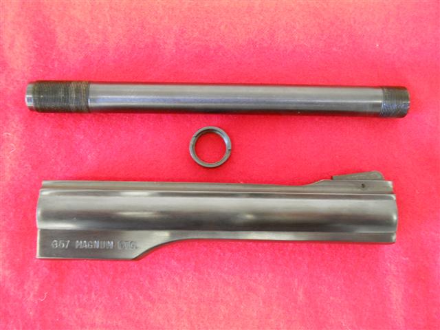

The newer straight shroud was offered in several variations which are listed below:
