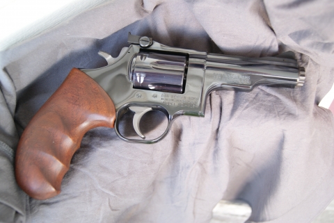

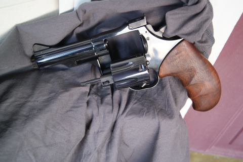

Anyway, that's my take, sorry for the novel. confused And again, I don't intend to offend with my opinion, I hope you take it that way. In the end, you still landed a really cool DW with a brief, but neat history here on the dwf I would love to see a range report, and hear your thoughts on shooting one of the ones that started the whole history! BTW, if it's cleaner than your pics show, and you decide to not fire it, I will stand with ya! Because I have a handful of DW's of my own that remain unfired outside of the first day at DW. One of which is the W12 in that top photo, practically zero (also, one of the 12's has had maybe a box of rounds down the pipe, the other practically zero). Here are some closer pics I took today of my (unfired outside DW) W12...
DSC00025.JPGImage Enlarger
DSC00026.JPGImage Enlarger
DSC00024.JPGImage Enlarger
