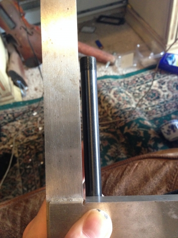

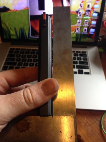

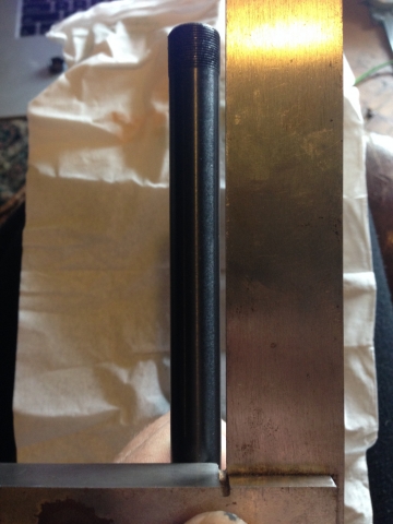

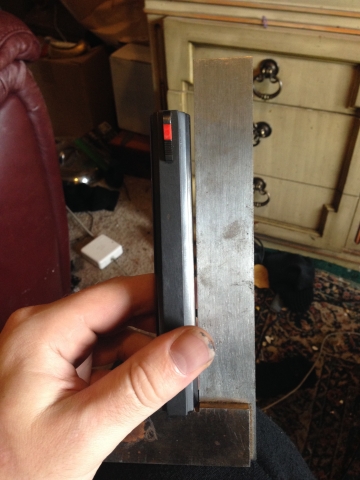

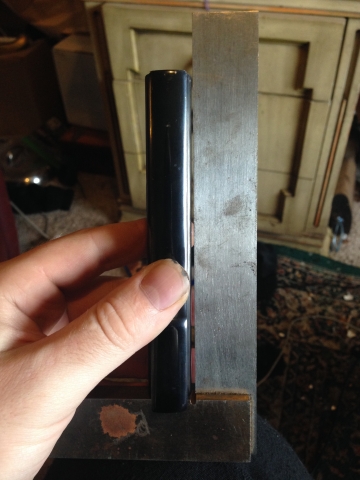

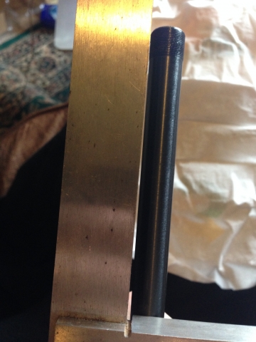

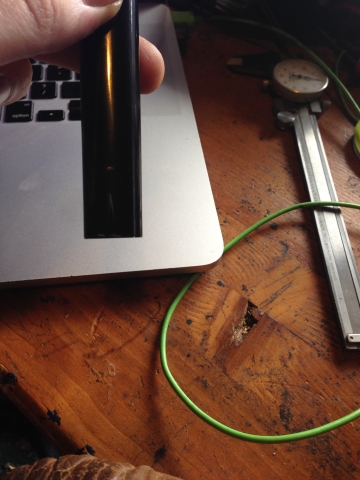

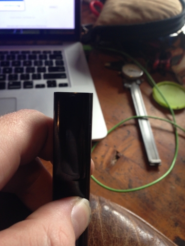

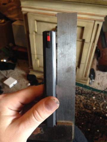

i did my best in the photos to represent what i was talking about.  but i noticed that when assembled my barrel seemed to point left, and i thought no way!.  but using a straight edge and a right angle, i confirmed my suspicions.  the base of the housing of the barrel is not a perfect right angle, and the barrel itself as well points to the left.  i've had it for 3 days, and have shot about 100 rounds through it before i noticed.  the front of the of barrel housing is mirrored in the angle as well.  the frame itself seems to be fine, so this would mean the threading in the frame is canted to the left.  it was such a nice revolver and such a great find, it just goes to show don't trust anyone in colorado…you can't really tell the barrel is crooked if the tension of the housing isn't fully tightened.  so when i tightened it it started to show. no wonder it wouldn't shoot straight!

incase you didn't notice, i took the shroud off and the base of the shroud that meets the frame is not perfectly 90 degree.

i experienced the same when i tried to post.   bummer about the barrel.  keep the frame and get another shroud and barrel.

it seems to be the base of the shroud isn't angle to 90 degrees, and the barrel has a little play off the frame, i think that some truing up of the shroud and inner shroud alignment should force the barrel straight from the frame. was hoping to have some reassurance from the dan wesson forum because i figured people here would know a little about dan wessons.

I would try and find some gunsmith tooling that utilizes the barrel’s bore centerline versus the external features of both the barrel and shroud to check alignment including orientation of threads.  Might need to check the frame as well.  This might require a visit to a certified gunsmith or at least the tooling used for a center-bore lathe setup.  Use of a right angle tool for this is subject to error.

   Bobaby, Dan Wesson barrel assemblies are fungible. Find another and you will have a fine gun in all likelihood. You can have the frame end of the shroud milled perpendicular and it would likely work but the work by a gunsmith would probably cost  about what a barrel assembly would cost. eBay or Gunbroker are your best options for a BA. Many members have extras but dealing with you would be a real pain I am sure. BTW, I am one of the World's nicest guys. Or so I am told. Forum friends, please forgive my in temperance.

if you think it is the base that is off, you can either ditch the shroud and find a new one, or try to get it machined to level it.
 i saw an episode of "log men" a while back (forgive me, nothing else going on that particular moment in time) where one of the knuckleheads on there was using a 10 inch barrel ruger blackhawk to pry on a tree he was trying to fell.      the point?   you never know what kind of crap has been done to/with a gun before you owned it.
the key is dianosing exactly where the nexus of the problem is, then address it from there.  if the barrel is bent, obviously a new barrel and shroud are in order.   if you believe it's the base of the shroud, try correcting that or get a new shroud.
