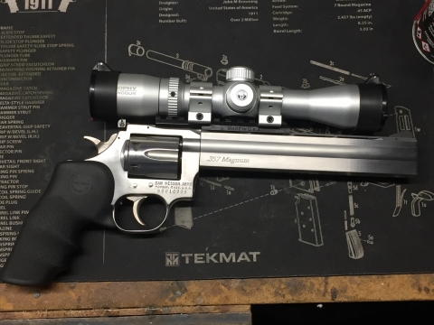

This is my Monson 715 with a newer CZ barrel assembly (purchased in 2019 from CZ webstore) before the barrel split the frame…barrel tube wasn’t heat treated and split after roughly 2500 rounds.
https://www.danwessonforum.com/forum/revolvers/my-monson-715-barrel-and-frame-split-f/
1D1F1BE0-2E61-4E62-B792-8D7A239050E3.jpegImage Enlarger
93341249-51B4-4EC5-B770-FBFEA5777849.jpegImage Enlarger

Thanks Andrew. Like they say: A picture is worth a thousand words. Very helpful.

Ah yes. Much better fit where the shroud meets the frame.

I deleted my post because I realized that was the same shroud from when my Monson frame split. And it’s now on a new CZ/DW frame. So not really relevant to your original post 😂
