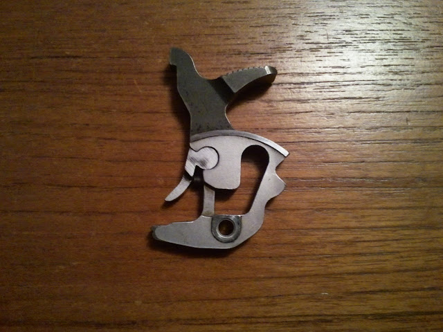

Just took my 15-2 apart, checking the action to refresh my memory. If I remove the DA-sear (the spring loaded thingie that slides out from the hammer to the side) the hammer won't move when I pull the trigger, quick sing action only fix.
Here's a pic of my spare hammer:
SHOOT: if you remove the bottom part of the hammer wont that remove the single action function of the revolver, thus converting it to double action only?

Would the above hammer not work in a Model 15-2? Looks a little different from the above hammer. Listed for a model 15
Jubba
Forum Posts: 36
July 11, 2010
January 29, 2011 - 12:47 am
Ok, just for clarification to convert the gun to single action, do you only need to remove the spring from #1, do you have to remove #2, or both?
Edit: Picture was stolen from another member / post. 😛
January 29, 2011 - 8:19 am
You just completely remove #2 to convert one to SA only.
