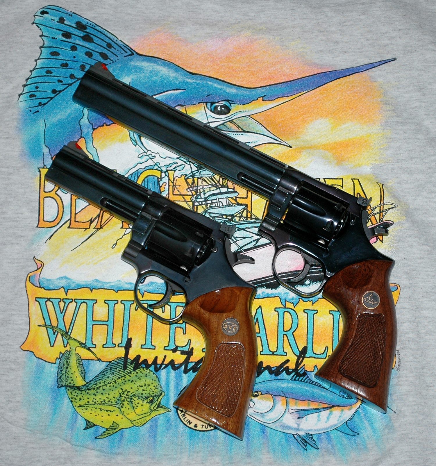

Both of my 15-2's show slight plumb color just under the crane in front of the trigger guard. Both made in 77-78. 2-DANS-e.jpgImage Enlarger
GREAT revolvers! You may notice they have slightly different hammers and triggers.
