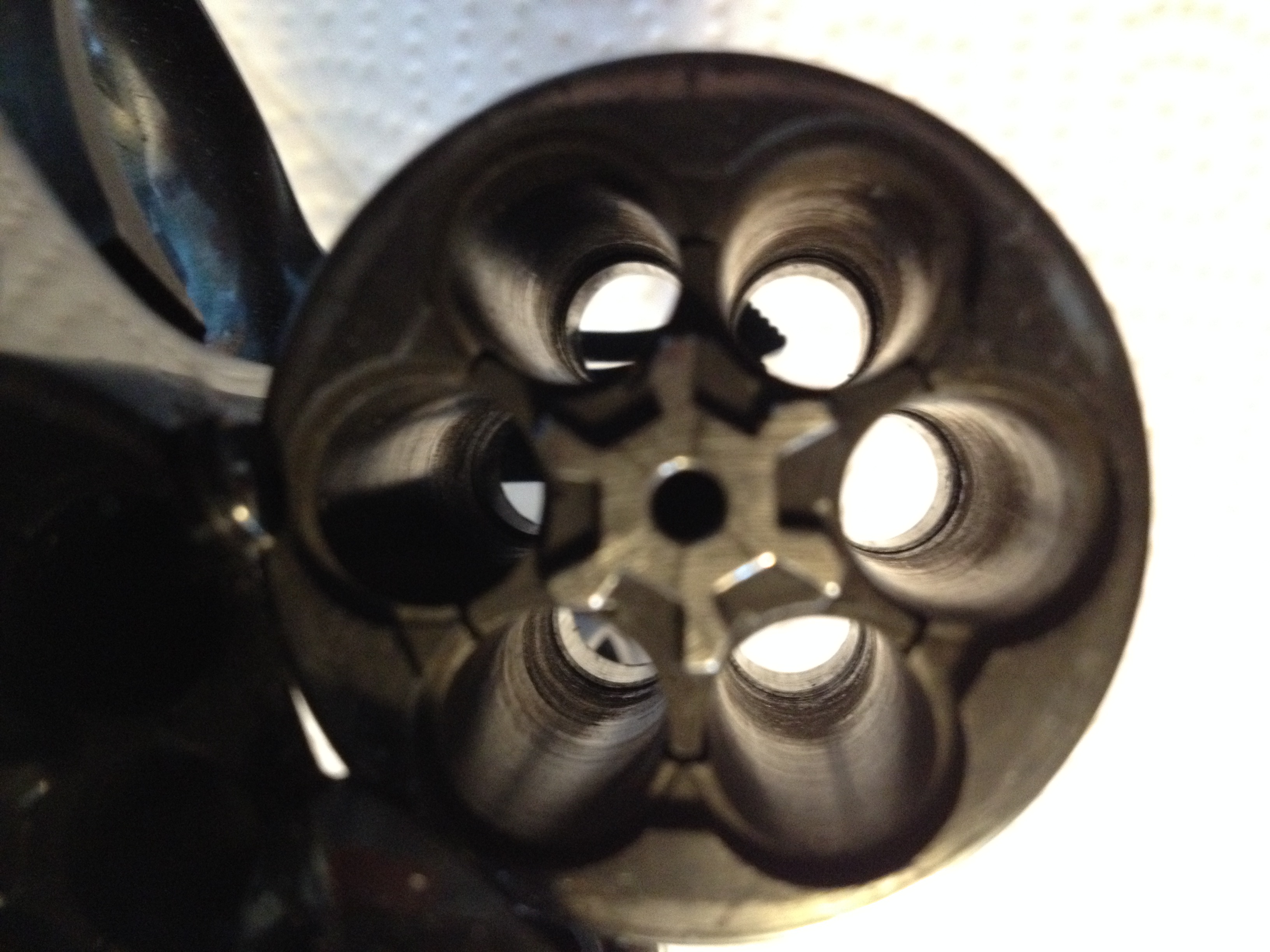

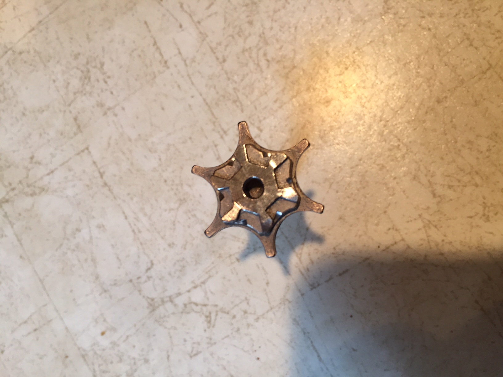

December 31, 2015 - 3:04 pm
I don't see anything strange with the extractor. I totally disassembled and cleaned and it did not change the problem. Is it possible it is the hand or spring? If so where could you buy the hand?IMG_2060.JPGImage Enlarger

December 31, 2015 - 3:39 pm
In your third photo I think I see the extractor leg at the 12:00 position somewhat misaligned. The one immediately preceding is slightly off and the one following is also a bit off. Maybe a bent ejector rod?
December 31, 2015 - 5:13 pm
Your extractor looks distorted, almost twisted out of shape. As Steve said, could be a bent (twisted?) ejector rod.  Take it apart and let us know what you find.

Have to agree, looks like it may be bent but it may be just the way you have it rested on...(your leg?)  Disassemble and roll it on a flat surface.  Be sure to pad your pliers.

December 31, 2015 - 6:02 pm
Yes that looks like a possibility. The question is how can it be fixed or where could you acquire an extractor. Also once you have the cylinder out how do you remove the extractor?
December 31, 2015 - 6:35 pm
The extractor screws onto the ejector rod. Check first for a straight and true ejector rod. Yours could be a little bent and twisted, and that will allow a chamber specific FTF.

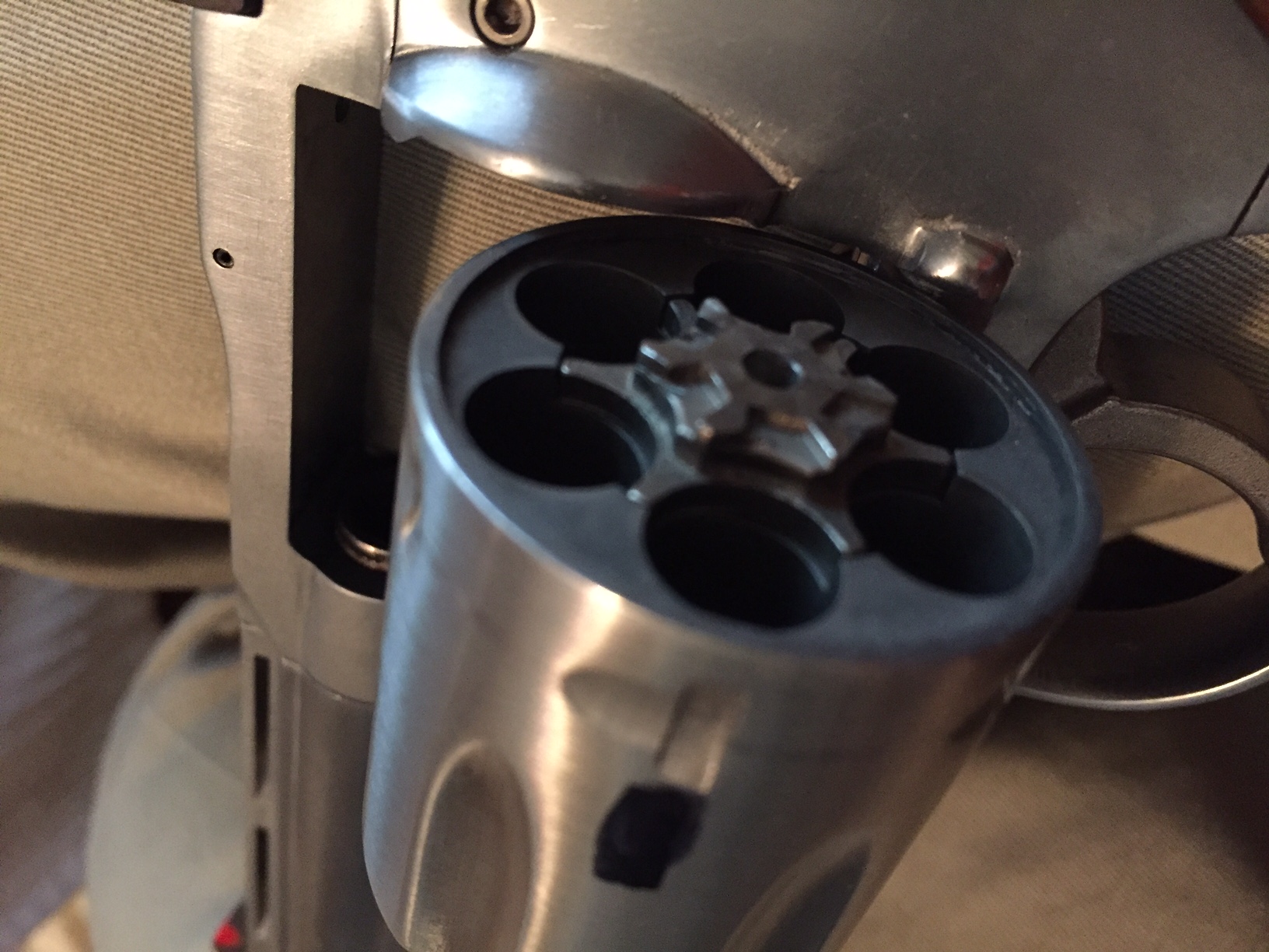

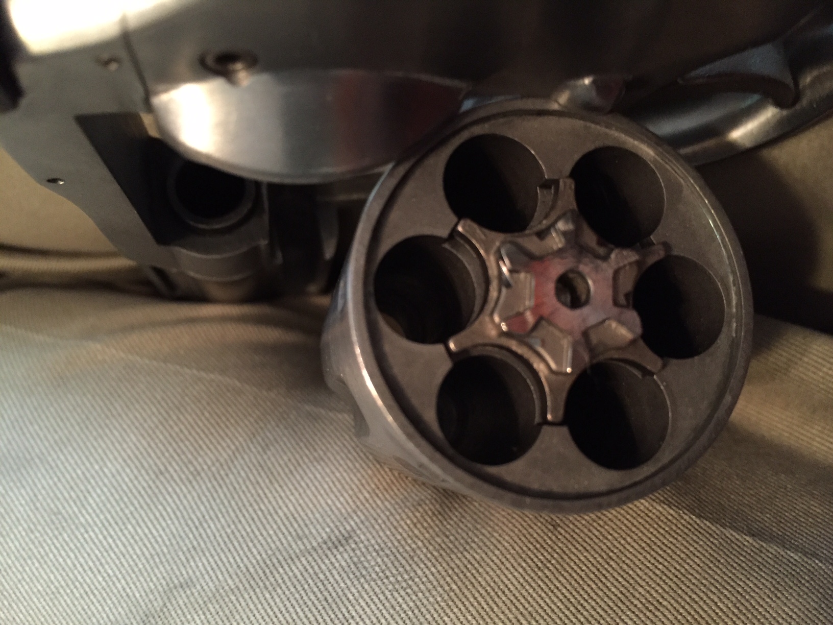

January 1, 2016 - 10:52 am
It appears to be the ejector. The rod is straight. It looks like either what I would call the ejector or the hand that moves the cylinder. So what would be the places I could get those parts? It looks like some of the points that the arm moves the cylinder are misaligned. IMG_2068.JPGImage Enlarger
IMG_2072.JPGImage Enlarger
January 1, 2016 - 11:55 am
The part you are referring to is actually (in DW nomenclature) the extractor, and it is available from DW in Norwich, NY. It is considered by them to be a "gunsmith install" item, it's possible that they wont sell it to you. The extractor and hand need to be fitted to properly time the firing cycle.

January 1, 2016 - 1:39 pm
You can either send to them or have a local gunsmith order it.  I would get both hand and extractor, if it were me. A competent smith may even be able to shape it without new parts...

January 1, 2016 - 8:32 pm
I agree wit Ron. If you get one, best to get both. Easier to fit 2 new parts.
January 1, 2016 - 11:34 pm
I agree too, this one needs new parts, that ejector star appears to have been made for another gun entirely. Maybe a trip back to mother DW is best? Or at least a competent smith.

January 3, 2016 - 5:20 pm

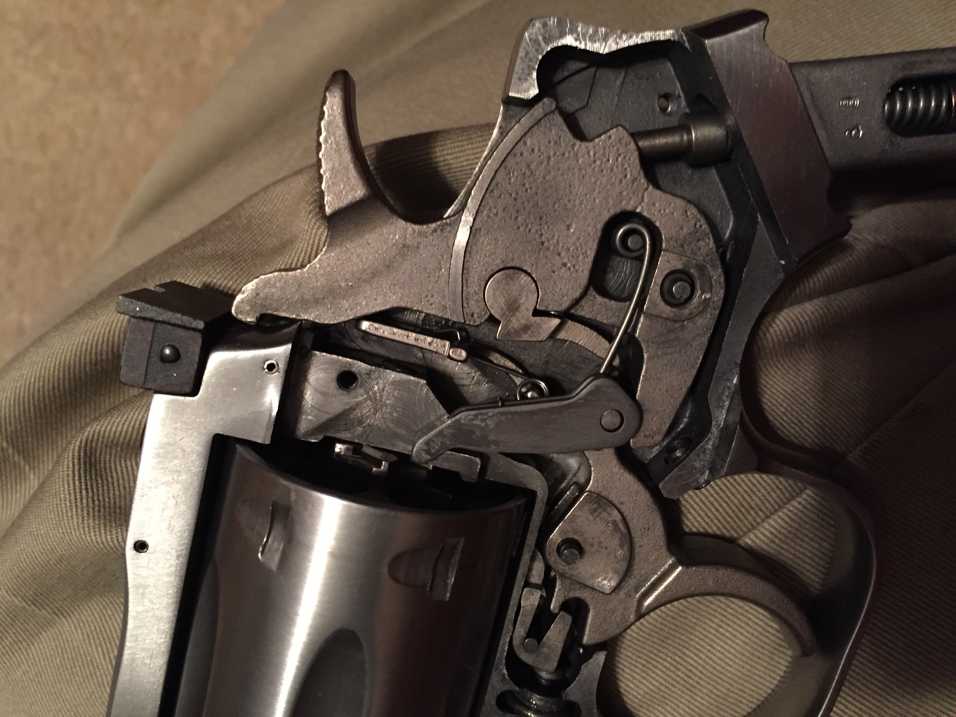

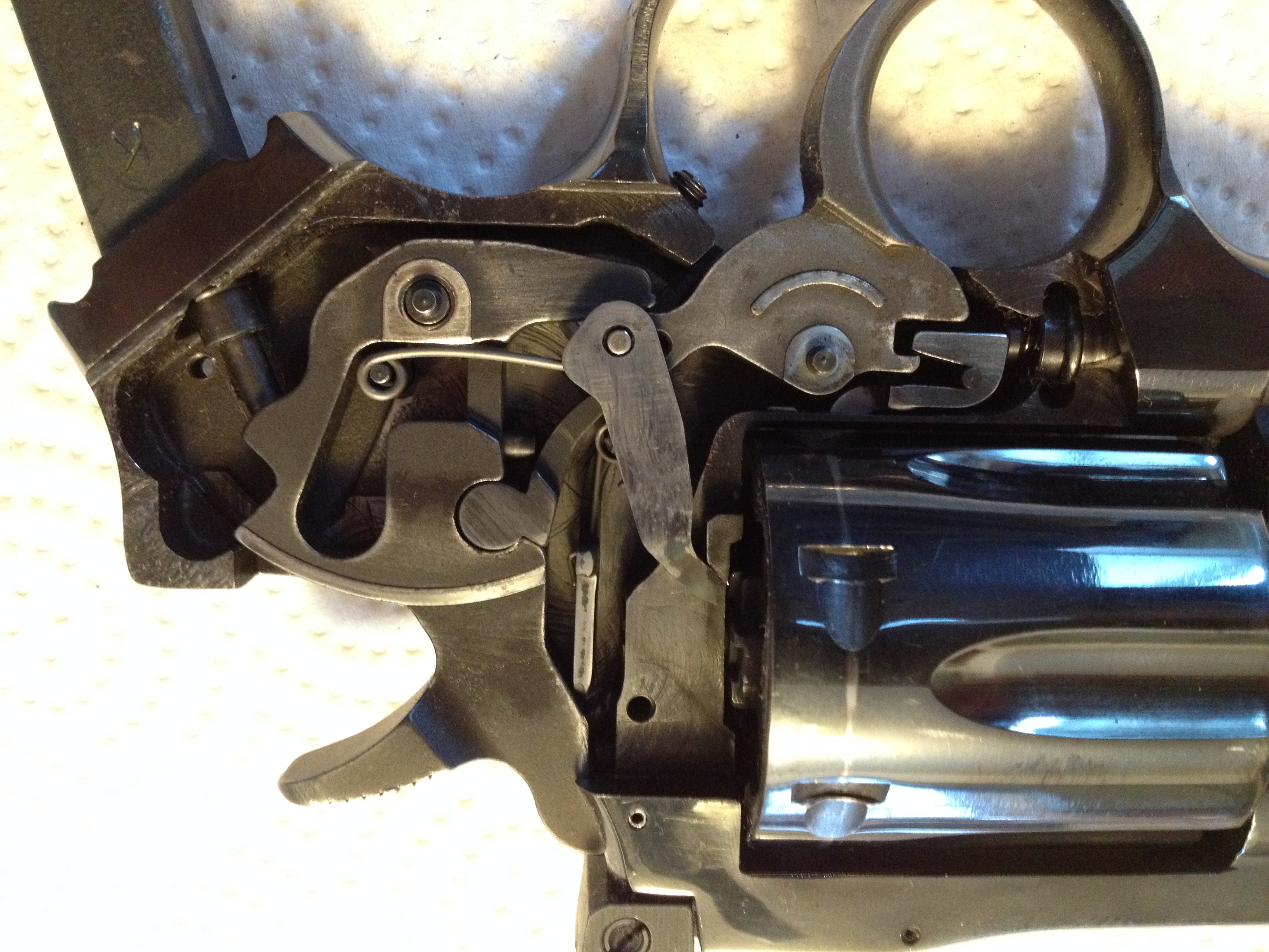

I agree the extractor is damaged or the wrong one (or both). The rear of the cylinder of your 715 is machined differently than my 15-2. Perhaps it is the wrong replacement.
The hammer strut is in the rear position in your photo. Mine is forward when I remove the side plate. How is your spring and plunger?
Can't go wrong with Wolff Springs. Shooters pack #32310.
I had trigger return problems and with help from the DWF cured them.

January 3, 2016 - 5:47 pm
The cylinder shown in the post above is from an earlier production 15-2 with recessed chambers. The extractor would be the same for later production 15-2 and 715 revolvers.
