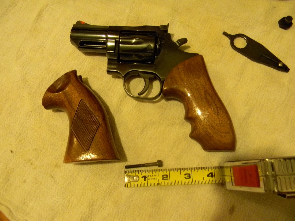

Credit where credit is due, looks like shootist357 noted the friction problem. And to Steve CT, what do you know, in one of the little envelopes there's a second grip screw... I believe that I have everything seated properly, I was sure to get the transfer bar spring to ride in the groove on the back of the hand and the return spring rests on it's groove and I don't think it's pushing the hand out of place. Carbon buildup is nonexistant and for cylinder gap, had to pick up the .006 gauge from EWK before it was fired to check that the barrel was properly installed. I'm going to look into the grip screw arrangement and make sure I've got everything settled into the right places. Friendly rebuff to my Kansas neighbor, I think I'll keep her on the bushwhacking side of the stateline...

Thanks guys, I think my warm up session heated up some goo and then my less than astute cleaning and reassembly didn't help. On the bright side, I haven't broken anything and I've learned an awful lot. I am wondering what length grip screw I should have for the two grips. The two screws I have are the same length at 1.75". Funtioning fine now but am I waiting for a problem.
December 2, 2011 - 9:47 pm
One other aspect of the grip screw length question is how deeply the grip screw hole in the grip has been inletted. Some people can crank that sucker down so tight that the screw hole depth gets changed a little bit.
I think the grip screw lengths are 1.75" and 1.5". Some grip screws were supplied with a "captured" washer that may have gotten lost over time.
