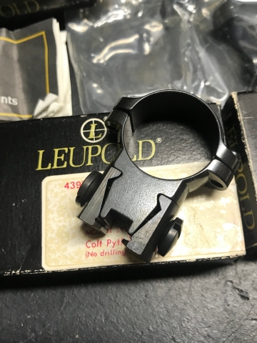

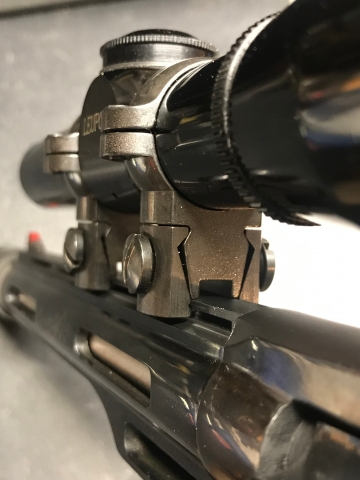

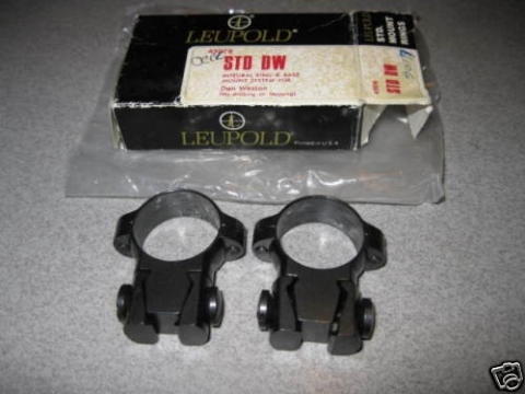

I recently found that the Leupold Colt Python rings which mount on the vent frame also work on the Dan Wesson Vent frame of my .357 Supermag.  Even after a session at the range, the rings were still tight. The only difference between these and the ones for the Dan Wesson appears to be the cutout in the middle which is required on the Python.  While they are also discontinued, you may find some on Ebay, etc.
IMG_8102-1.jpgImage Enlarger
IMG_8105-1.jpgImage Enlarger
The Dan Wesson Mount Rings:
leupold-blue.jpgImage Enlarger
