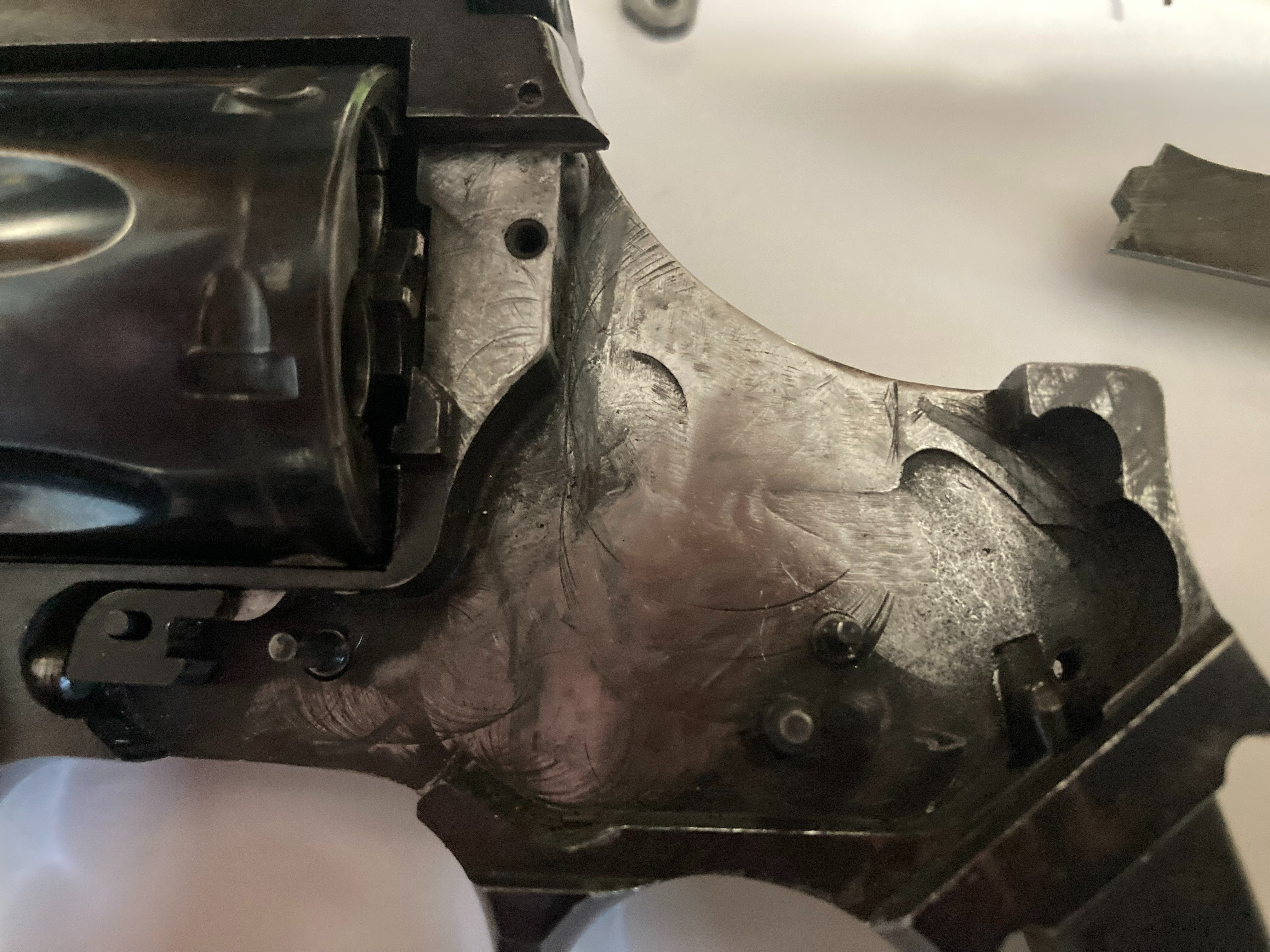

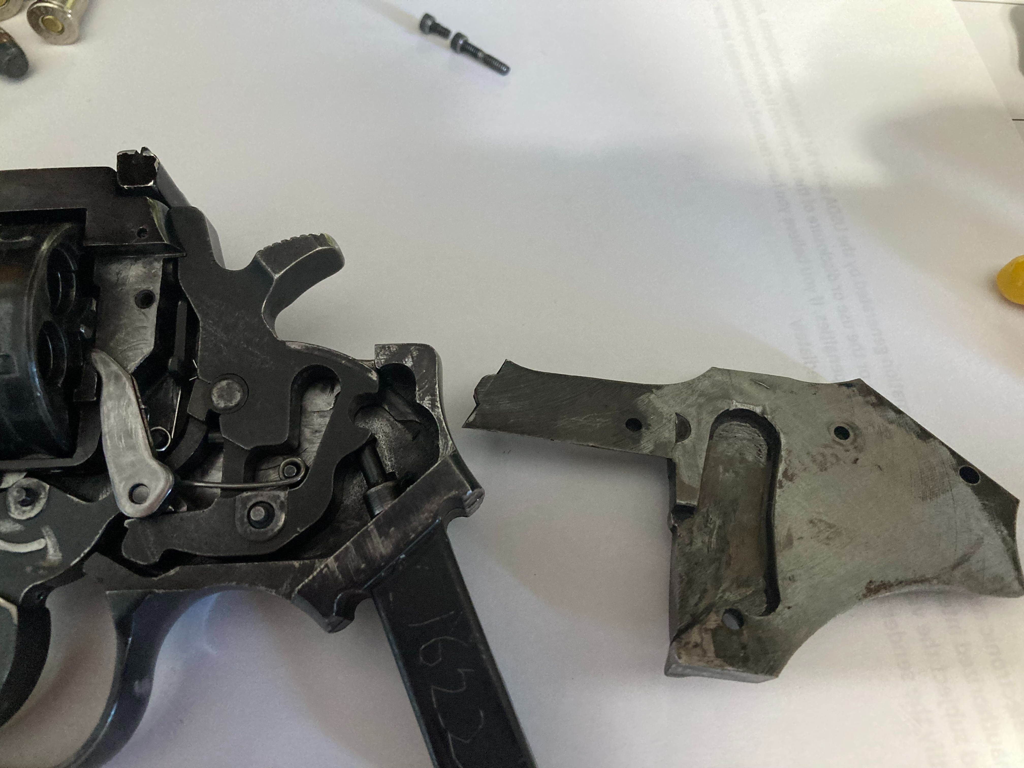

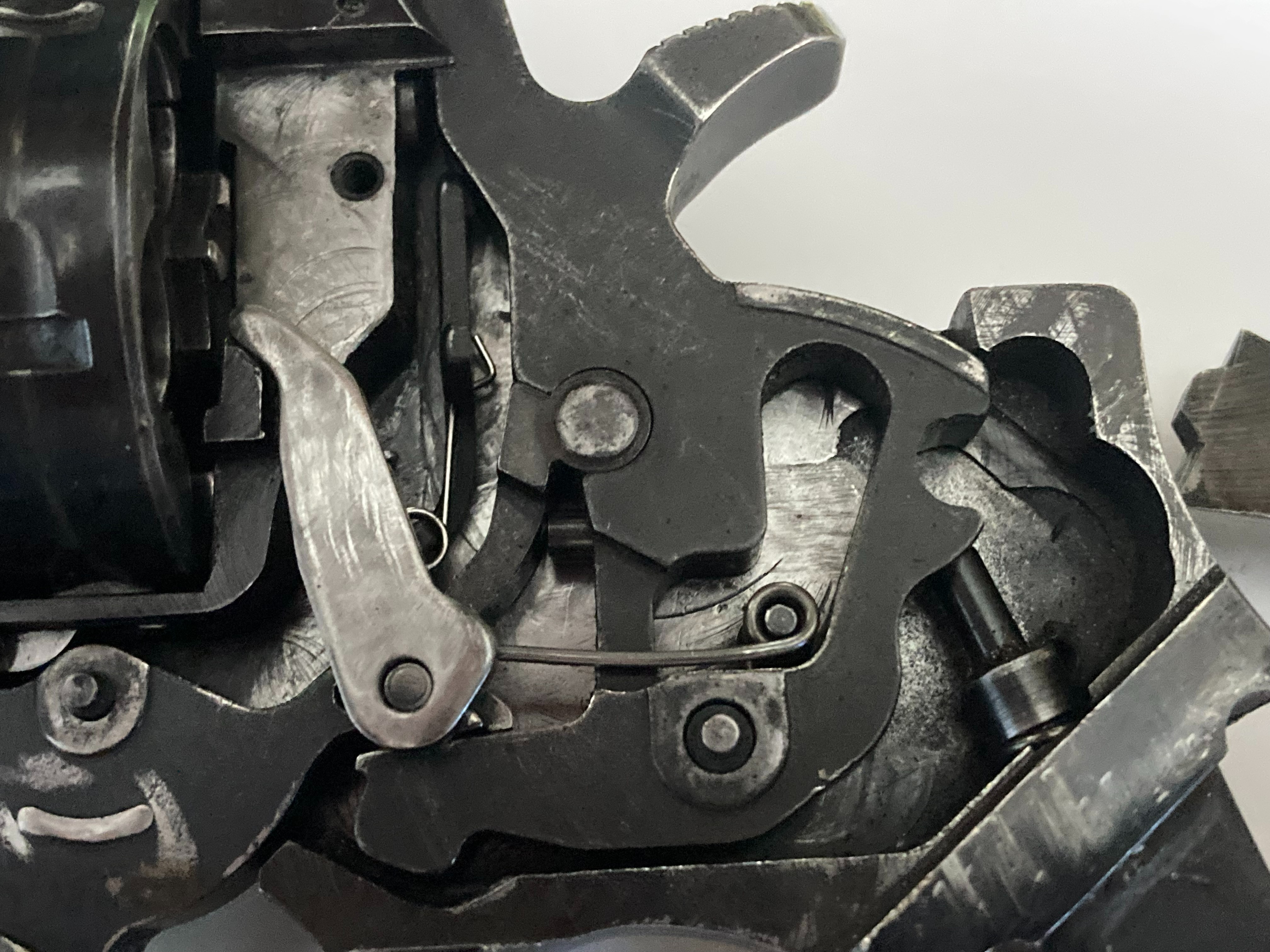

With that serial number you definitely have a DW15-1. Mine is 39###. These  have the same lock work as the 15-2’s with the exception of the firing pin as Ole Dog has described. Unfortunately the newer firing pin will not fit in a pork chop. The best you could do would be to have a machinist grind down a newer pin to fit. I think it’s unlikely the firing pin spring is broken, but it’s possible. Also, it’s quite a different task to shim the cylinder on a pork chop; you have to purchase special shims specifically for these guns and place them underneath the removable cylinder collar/gas ring. The heavy main spring you installed should have fixed the light strikes, so there is something else causing this to happen. Ole Dog’s suggestion of cleaning out the firing pin recess is a good one. Examine the pin closely for any damage. For further analysis a few photos with the side plate removed would be helpful.

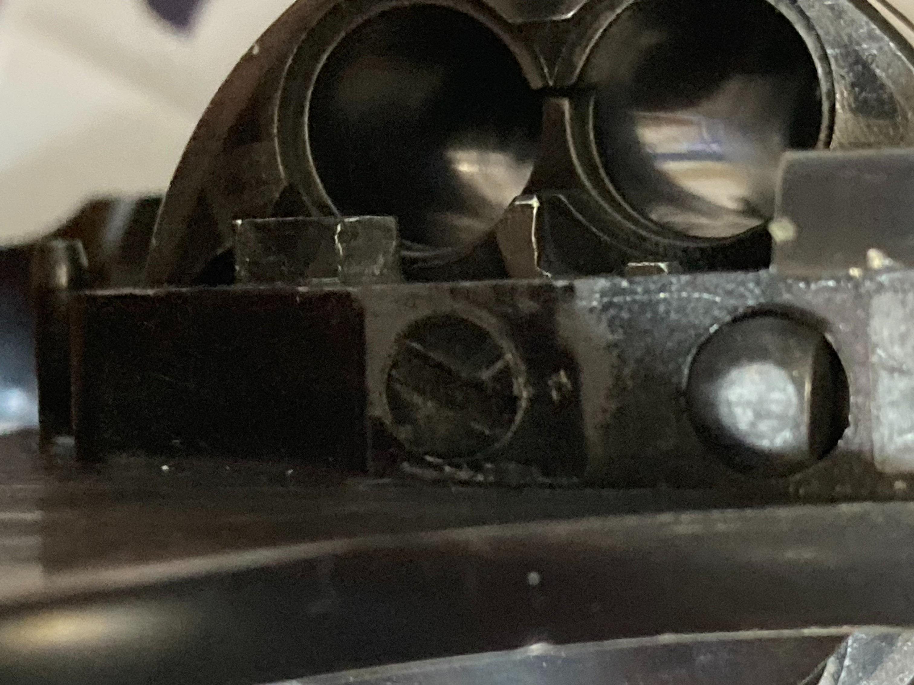

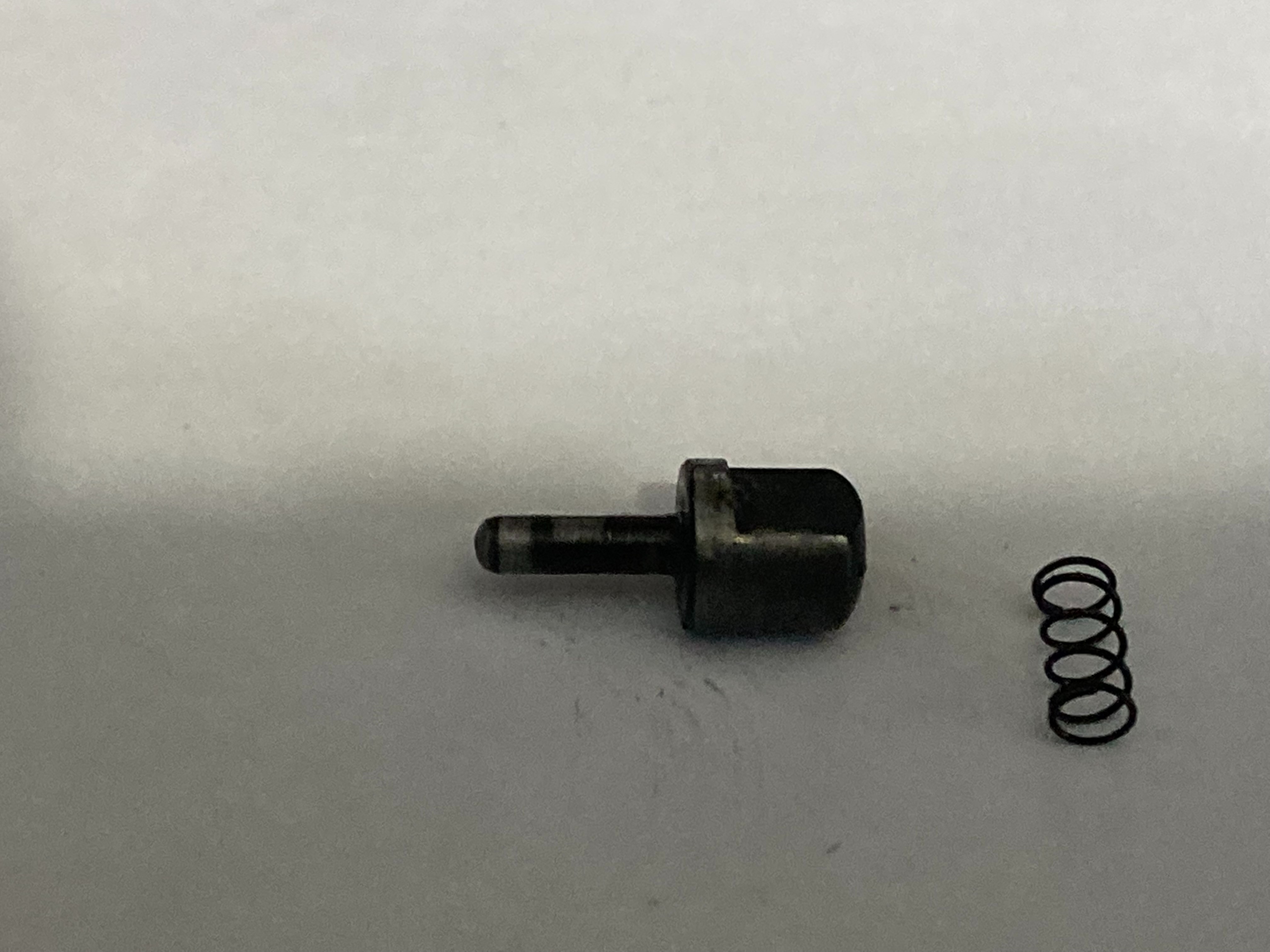

September 28, 2022 - 6:25 pm
IMG_0016.JPGImage Enlarger
IMG_0017.JPGImage Enlarger
IMG_0018.JPGImage Enlarger
IMG_0019.JPGImage Enlarger
IMG_0015.JPGImage Enlarger

The internals are polished and are smooth as glass.
The firing pin is nothing i have ever seen before
Forum Posts: 4344
September 28, 2022 - 7:13 pm
The firing pin appears okay. Try different ammos. Some have harder primers than others. 3ric is correct about the stout hammer spri g not bei g the problem.

Yes, that’s definitely a pork chop firing pin, and in fine condition. I’m beginning to wonder if your light primer strikes could be off center strikes. We had a case recently where it turned out that the upper crane leg was slightly bent causing off center hits; thus the rounds failed to fire. You’ve stated that you replaced the hand; was it worn/damaged? When firing double action, the hammer drops a tad earlier than in single action, and this sometimes does not allow for full rotation and lockup of the cylinder. Some folks like to “stage” the hammer fall in double action rather than a steady follow through with the trigger. I personally don’t think DW’s lend themselves to this approach. Could you examine the non firing rounds to check for off center hits? Worth a look.  Does this revolver pass the SLOW hammer draw test; cylinder fully locked in place before the hammer reaches full cock position? Otherwise, I’m really stumped on this one.
