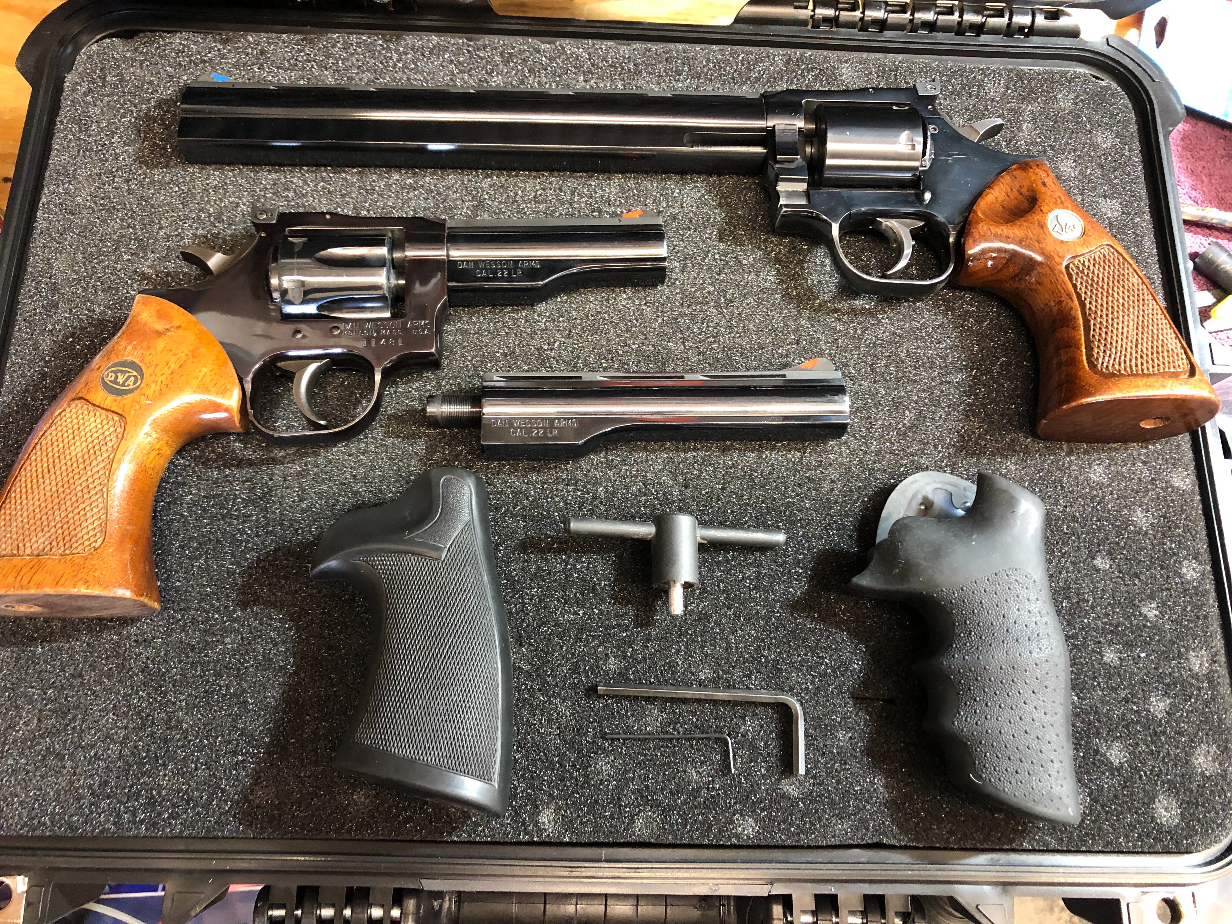

January 19, 2022 - 9:57 pm
52DE58C1-51BF-4472-8895-1378225AFFEC.jpegImage Enlarger
I had Bob do a dedicated 22 mag for me from a 22lr. I had him fit it with an unfluted cylinder so I wouldn’t confuse it with my 22lr. I’d never shot 22 mag before and really like it with the 10” barrel. Two thumbs up from me.
