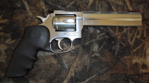

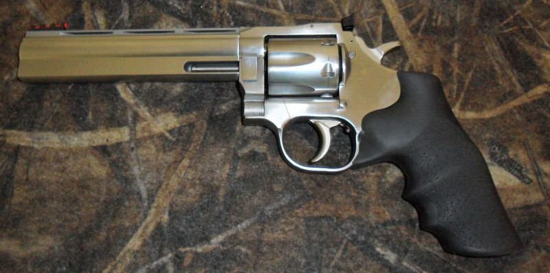

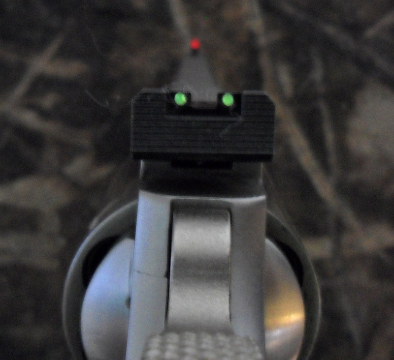

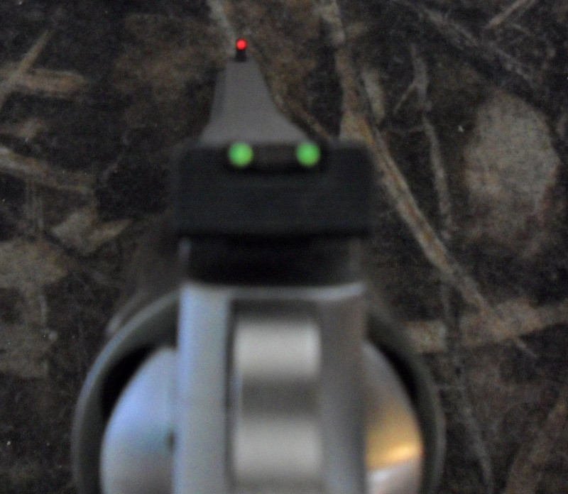

After much trouble, I finally got my Firesight installed. The previous owner had installed the wrong elevation screw(very hard steel)and it took my gunsmith a while to remove it without damaging the frame. He was persistent and did get it out, so here are pictures of the new sights. I don't know how they shoot, as I haven't been to the range since I installed it. Will update when I get to the range.DWL1.JPGImage Enlarger

Oh - I would really like this set-up.

Looks pretty good to me! I hope they work for you

The Williams firesight is for the Ruger GP100. It comes as a set with the front sight which is useless on a DW so you just have to eat it or give it to somone who has a GP100.
I installed this on my 15-2 with an 8” barrel and still using the DW front sight it tightened up my groups considerably. I was impressed. Very easy to see in low light. Now I just need to wait until EWK’s fiber front sights are available again so I can convert the whole sight system.
