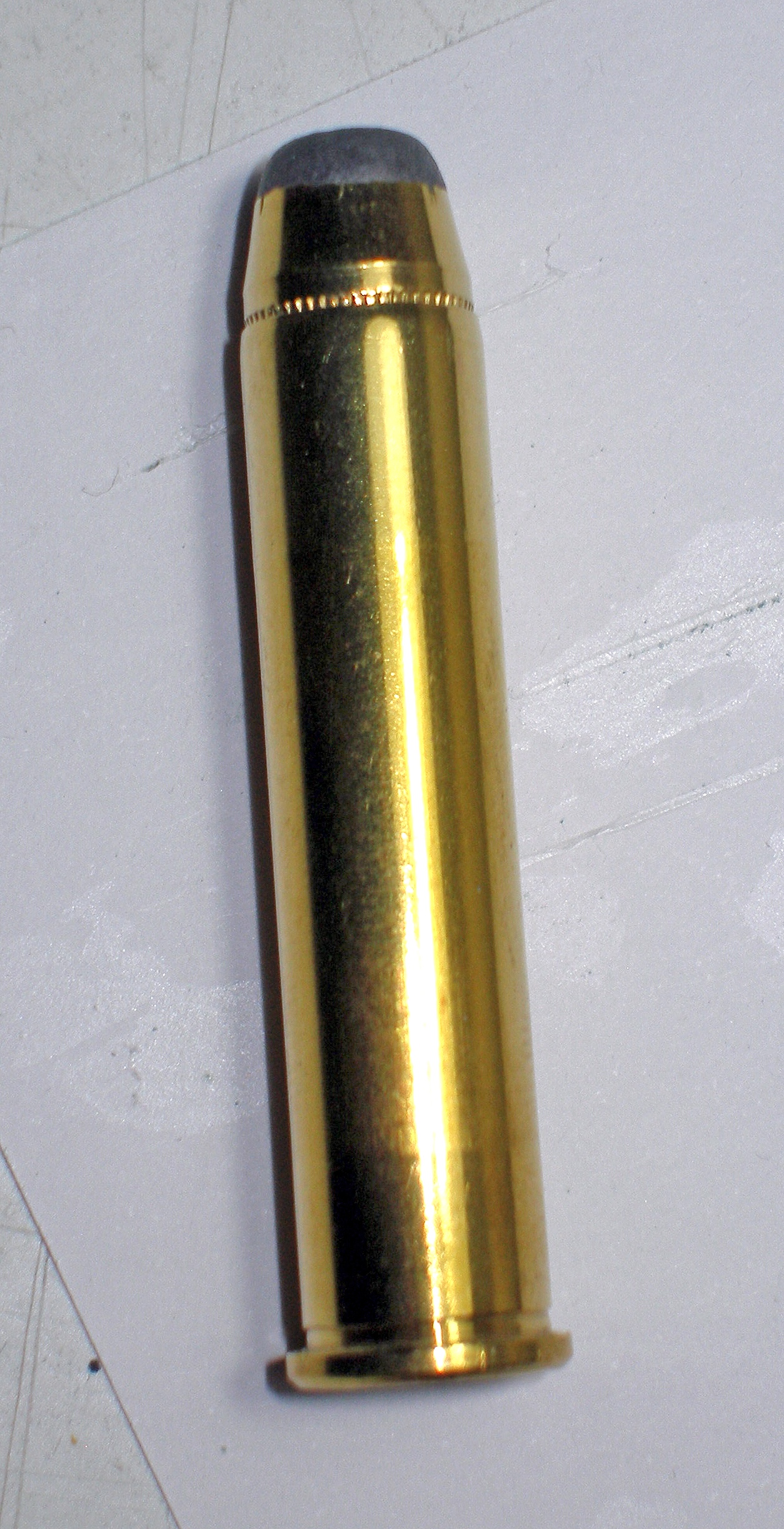

I bought this same ammo in 158 gr Max and have had no problems so far, But this is very disturbing and has me kind of worried now. I bought 4 boxes of this stuff last year and have only shot about a half of a box so far. This company needs to isolate the bad ammo and issue a recall immediately. Like I said, I have had no problems so far with the 158 gr. Maybe it is only the 180gr ammo that is loaded way too hot. Either way I would like to know for sure.
Here is a picture of what my ammo looks like. The bullet has a shiny jacket that matches the brass perfectly. It looks  different than your 180 gr bullet that appears more copper.The headstamp reads …R-P 357 REM MAX
357-max.jpgImage Enlarger

May I please recommend that you pull a bullet from each box before proceeding.
That round of yours does not look like the two different ones posted so far.  The bullet is different.
Wow, you have more cajones than me.  In 60 years of shooting, nothing has tweaked my melon like a blown up Ruger.  My shooting wasn't the same for several months, and I don't know if I will ever get my nerve back like it was.  Once bitten, twice shy.
I was the luckiest bastard on the planet that day.
You have two completely unrelated individuals telling you 25 grains of powder is too much of any powder for that round.
You have me posting pics of blown up guns.
You have the manufacturer stating he knew he had dangerous 357 Maximum ammo out there.
May I please recommend that you pull a bullet from each box before proceeding.  Measure the powder and please report to all of us.  I will try one more time to see what the manufacturer will tell me about lot numbers, powders used, bullets used, and distributors.
