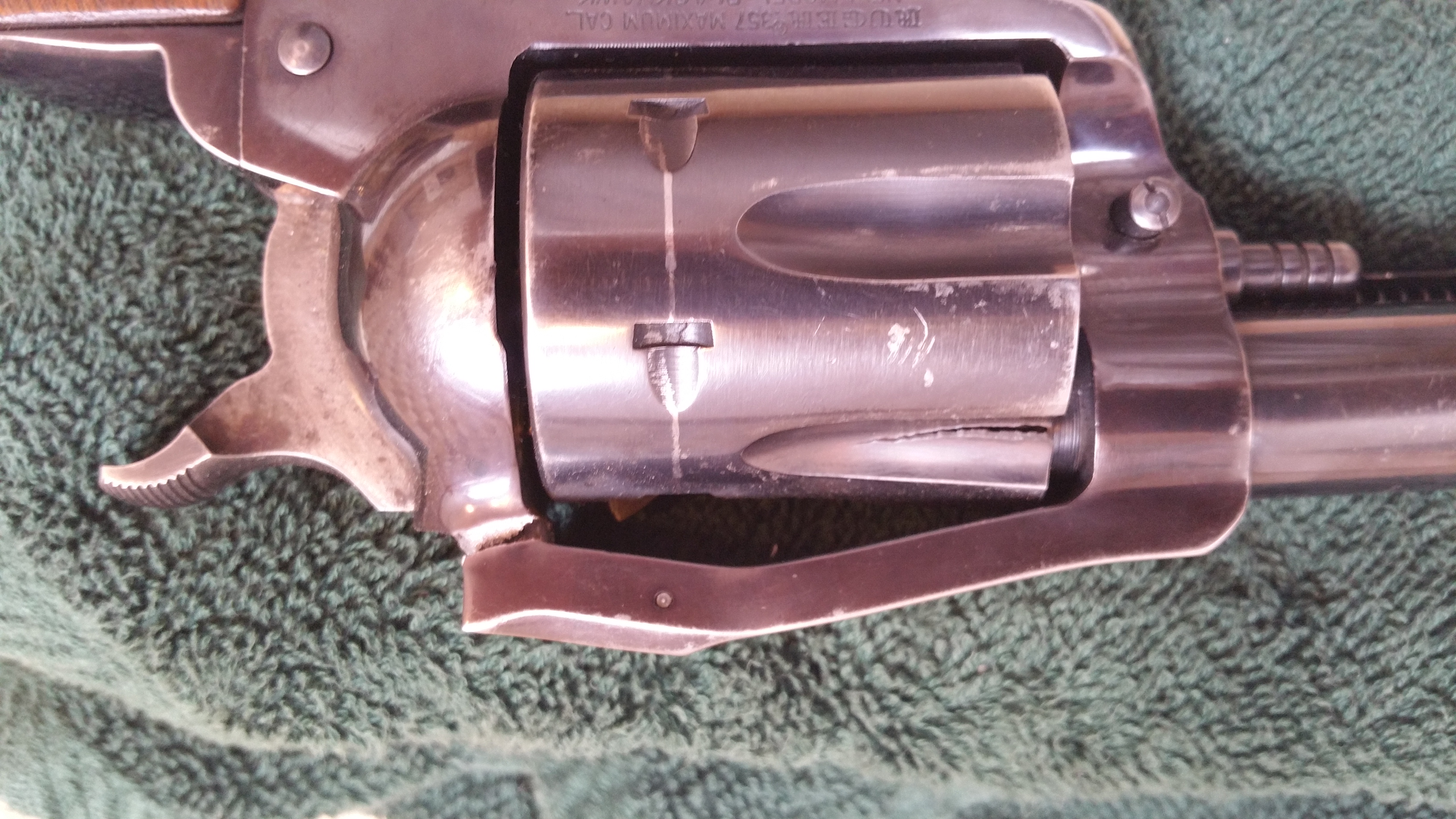

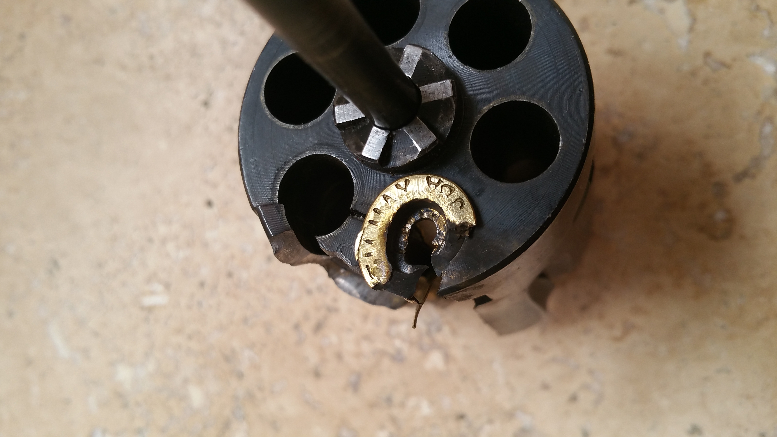

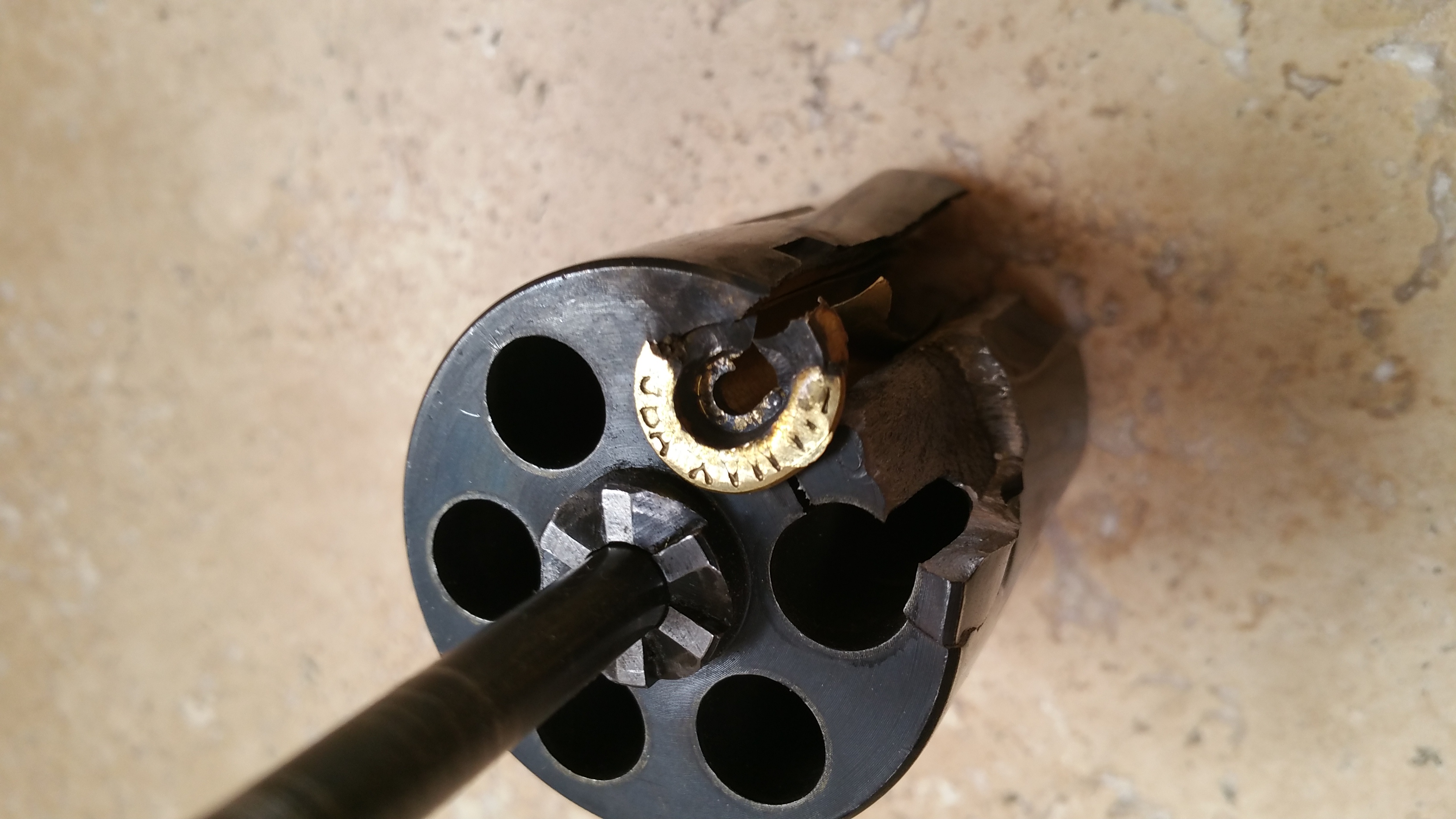

Some factory maximum ammo was severely over pressure specs.  Now, I have a stuck brass case in my DW 40 cylinder.  I tried punching it out and after much effort, I succeeded in pushing the last 1/4" of the brass out.  It tore the brass wall apart at that point.  I wouldn't have believed that was possible.  Now, there is no bottom to the brass case.  It looks like a liner to the cylinder.
Can I use a tap and die set to pull it out?  It seems like it would eat into the soft brass and get a little at a time.  Or does it need a .357 reamer at the blacksmith?
First time for me.  I would really appreciate any experience you might have.

If its wedged in there tight enough that you ripped the head off by tapping from the front with a dowel, it's gonna be tight, unless the broken case fractured form the actual firing prior to trying to extract it.
trying to use a tap in there likely won't work, because its still wedging the case tighter in the cylinder...
I'd try one method myself, before freaking out totally,
I'd take a larger size stainless bore brush (.41 or .44) on a strong handle, and shove it into the breach of the stuck case...
then quickly empty a can of compressed electronics "freeze" spray into the case from the front, freeze it good and immediately try to pull it from the rear... may take a couple tries...
but unless you can shrink that stuck case slightly, i doubt if any penetrant, even PB Blaster, will help..
find something like this...
http://www.mcmelectronics.com/browse/Freeze-Spray/0000000474
you have to work fast tho, and maybe warming the cylinder prior to freezing the case, will offer double advantage

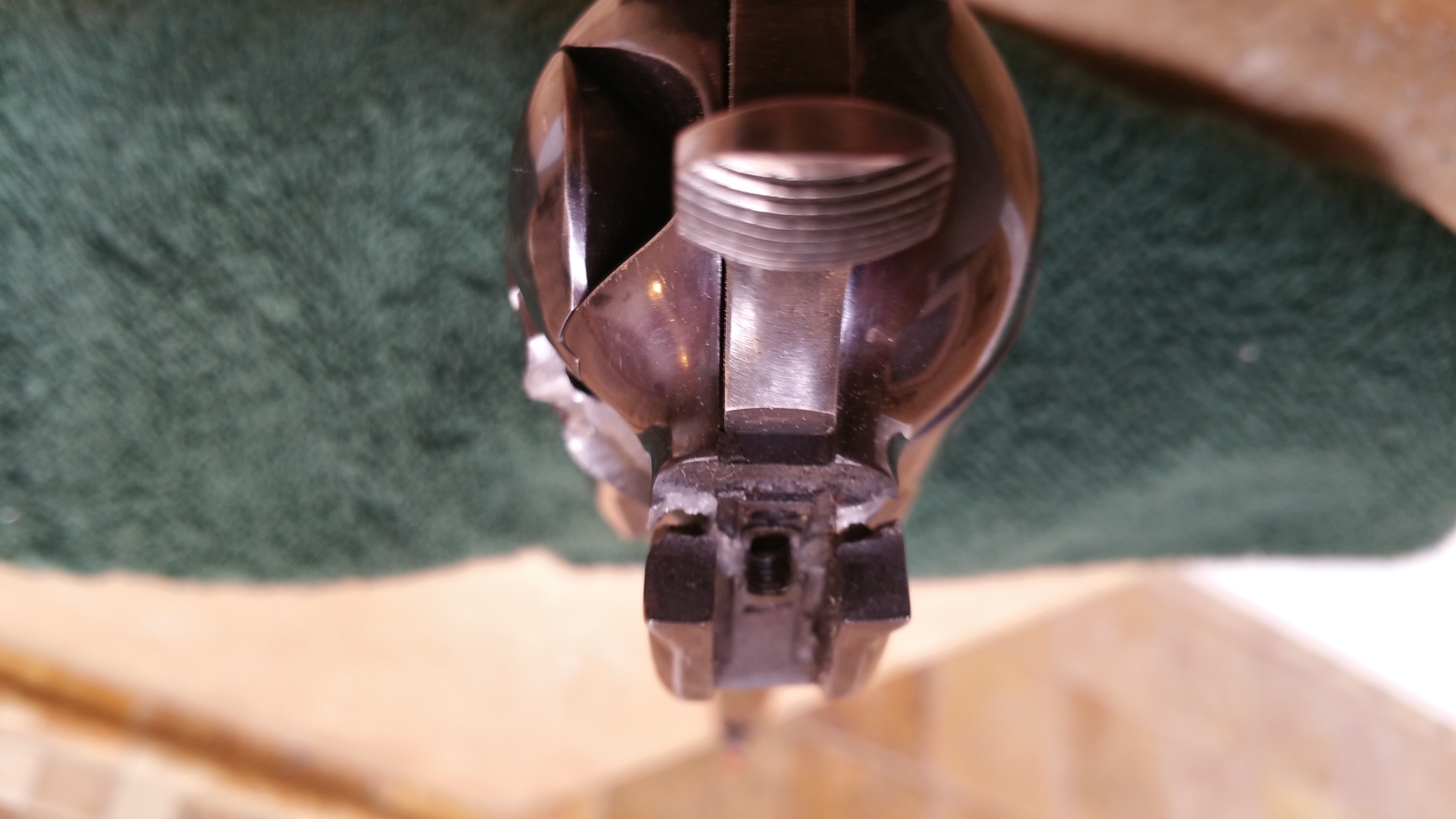

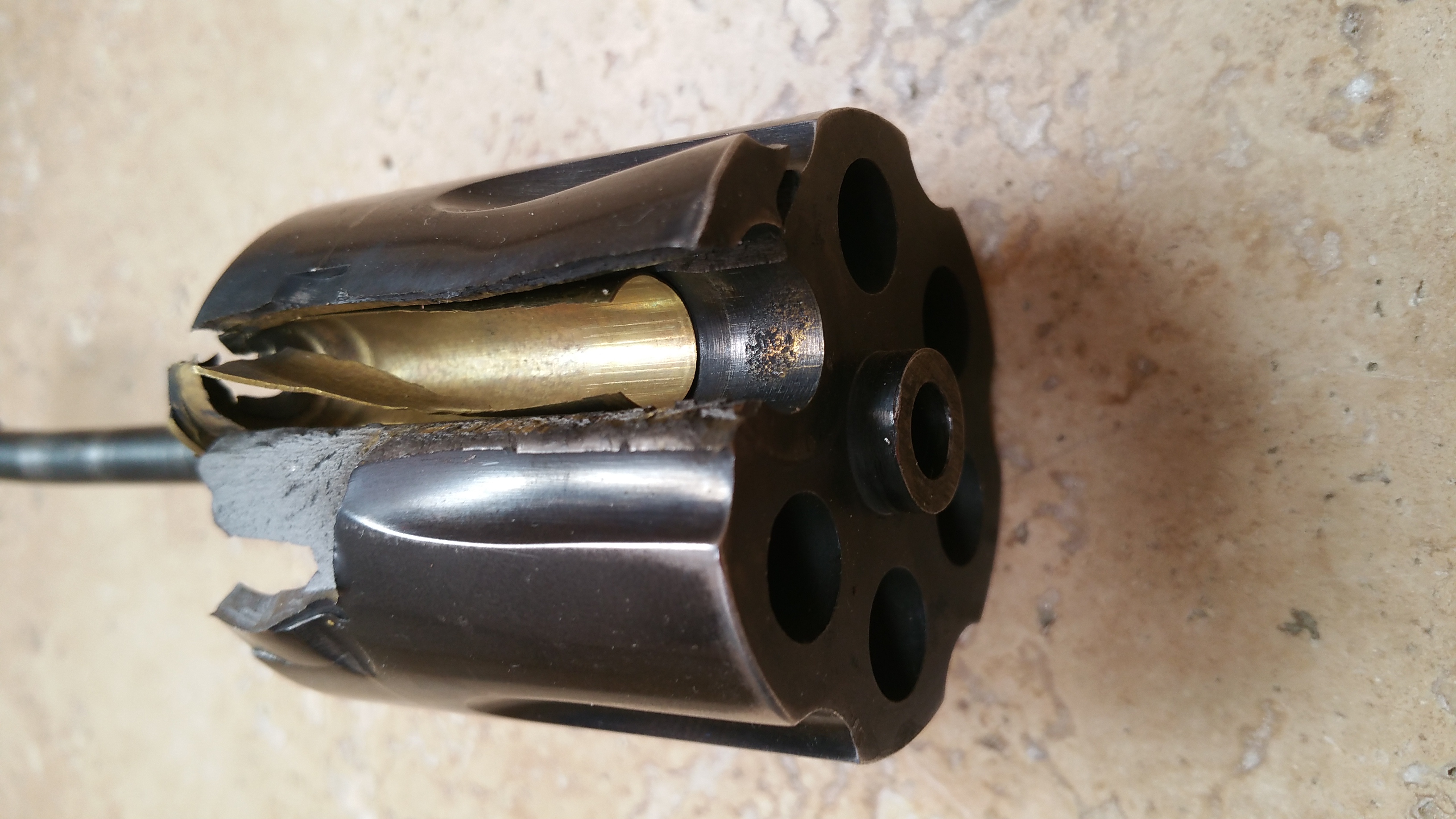

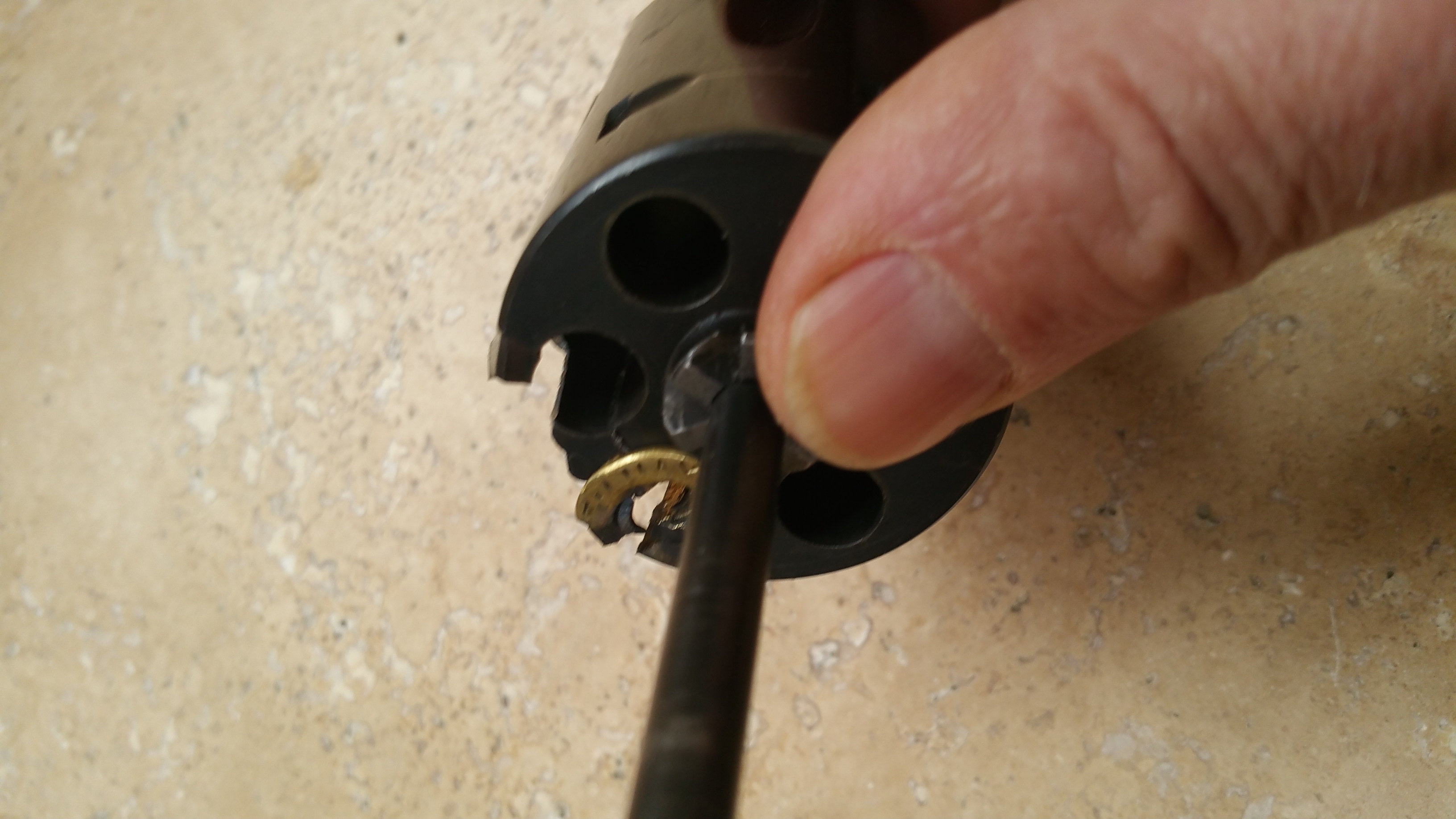

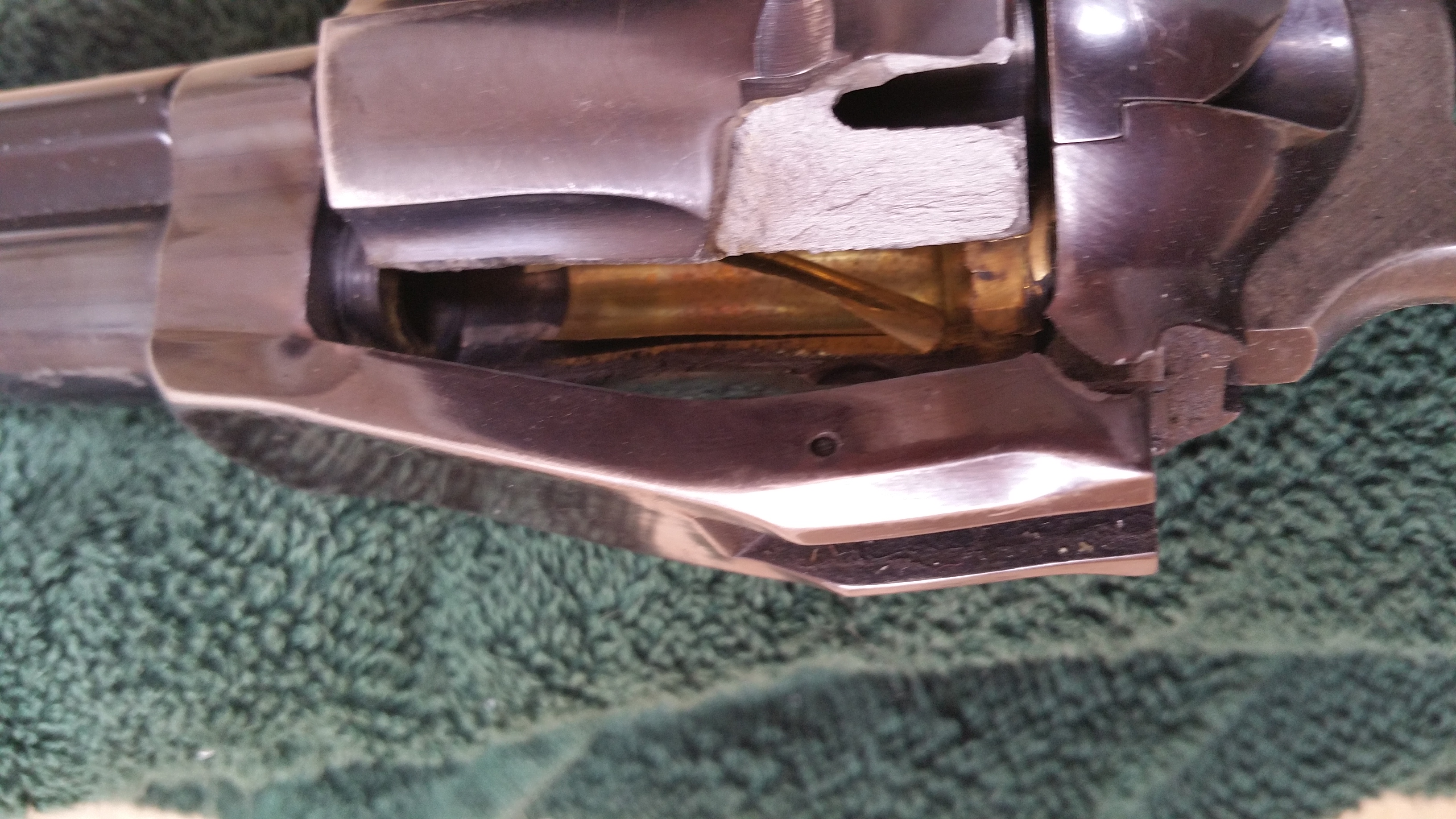

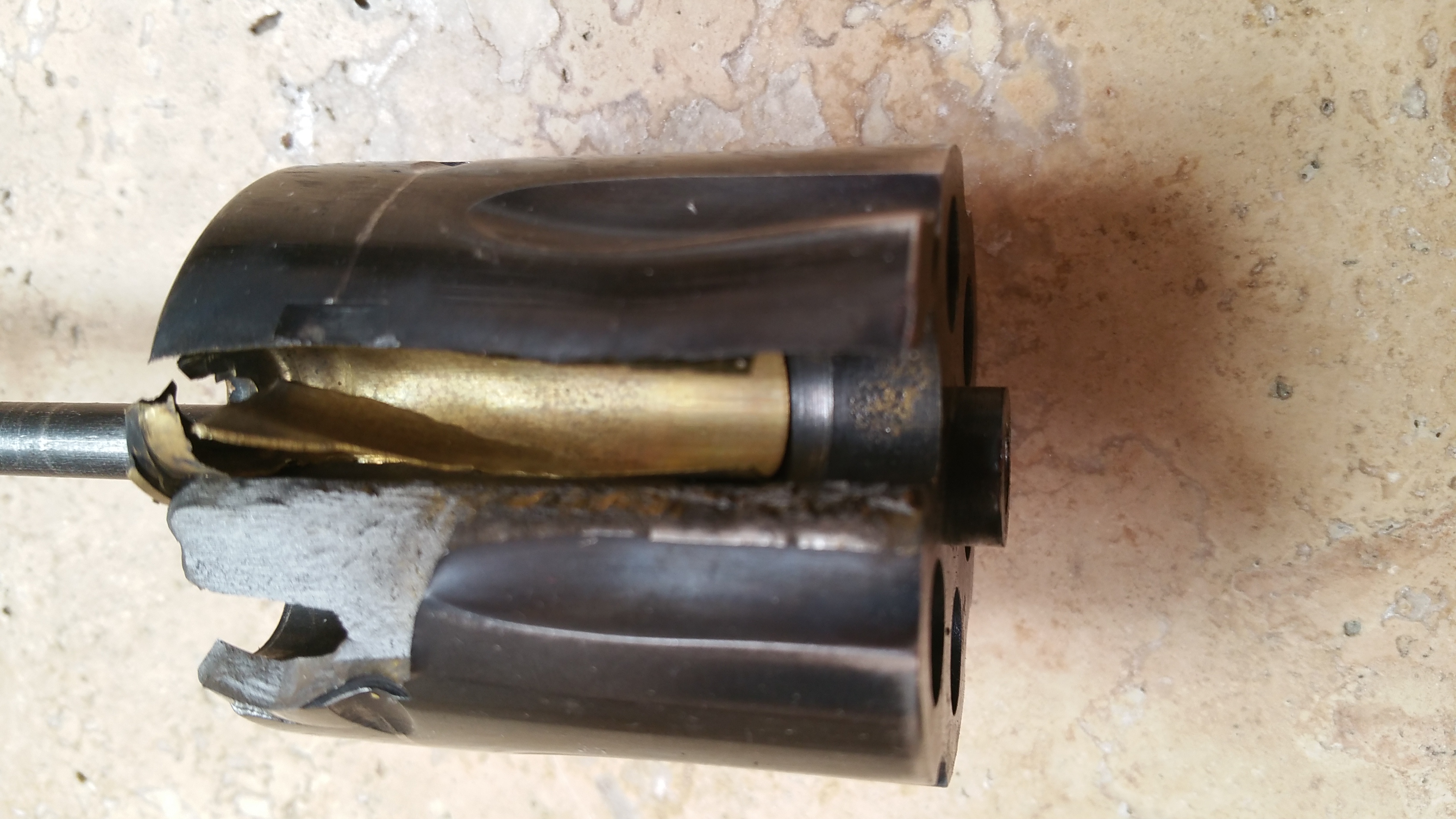

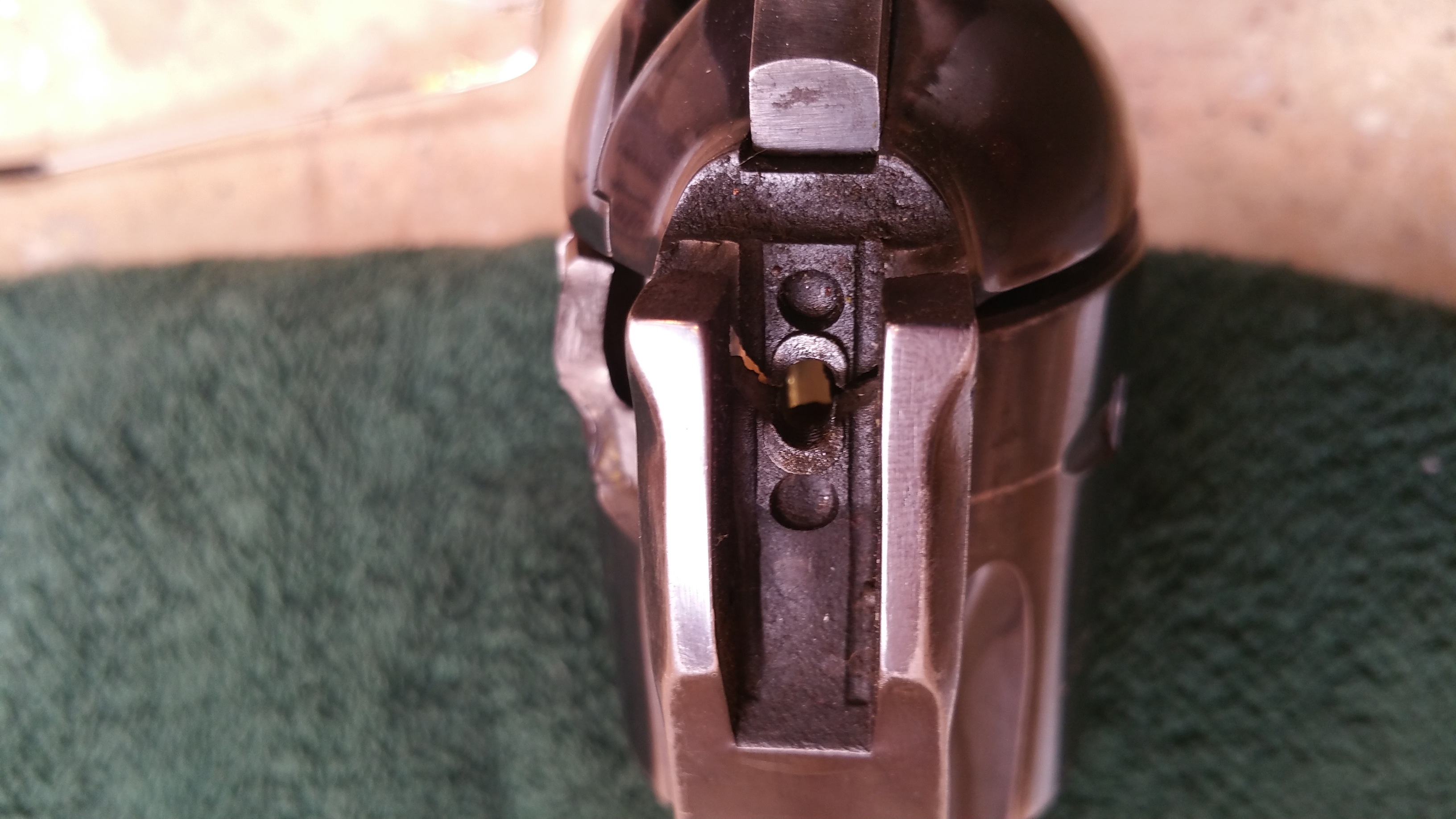

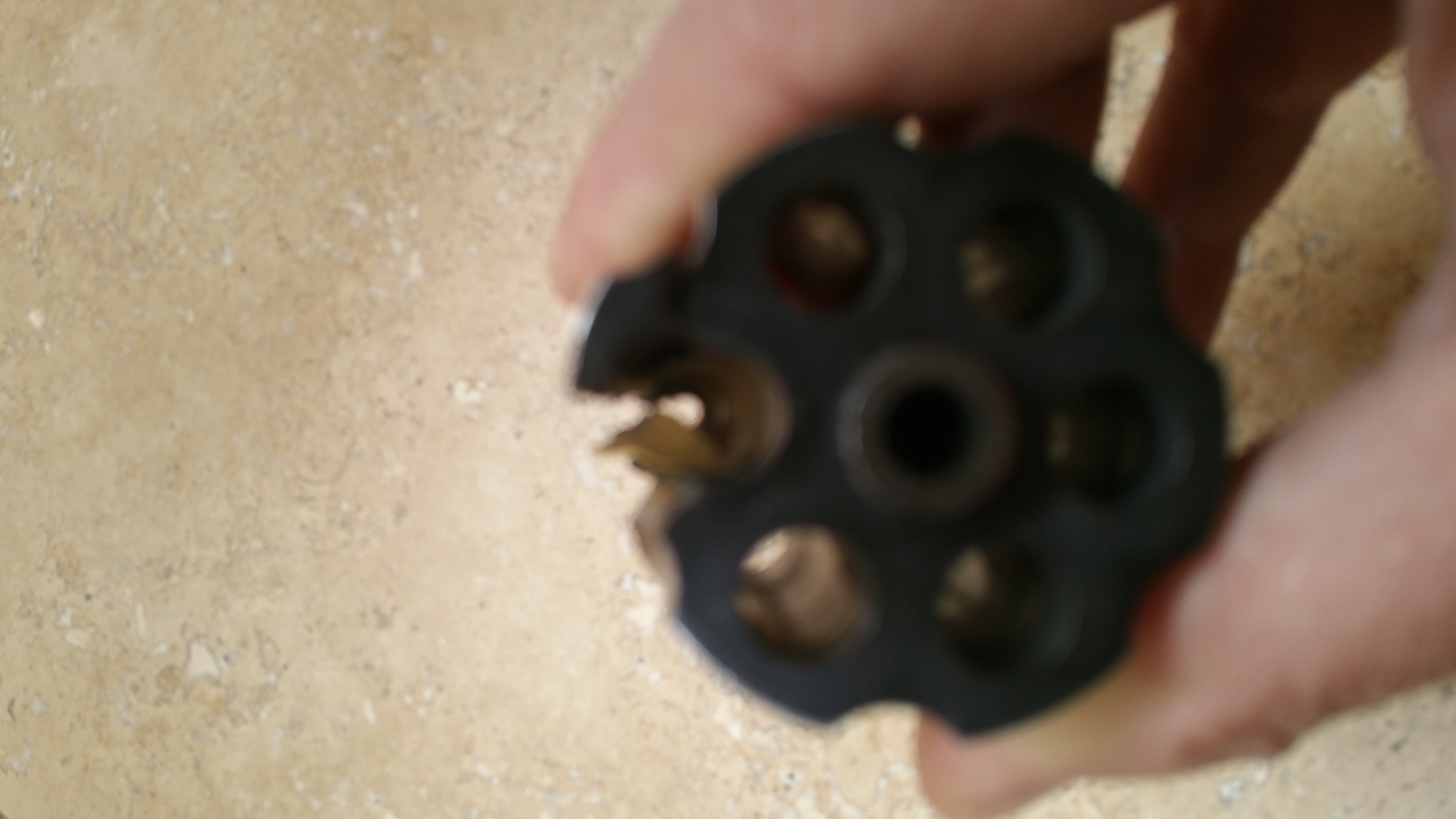

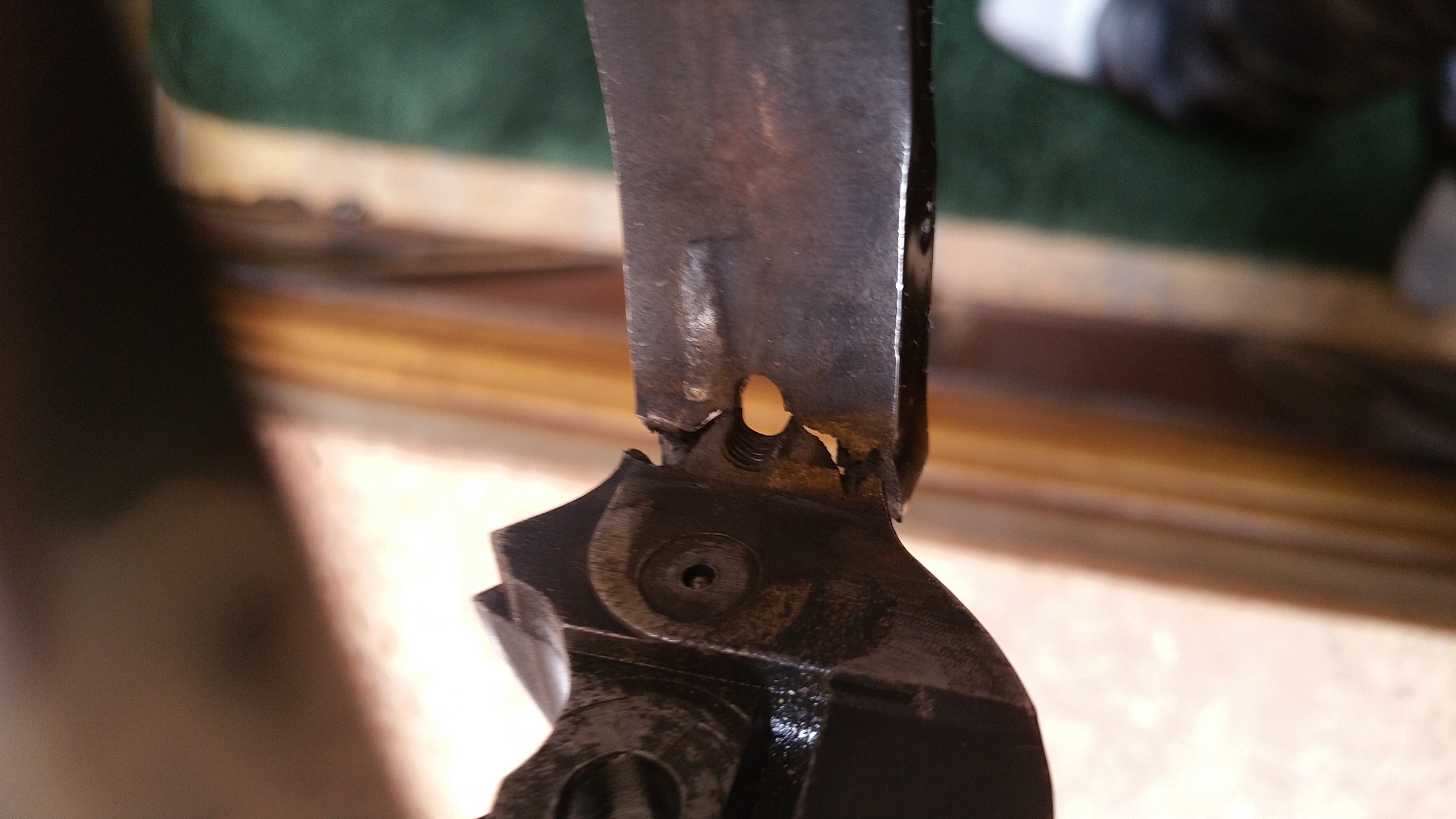

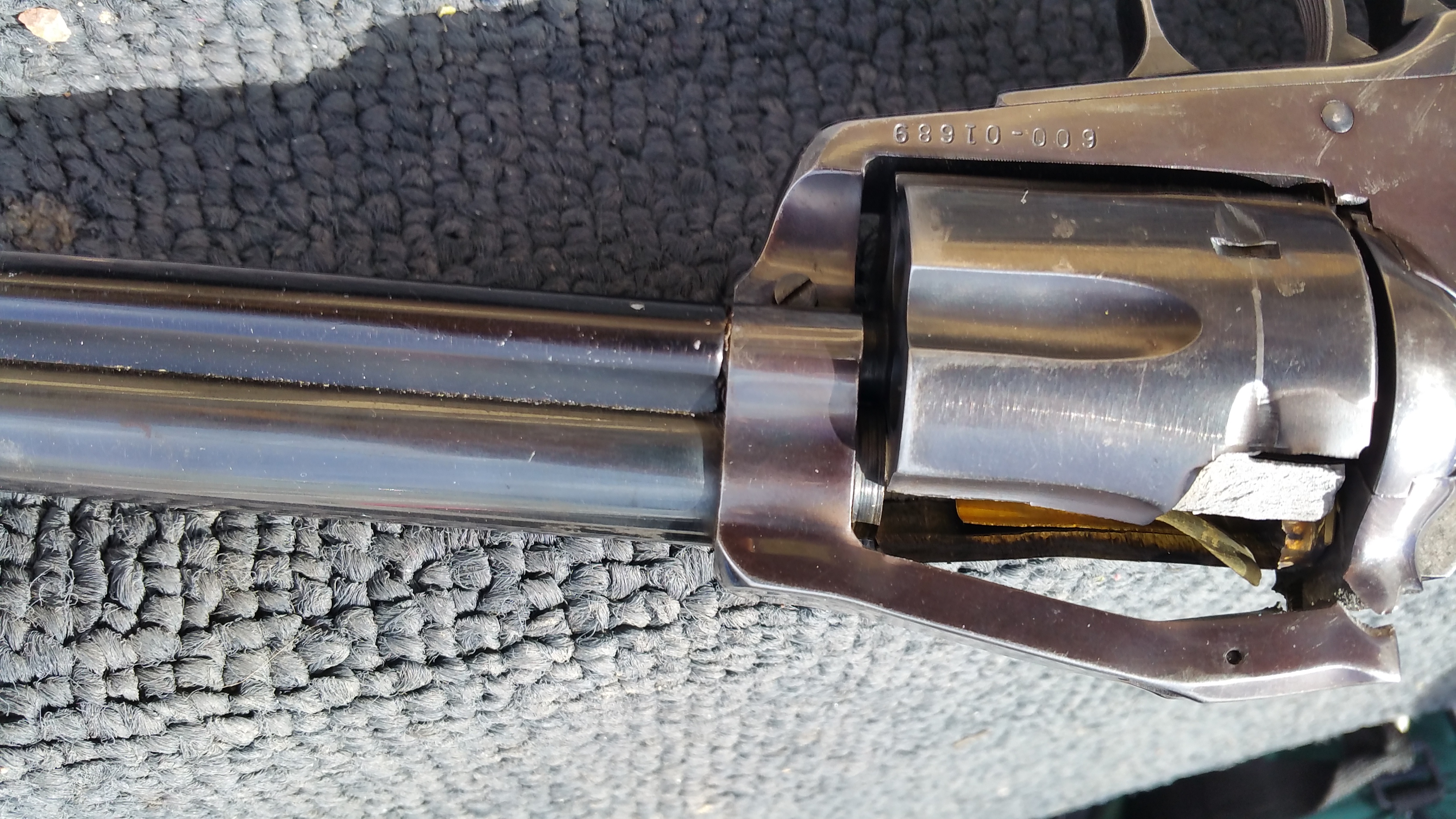

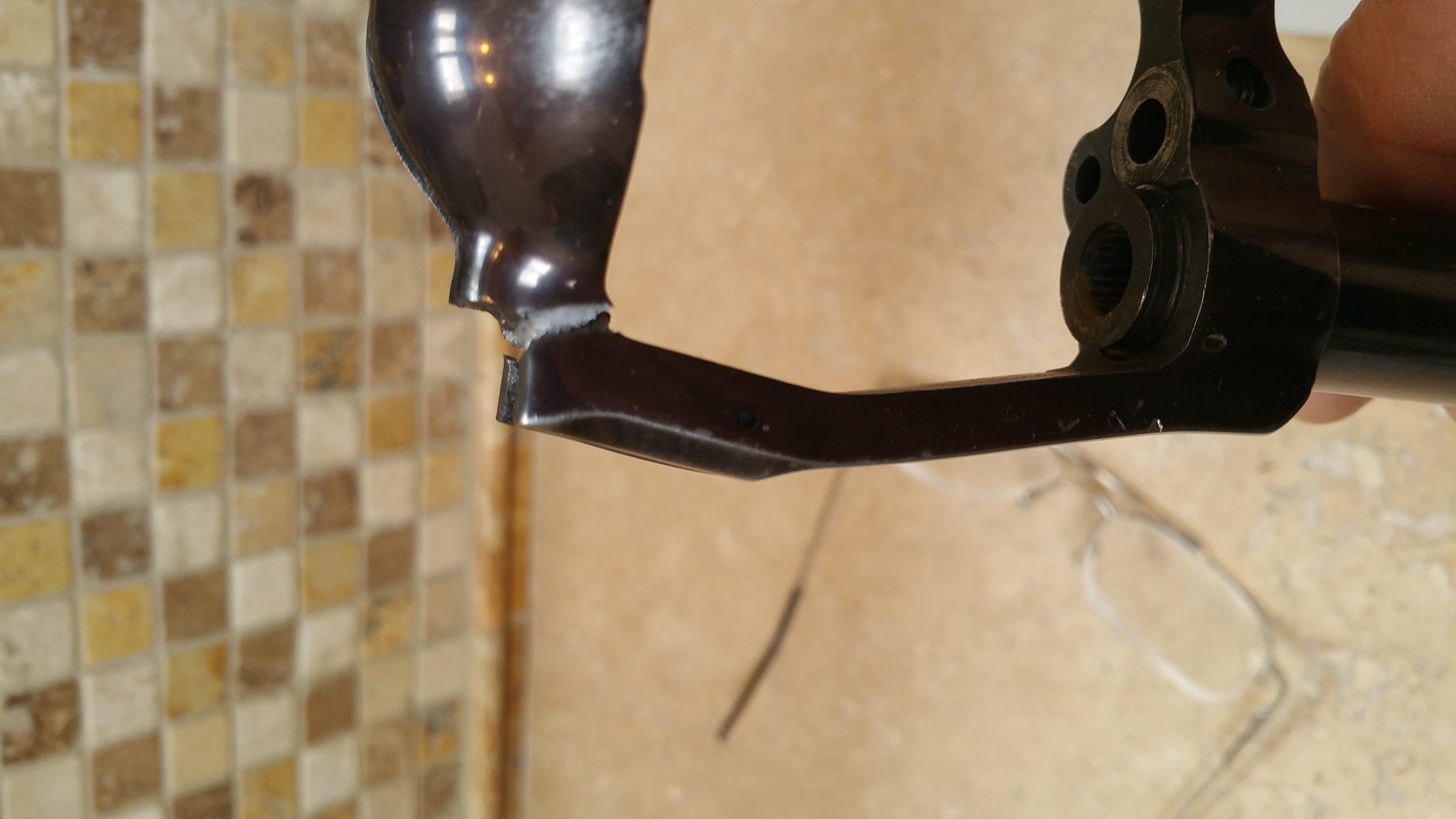

OK, guys, several weeks and several different techniques and the case is out.  I finally worked with an old gunsmith who soaked it in kroil and then made a punch that was curved like the inside of the cylinder hole.  He was barely able to tap a little on the end of the case each hit.  A small amount of the case would bend and then snap off and fall through.  After hundreds of taps, bends, and snaps; the case was out.  It was blown so hard against the walls that there were lines on the brass case from the manufacturing lines on the cylinder walls.
Discovered the following:
each of the cylinder holes are tapered toward the chamber.  Shells will not push in from that end.
hole 1  - .3825  -  .381                taper
hole 2  - .380    -  .380
             .381    -  .381
hole 3  -  .381+ -  .381
hole 4  -  .382   -  .381                taper
              .381   -  .381
hole 5  -  .382   -  .381                 taper
hole 6  -  .394   -  .393                 bulge and taper
              .397
              .402

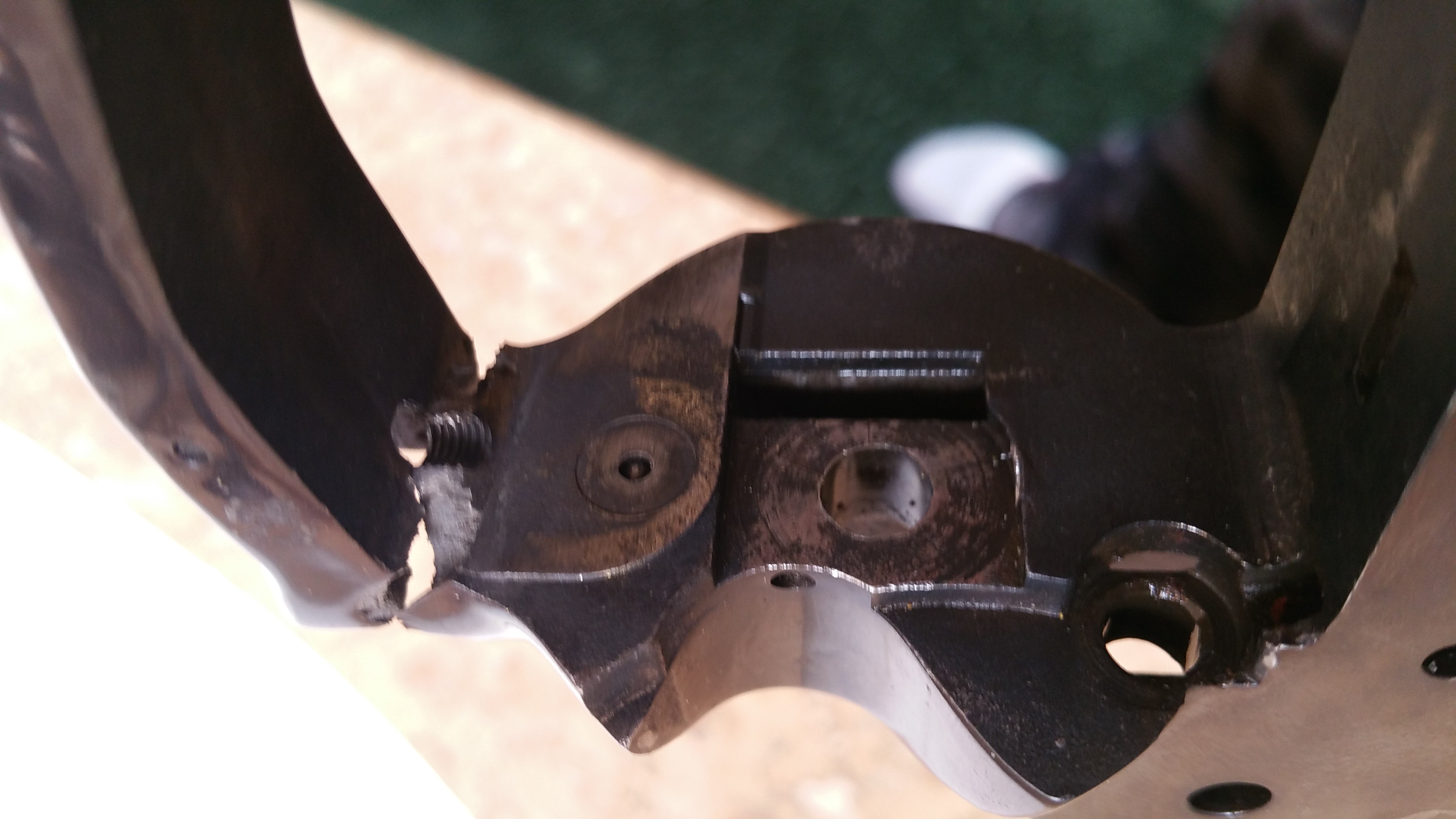

The cylinder rubs on the top strap when hole 6 is at the top.  It is possible to manually push past it, but a hammer pull will not do it.

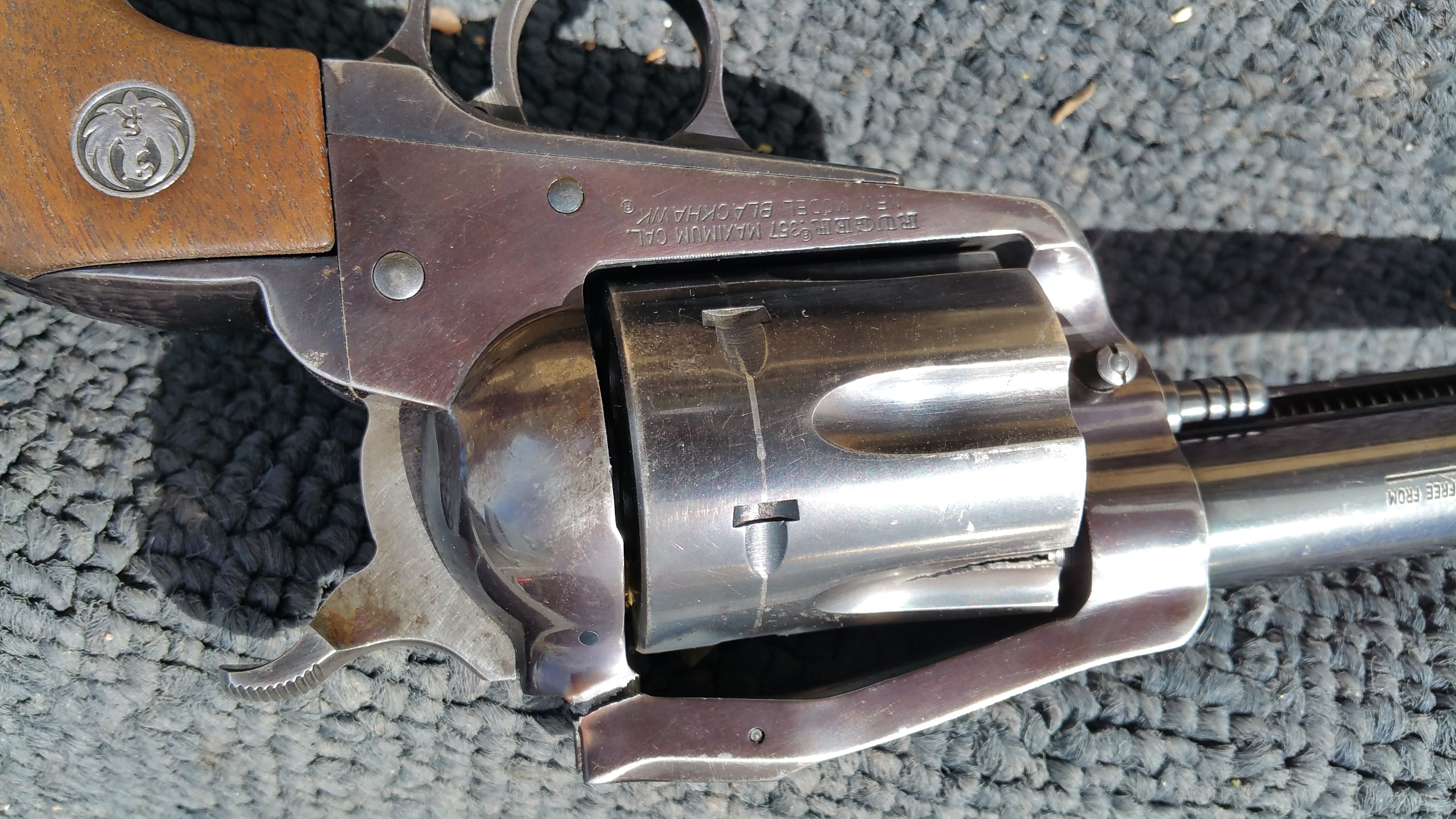

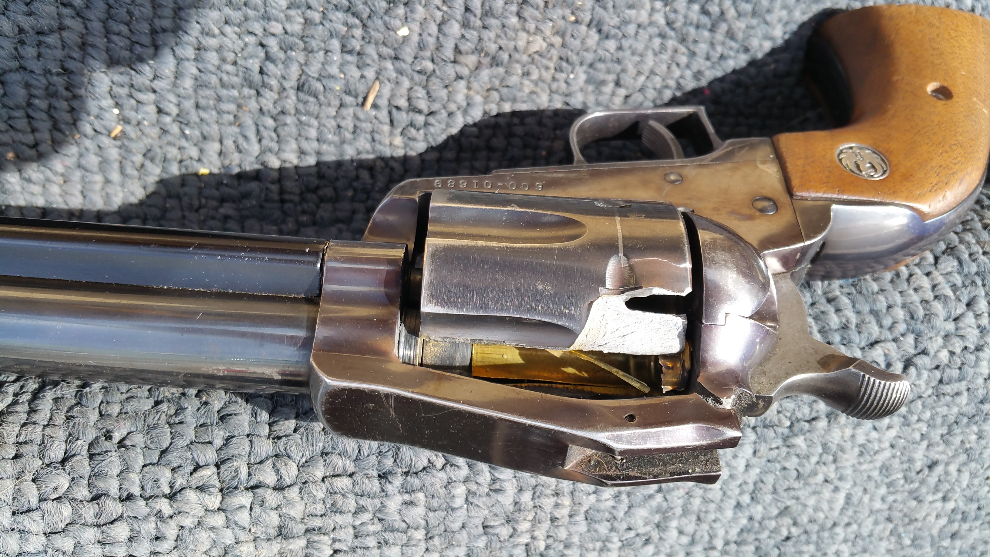

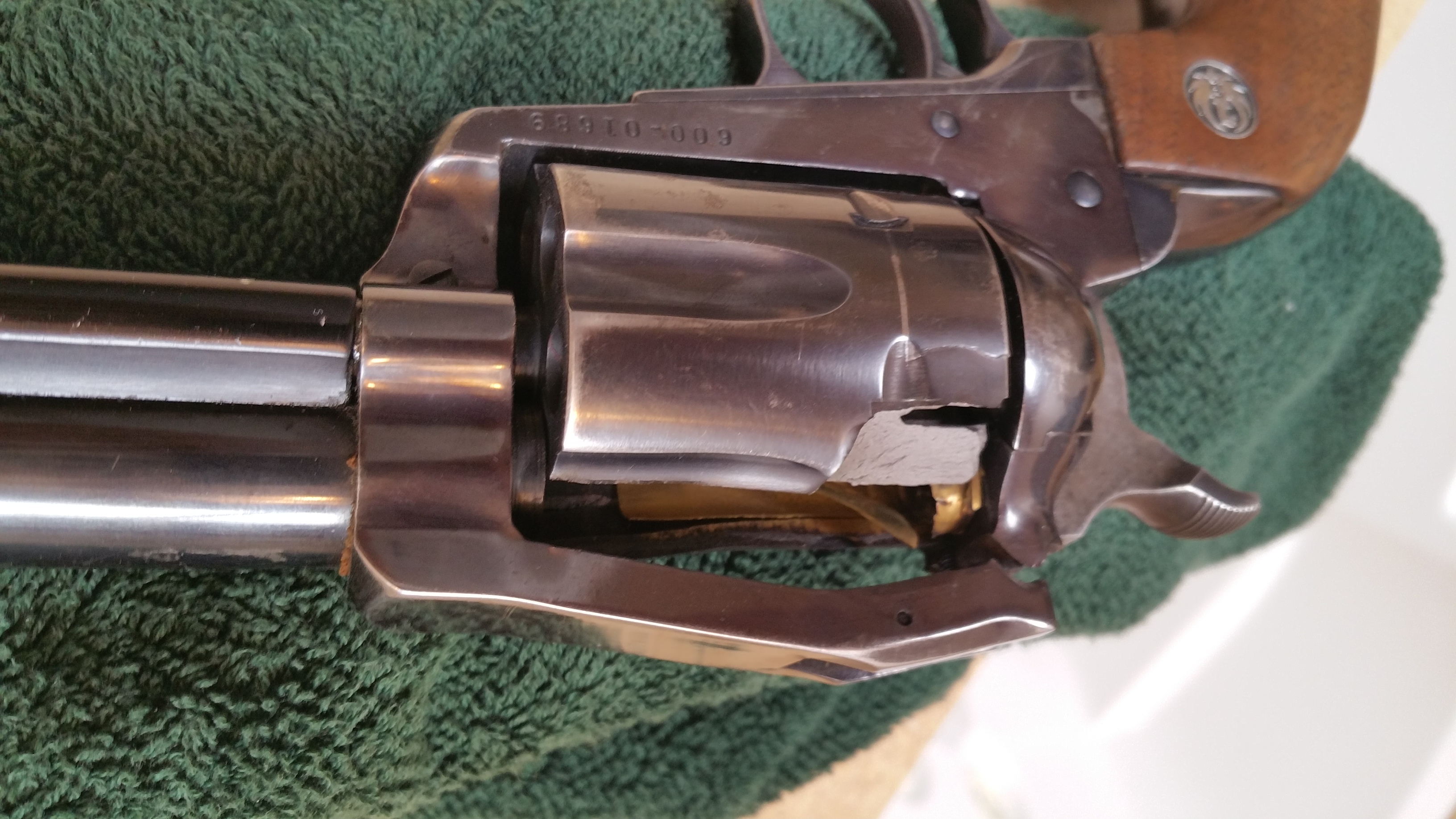

The Dan Wesson may be stronger than the Tank (Ruger Blackhawk).  My Ruger blew completely apart with the topstrap breaking away at the back sight (which disappeared).  The case in the Ruger was ruptured all along the side from one end to the other; which is what blew the topstrap off.  The Dan Wesson 40 only bulged the cylinder with the same ammo.
The way it happened:
After shooting one round in my brand new to me DW 40, I could not turn the cylinder.  I didn't think too much about it.  I thought it was another high primer, which I have gotten several of and reported on this forum.  I didn't notice anything different in the shot.  I put the DW down with my tools for later maintenance and kept shooting.  It was several hours later when I picked up the Ruger Max and shot one round.  It exploded.  There was no doubt that the ammo was the problem.  I first looked and thought Oh my Gawd, that dreaded flame cutting on the topstrap.  Nope it broke on the other end.  So much for topstrap flame cutting problems.  I got a sickening feeling in my stomach and walked over to the Dan Wesson 40.  I still had to look for a problem, but after trying to turn the cylinder, I knew it was there.  Same bad ammo, two guns gone.  One blew apart and one just bulged a little.
This is now beyond my skills and experience.  The DW barrel looks fine. The frame looks fine.  That is using eyeballs and no measuring tools.  I think I need an excellent gunsmith who has seen some blown revolvers and can say whether it's worth attempting.  I could just resell the parts minus the cylinder with a full story of events.  I might get back half my cash.  I just really hate to see a beautiful old Dan Wesson 40 SuperMag go to the dumpster.  The frame is in my favorite finish, bubba plum purple.  I got one shot before I killed her.  No matter what happened, I still feel like crap.

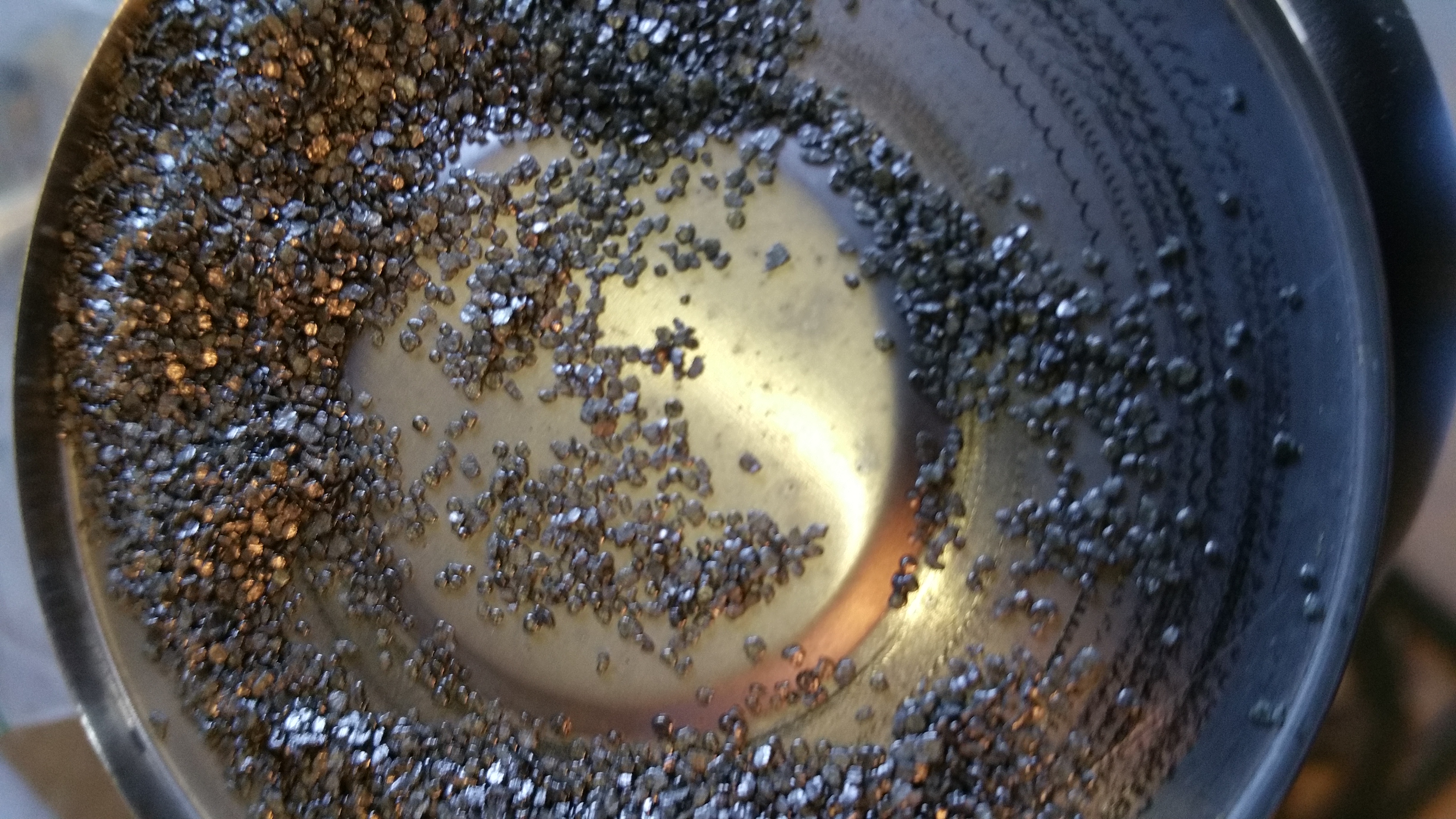

Do you still have some of the defective ammo ?
I believe it would be an interesting exercise to pull a bullet and measure the propellant and inspect it to try and identify it from grain appearance.
Prescut
the southwest and the free state of AZ
Forum Posts: 99
December 19, 2015
May 18, 2016 - 2:57 pm

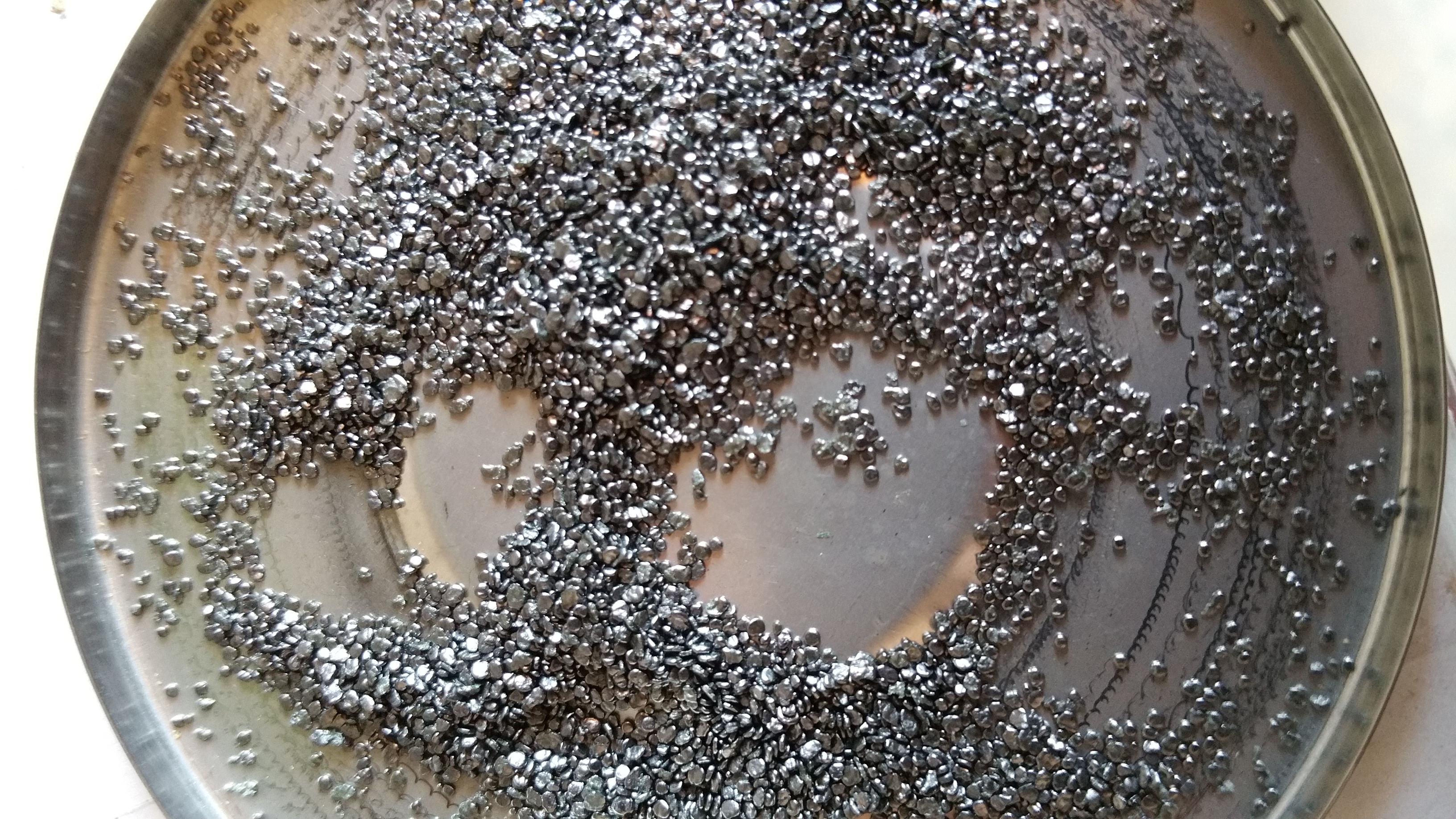

I did pull a few bullets almost immediately. I found I believe flake powder that was so heavily compressed that I had to dig it out of the case to weigh it - approx 24g. The vendor is not telling what kind of powder. I was surprised that the granules seems to stick together as if moist.
The primers were merged with the brass casing absolutely flat. Without color difference, it was hard to tell the two apart.
pics to follow including powder
Prescut
Forum Posts: 99
December 19, 2015
May 19, 2016 - 12:27 pm
now for the pics
