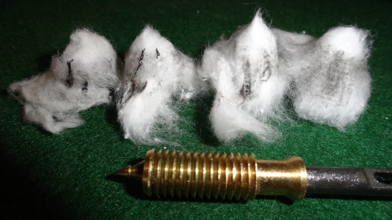

What's old is new....  I've been running low on cleaning patches for a while, went to cutting up a box of cotton rags, started using old t-shirts, socks, etc.  Contemplated going to Goodwill to purchase or ask for more tshirts/ cotton shirts.  Then last weekend, as I was reading up on BPCR loading for my new to me 45-70, I decided to peruse the chapter on cleaning.  Lo and behold, from out of the pages of a book written in the 40s, came the best, most cost effective, effective solution to my conundrum:
DSC01493.JPGImage Enlarger
Yep, those are tufts from cotton balls, lifted from the wife's cosmetic bag.  Seems the old timers (older than me) used cotton balls for superior cleaning of their rifles' bore.  Seems the unidirectional strands offer better durability than the flannel patches of the time.  So, I decided to give it a try.  You can get three 41 cal tufts out of one cotton ball and they strip the fouling and lead right out.  No more buying patches or cutting cotton shirts.  Thought you should know, in case you didn't.  Maybe I'm the late comer; who knows?
46
May 10, 2015 - 11:39 am
Great Idea. I thought of it before, but then didn't use them because I was afraid they would leave lint or strands behind.  That seemed like more of a job. Guess I should have given them a whirl. Thanks for going out the limb brother, this could be a plus for us all.
