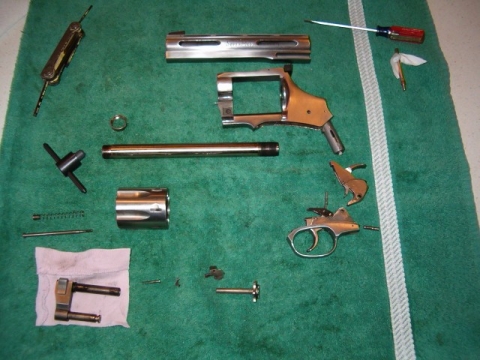

Ok, here's what I do with each used DW I bring home...cleaning after each range trip isn't quite as in-depth, but it's close.Wink
This is my 7445 during it's first 24 hours at home.Wink
HPIM2631.JPGImage Enlarger
My post-range day cleaning ritual goes like this;
1) make sure it's unloaded.
2) remove the grip...I'd rather not find out the hard way if any gun cleaning solvents will damage the grip surface.Embarassed
I'm running out of posting time tonight, so I'll be back later to edit this & add more...LaughRange TimeWhipping

September 21, 2010 - 8:52 am
wow man, thanks for the pics. do you need any special tools to take em apart like that?  thanks.

September 21, 2010 - 12:32 pm
No, allen wrench and a flat blade screwdriver is all you need

It's not as bad as an automatic transmission lol2  Looks more than it really is.
If you look at CF's first pic, take out the barrel stuff, the crane/yoke and the
side plate, your really only dealing with a half dozen or so parts.
Shake off the jitters and get in there, you'll be glad you did.

Blacktop's right though, DW's are actually pretty simple inside. 10 time more simple to take apart than a Smith! WOW And this barrel isn't even unscrewed yet!Screwy
Smiff 18-3 for example...
