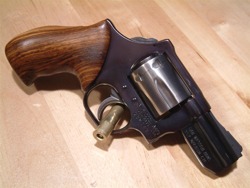

Well, it is about as finished as it is going to get...  Set off all rounds in my test gun just fine.  I gave it a quick polish and blue (hammer is hard--doesn't like reblue), and put the hammer and matching trigger into my CCW DW.  For some more testing, I have left the factory springs in place.  I think it looks pretty good....

SHOOT, nice work!  Makes me want one like that now!

Wow.. that did turn out well. Well, now that we know it can be done.. I might just start looking of for a spare hammer!

Nice job SHOOT ! occasion   Now you have to change your signature rofl

Hmmm I have a couple spare hammers may be my snow day project!  Nice looking Shoot!  Cool Picsoccasion

That turned out looking pretty slick, nice work!Smile

So how did this turn out when shooting?  Were there any problems firing the gun?  Inquiring minds (who just bought a gun with a bobbed hammer) want to know.

I have another thread on here somewhere, but bottom line is it shot fine.  Don't forget though--I personally went over this entire revolver and slicked up the entire action, changed springs, etc.

SHOOTIST357 said:
Well, it is about as finished as it is going to get…  Set off all rounds in my test gun just fine.  I gave it a quick polish and blue (hammer is hard–doesn't like reblue), and put the hammer and matching trigger into my CCW DW.  For some more testing, I have left the factory springs in place.  I think it looks pretty good….
Looking at this picture I have a question or two. 1. What model is this
the 14-2?   2. Did you have to modify the pistol grip and grip frame
any? 3. The cylinder looks different. Is it just un-blued? The pistol
really looks great.
33
December 6, 2011 - 11:01 am
really looks great.
Wow--Sorry I never saw this post until now...  This is/was a stock 14-2.  The grip frame is stock, but the gun now wears a set of LB SHOOTIST grips.  I installed the Stainless cylinder  to give it a little sexier look.
It runs just fine with the bobbed hammer, but I also went over every inch of the gun when I had it apart--tuned and lubed.
