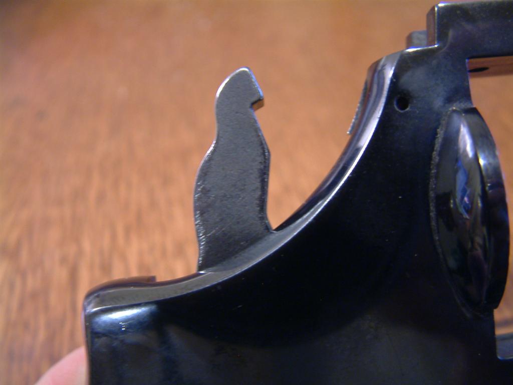

Well, I think I'm going to go for it–worst case scenario I destroy a hammer… Here's a 30 second photo edit…I'm gonna lose a lot of mass….
I have to go out of town this weekend, but when i get back I'll break out the dremel  !!!

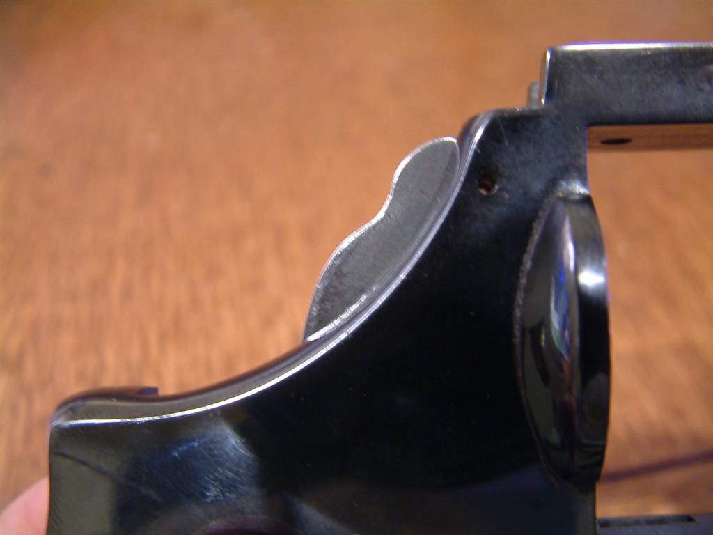

The initial cut... Confused... I'll do some grinding on it next to blend the back to the frame as best I can.
Should be a fun project... If it fires reliably, I'll give it a super tune this winter.  I'm in the market for a beater 14-2 or 714.  I want to "melt" it (remove all the corners/sharp edges) and come up with the perfect DW carry gun.

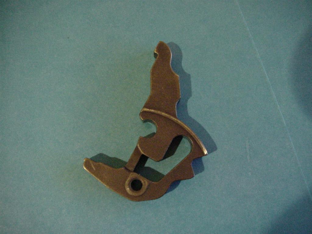

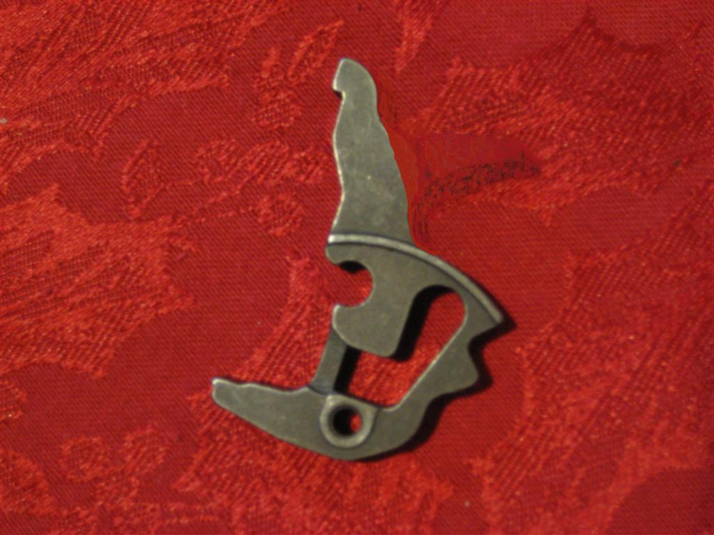

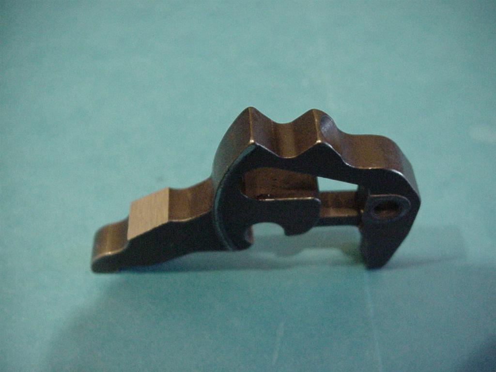

I'll call her the "Humpback" DW Big Grin....
Did some initial cutting on the hammer today and this is how she ended up--I still need to do some minor contour work and then final polishing before the Blue.
The stock hammer is 573.6 grains; the new bobbed hammer is currently 492 grains.  Loss of 81.6 grains.  Only some range testing will tell if we have a winner or not.  More to come...
