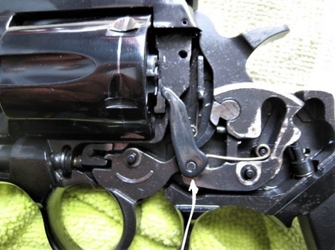

Thanks, but the first thing I tried was removing the grip screw and it made no difference. My wording is probably incorrect, but it feels like some part of the DA mechanism is hanging up/not allowing the hammer to complete it's last part of it's travel and drop. I haven't had the gun completely apart yet but there are a few places like this that are scratched from wear. I think I could handle the average Joe tune up I watched although I haven't had the guts yet to go that far.
September 5, 2019 - 5:39 am
Rarely will anything 'hang up' in a revolver unless something broke.  It's usually a case of improperly placed springs, other parts not installed correctly, cleaning, or loose side plate screws. Go ahead and knock out the AJT- if you get stuck there's folks on here to help you out.

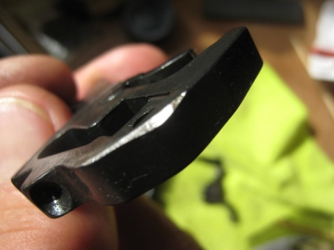

First my thanks to shootist for AJT thread. Total disassembly was much easier than I thought it would be. My trigger issue may be caused by some excessive wear/rubbing on the right side at the bottom of the hammer. I found the spot on the frame it appears to be rubbing against. I dragged a fine stone across roughest part of the hammer a couple times to smooth the edge a little and then used Mothers mag polish to slick it up. The hammer was pretty much how you see it now since I barely touched it with the stone. I polished the top of the machining marks on the frame in the area the hammer travels and gave it a deep cleaning. I put a Wolff "competition" trigger return spring in also. It's improved some but the issue is still there and I suspect the wear on the bottom of the hammer is causing it. If I pull DA very slowly the issue is obvious. If I pull DA more quickly it's not very noticeable most times. Is the hammer a drop in part or does it need to be fitted? I was afraid to get too aggressive with stoning the hammer to smooth up the worn/gauged spot. Do you think I could stone that edge smoother or would it lead to problems?IMG_0306.JPGImage Enlarger
IMG_0313-2_LI.jpgImage Enlarger
September 5, 2019 - 1:14 pm
It's a drop-in part. I would stone it and smooth it til it cures the problem. Note that it may not be the only place needing smoothing.
