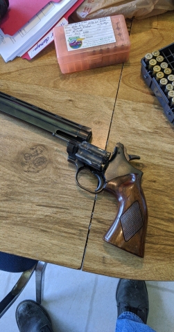

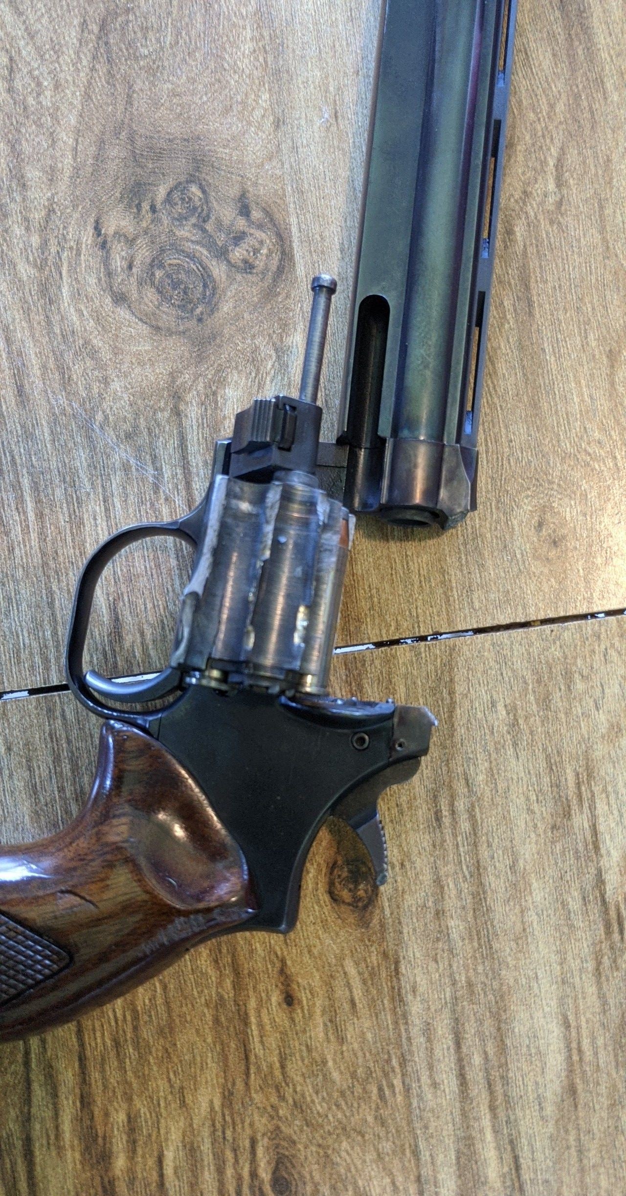

Only a small cut on my left knuckle.
Load was (supposed to be) 9gr HS-6 Sierra 158 JHP 8360, Rem 5 1/2.
Only other note was that the top strap had been drilled and tapped with a 6-40 thread for a scope mount.
Forensics to follow.
IMG_20240511_140343_01.jpgImage Enlarger
IMG_20240511_140346_01.jpgImage Enlarger

Glad you are OK. WOW!
May 11, 2024 - 3:37 pm
Talk about big surprises!
Glad you are OK.
Forum Posts: 670
October 17, 2017
May 11, 2024 - 4:23 pm
Very good to know that you suffered only a minor injury. This is usually the case from what I’ve read about these kinds of failures. Still, count your blessings! Do let us know what you’re able to find out forensically. This photo gives me the ebeegeebies.

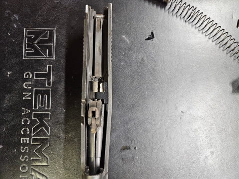

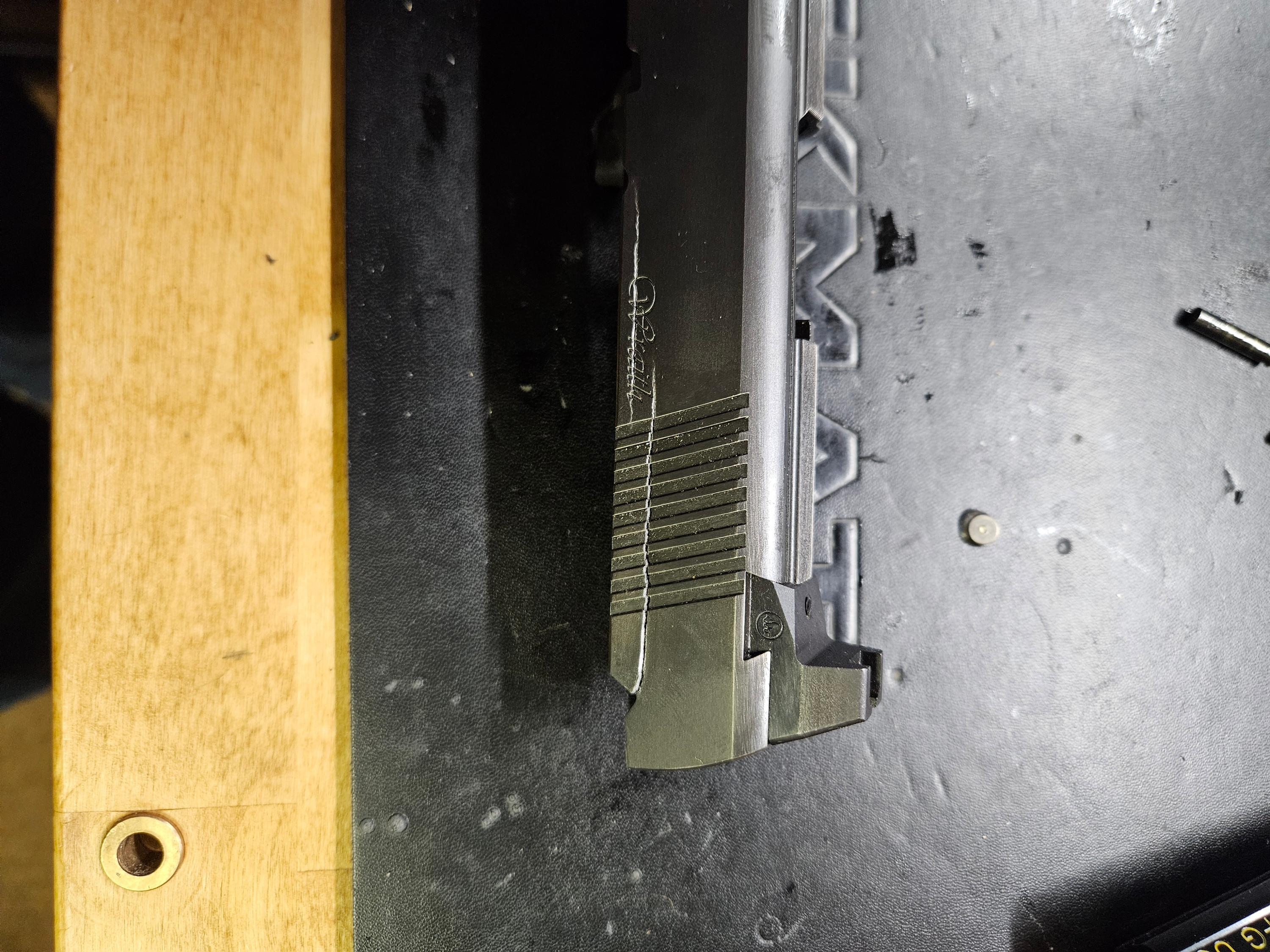

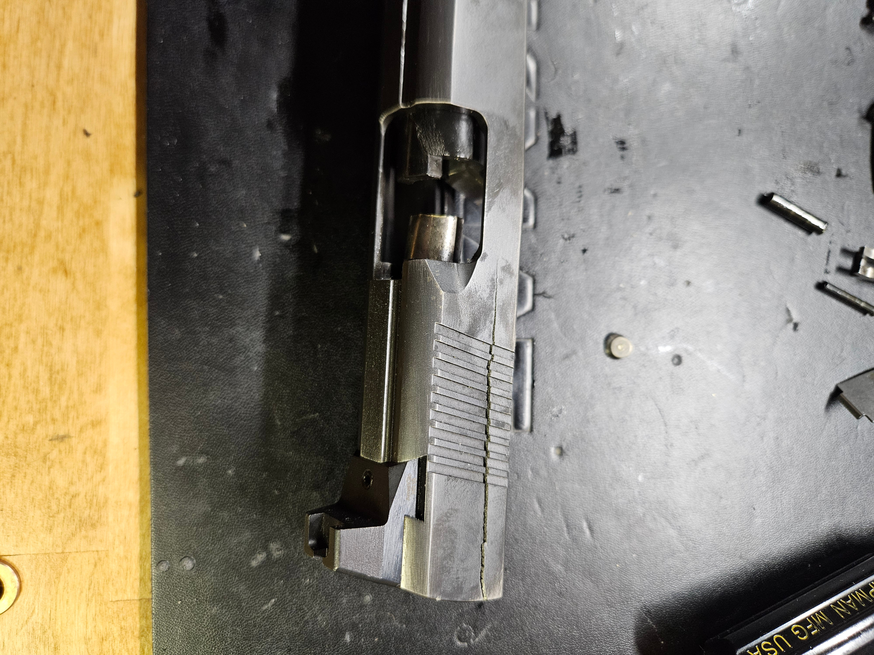

This happened to me last week with an unknown supercharged 10mm.
20240504_080338.jpgImage Enlarger
20240504_082339.jpgImage Enlarger
20240504_082347.jpgImage Enlarger
Split the barrel in half! Glad the remaining rounds in the mag didn't ignite. A small lapse in diligence at the press cost me several $K's, and some dirty underwear. LOL

Holy 'chit! wow For a 15-2 to blow apart that bad, there was definitely something major going on. I assume there is no squib in the barrel, or you would have mentioned it?
Glad both you guys are okay!
Forum Posts: 1285
May 11, 2024 - 11:51 pm
Wait so the shell blew up in the cylinder and that blew off the top strap? That crazy sounds like something bad done in the reloading process? I never seen a cylinder blown apart like that!

Just google  “blown up revolvers”, there are many photos similar to Wbrco’s shown there. Depending on how bad the over pressure was (regardless of the cause) there are many variations. Sometimes the top strap is bulged up a little, or a lot. Sometimes it’s missing altogether, but in almost all instances the cylinder is blown apart. Weakest link? I think when the cylinder fails it becomes a “grenade” under the top strap.

Update:
Finally had time today. As soon as I went to zero my trusty 5-0-5 scale I knew what happened.
Somehow I had bumped or moved the heavy bar fro 0 to 10. This had to be before I set my Lee Auto Drum, which is odd as I as a habit to always zero the scale when starting.
So the result was 19gr of HS-6, not 9gr. I did confirm by pulling all the rounds an re-measuring.
I do look at the fill in the case and weigh about every 10 rounds, but if the scale is set wrong that doesnt do much.
Last year I finally broke down and bought a chineesium digital scale. So, from now on, a second check will be done prior to starting actual loading.
