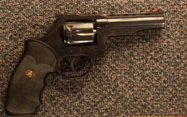

I do a lot of .22 revolver double action shooting and so when I saw a used Dan Wesson .22 for sale I jumped on it. It's a .22 on what seems like a .38 frame and that's all I know about it, besides it's having a 4" barrel.

Welcome Jim, thanks for visiting New Members first. The DW .22 revolvers are built on the .357 (small) frame. It can seem a little heavy for a .22 lr revolver, but this frame has two advantages:
1) It is strong and durable, this frame was built to shoot a heavy diet of pretty stout .357 Magnum.
2) It shares a great majority of parts with the .357 Magnum version, including most of the internals, sights, grips, etc.
You also have the Pachmayr Gripper on that gun, the very best aftermarket rubber grip available for the DW small frame
You done good!
January 16, 2016 - 9:11 pm
What do you want to know?  It is based on the small frame Dan Wesson, a heavy frame for a .22, but DW built the .22, .22 Mag, 32 H&R mag, 32-20, .38 Special and .357 Magnum all on the same durable frame.  You will never damage a DW shooting .22 LR.  The Dan Wesson action is one of the smoothest double action revolvers around.  The guns are very accurate due to the cylinder being secured at both the rear and front of crane and also the barrel is held in tension which drastically reduces barrel whip when firing.

BTW, that is a Dan Wesson Model 22 with a 4V (4" Vent Rib), nickname 224V

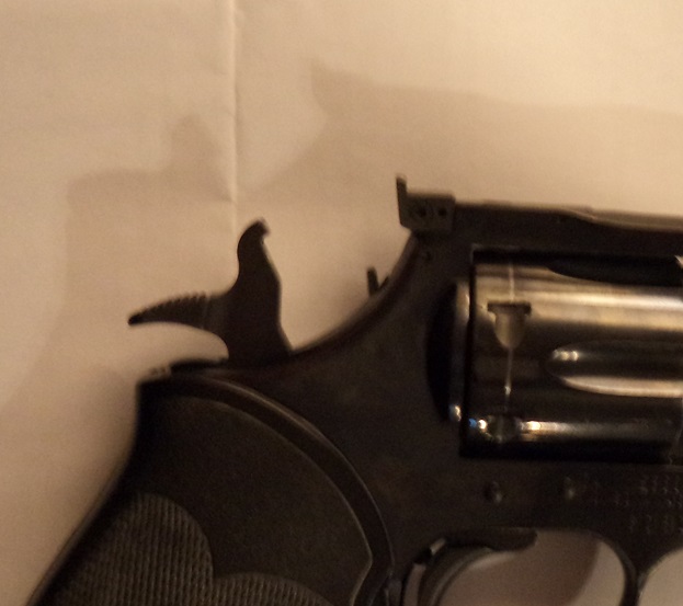

Have a look at this:
dw.22.problem.jpgImage Enlarger
That's the firing pin connector sticking up in front of the hammer. I don't think it's supposed to stick up like that... is it?
To the best of my knowledge, the pistol internals are assembled correctly, but that thing always sticks out like that.

Actually, that appears to be the transfer bar, and that photo looks like every DW small frame in my safe when cocked for single action.

Steve is correct, that is the transfer bar and is perfectly normal.  You may need to contact Dan Wesson in Norwich NY for the parts you need if you can't find them at Numerich or on ebay.
