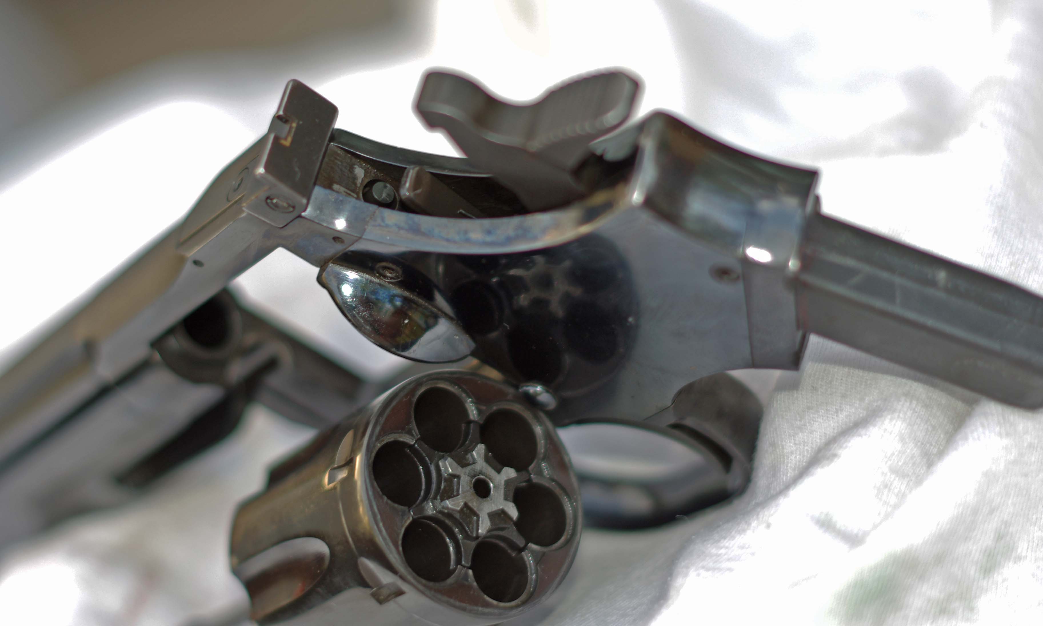

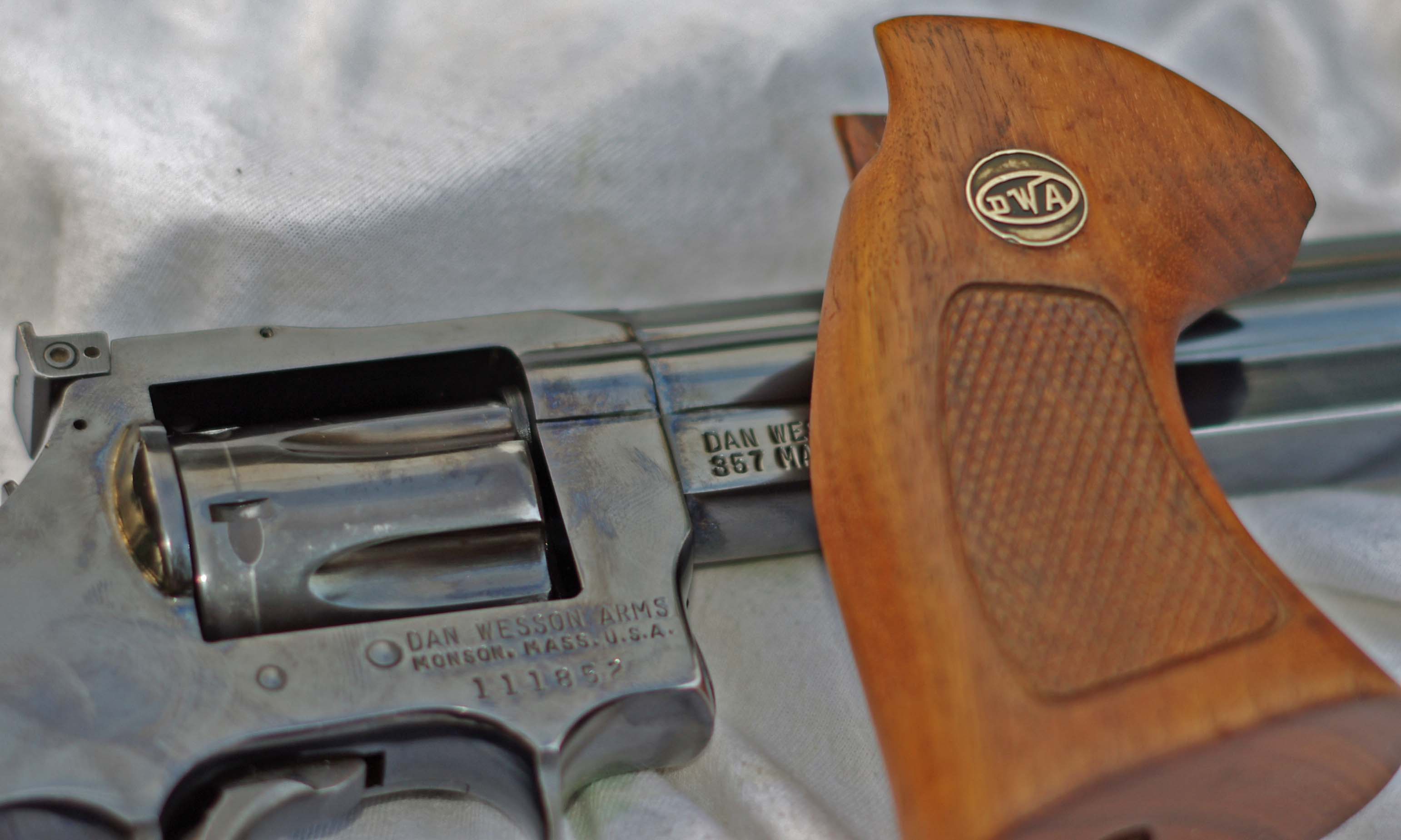

Here's a couple of pics...your info will be extremely helpful when I get back from San Antonio..
Here's a couple of pics..DanWesson.jpgImage Enlarger
Wesson_cylinder.jpgImage Enlarger

dwf-welcome to the dwfYou did get a very nice deal on the wheel gun.  It looks like you have a VH barrel on it, they balance out very nicely.  There is a lot of information here, glad you joined us.
May 20, 2015 - 11:12 pm
Very nice pistol and that price is what we call GTDW, Grand Theft Dan Wesson. I wouldn't touch the blue on it at all. keep her wiped down good and shoot her. As mentioned in previous posts, you need a barrel wrench and a flat feel gauge for that barrel and Ron already gave you the link for the Average Joe Tune-up. If you didnt get a wrench with the gun, take a gander over to the right side here and see EWK link. Eric will have the best wrench for the money and you can pick up a small set of flat feeler gauges at any auto parts or hardware store. Good luck with her, and feel free to ask away on the questions, tou'll find we all here will help keep a Dan going any day and any way we can.
