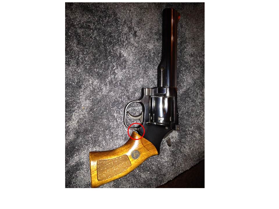

Can anybody tell me if this gap between my grip and frame is normal?
http://i1061.photobucket.com/albums/t472/michael_wilson16/Mobile%20Uploads/95E4CF91-302F-4DE7-A317-03E6EB89323D_zpsdhrwq7ln.jpgImage Enlarger

Not unusual, and is not a problem. Unlike other revolver grips that are held in place with screws thru the sides of the grip, DW grips are held in place with a screw thru the butt of the grip on a long square tang.
Word to the wise upfront: Do not overtighten the grip screw, this will create issues with SA/DA action

Awesome. Thanks guys. I was kinda worried about the grip being like that. But yeah I agree middlecalf. I love guns with character. I'd much rather have an old gun that looks like it's been used everyday for 50 years (as long as it's still in decent condition of course) than one brand new right off the line made yesterday.

Hey Michael - looked a little closer at your gun pic, and there seems to be more gap between the trigger guard and the grip than I'm used to seeing (red circle area in pic).  BUT, I'm not an expert on the different DW grips, so I'll defer to one of the other experts, maybe this is not a big deal and normal.  Hope someone else can chime in a set this to rest.  Anyone?confusedgun-grip.jpgImage Enlarger

I know you would not like to see that gap, there is still no functional problem as long as the grip is steady and solid with no wobble. I would double check that the grip is fully installed on the grip tang with no debris or foreign material at the bottom of the inletting for the grip tang.

So do I need to remove the grip and check it out before shooting it? The grip seems pretty solid but this is the first Dan I've ever even held so I know nothing about them.
