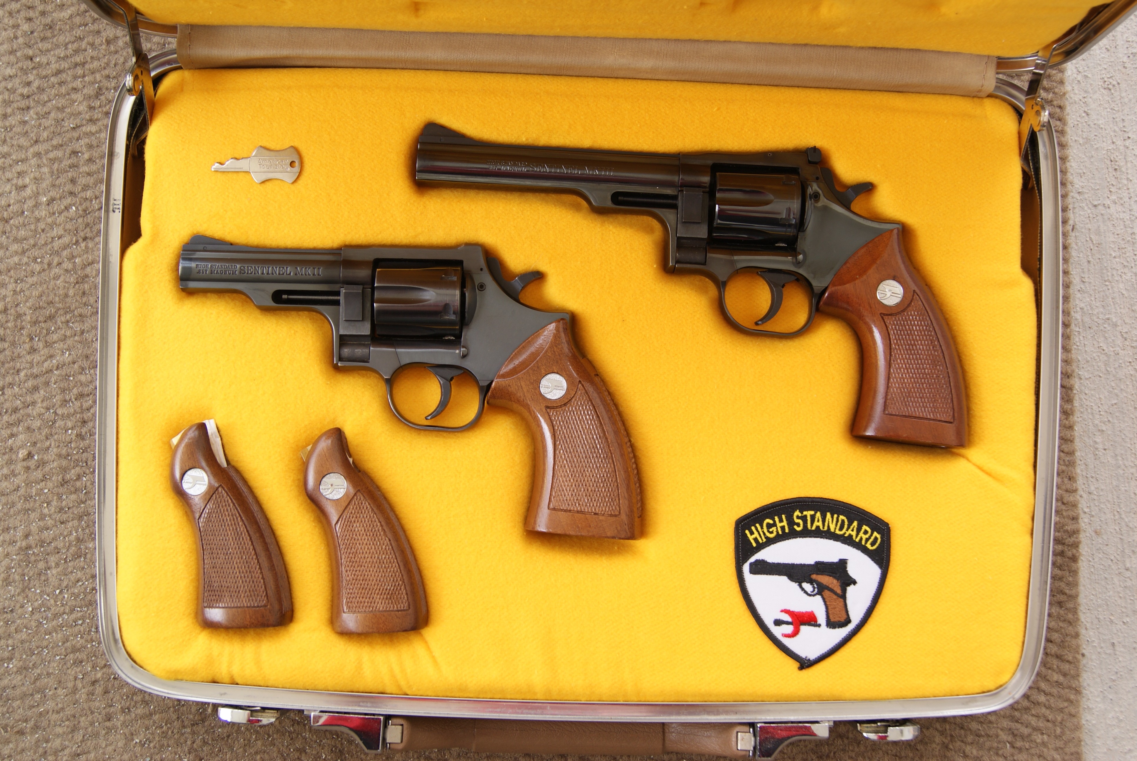

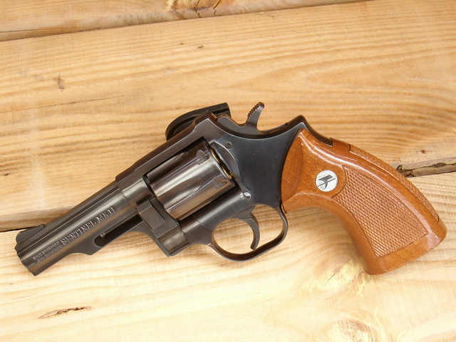

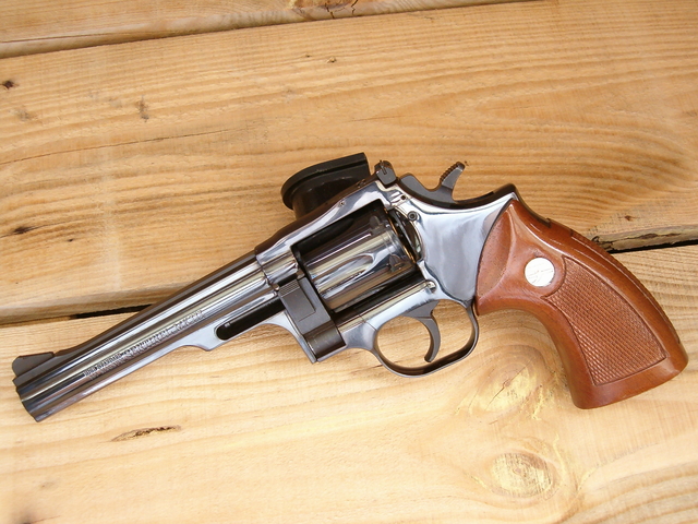

BTW, here is my pair of MK's...no idea why the thumbnail size, they get larger when you click. broken-computer
*EDIT* Found some larger pics...I knew I stashed these somewhere! screwy The first pics show off the bluing better, though.

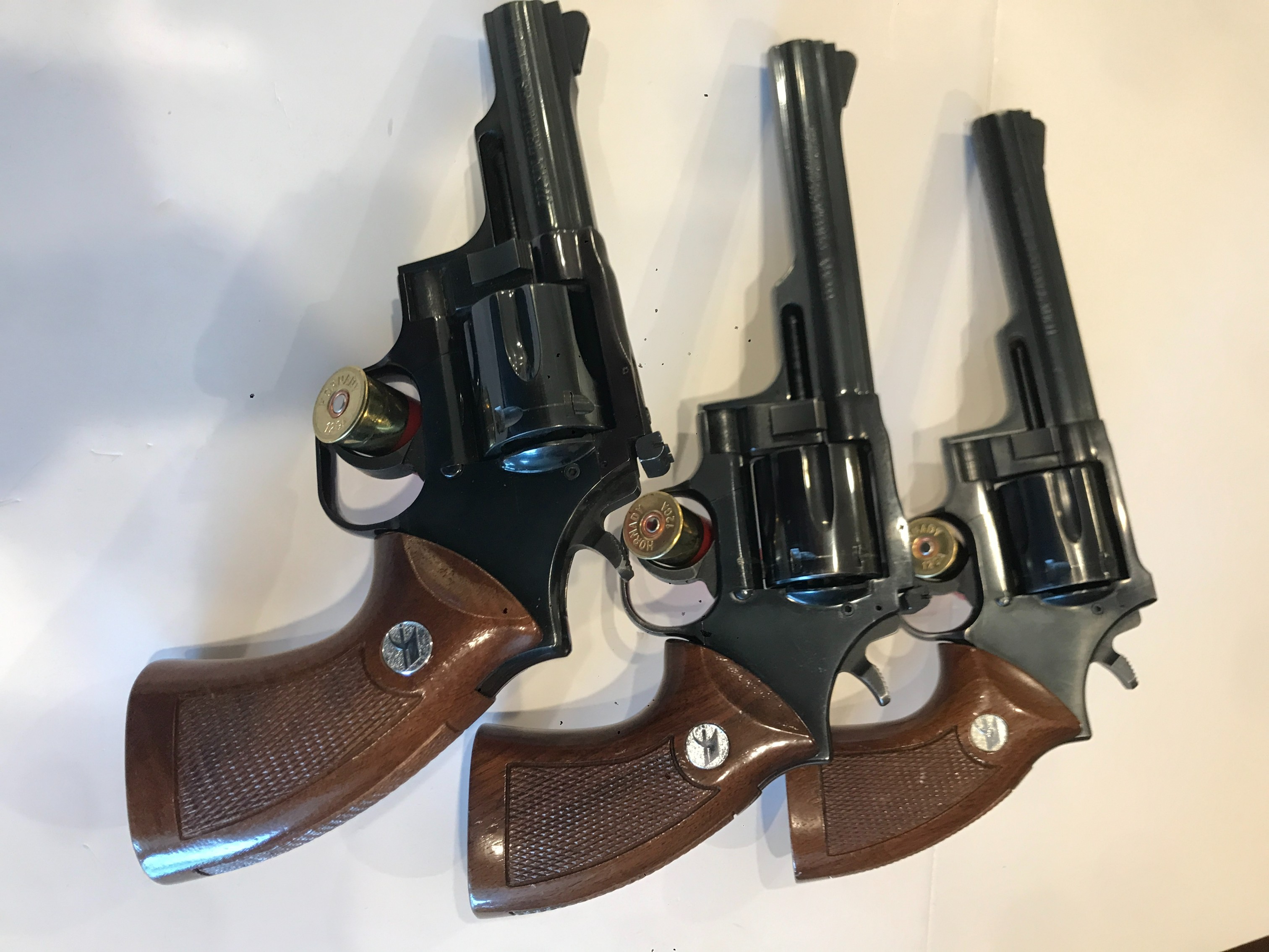

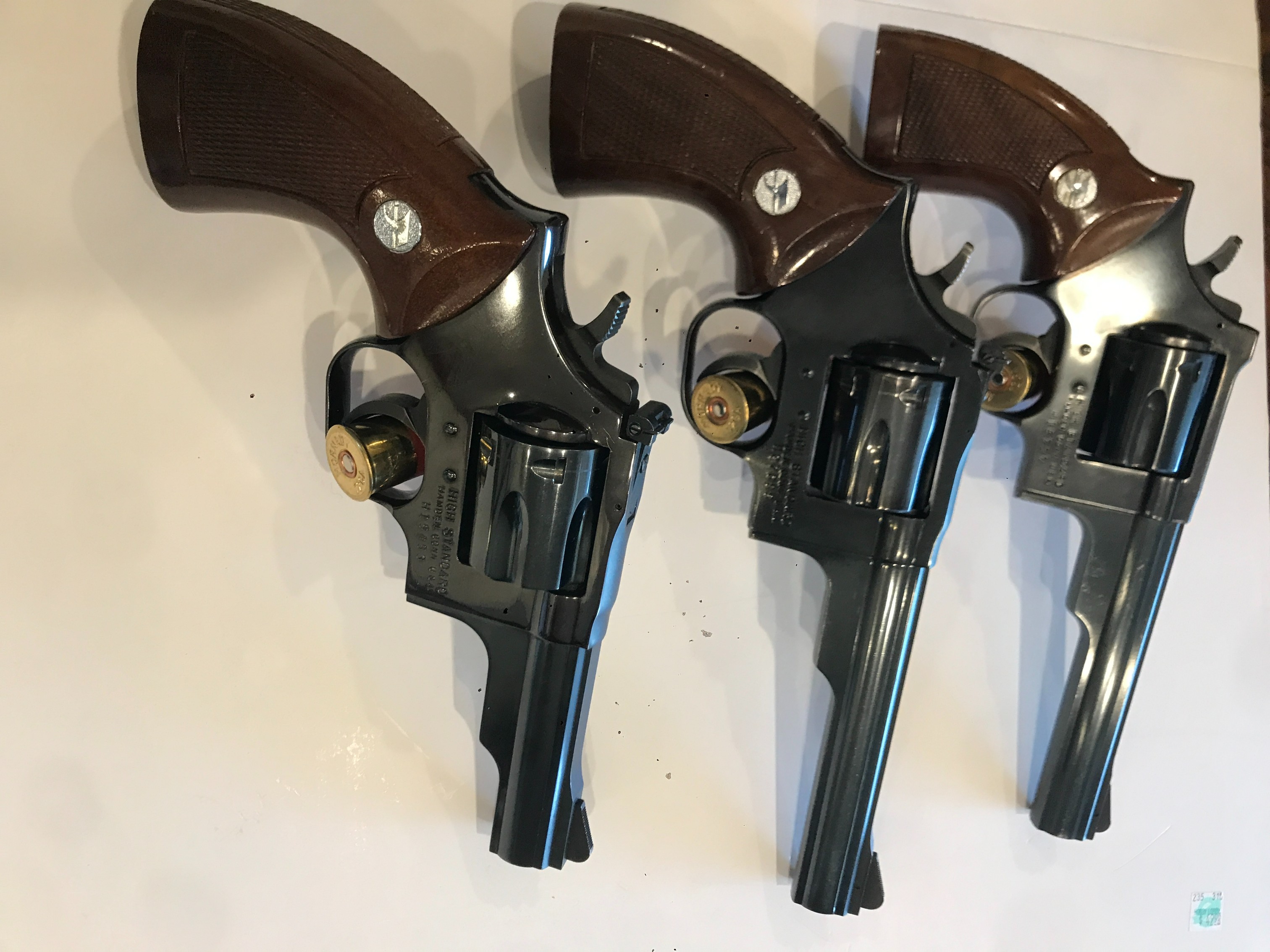

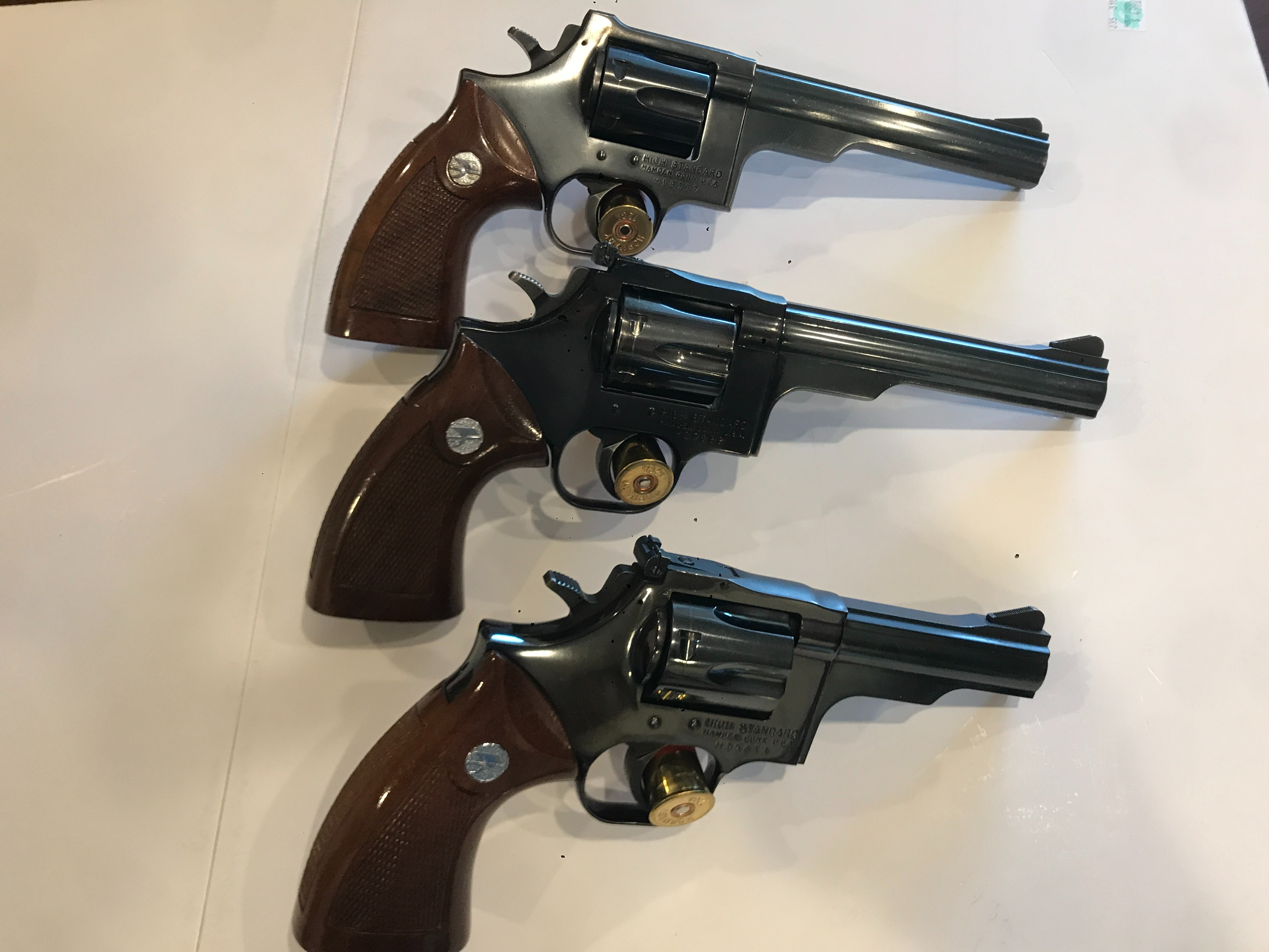

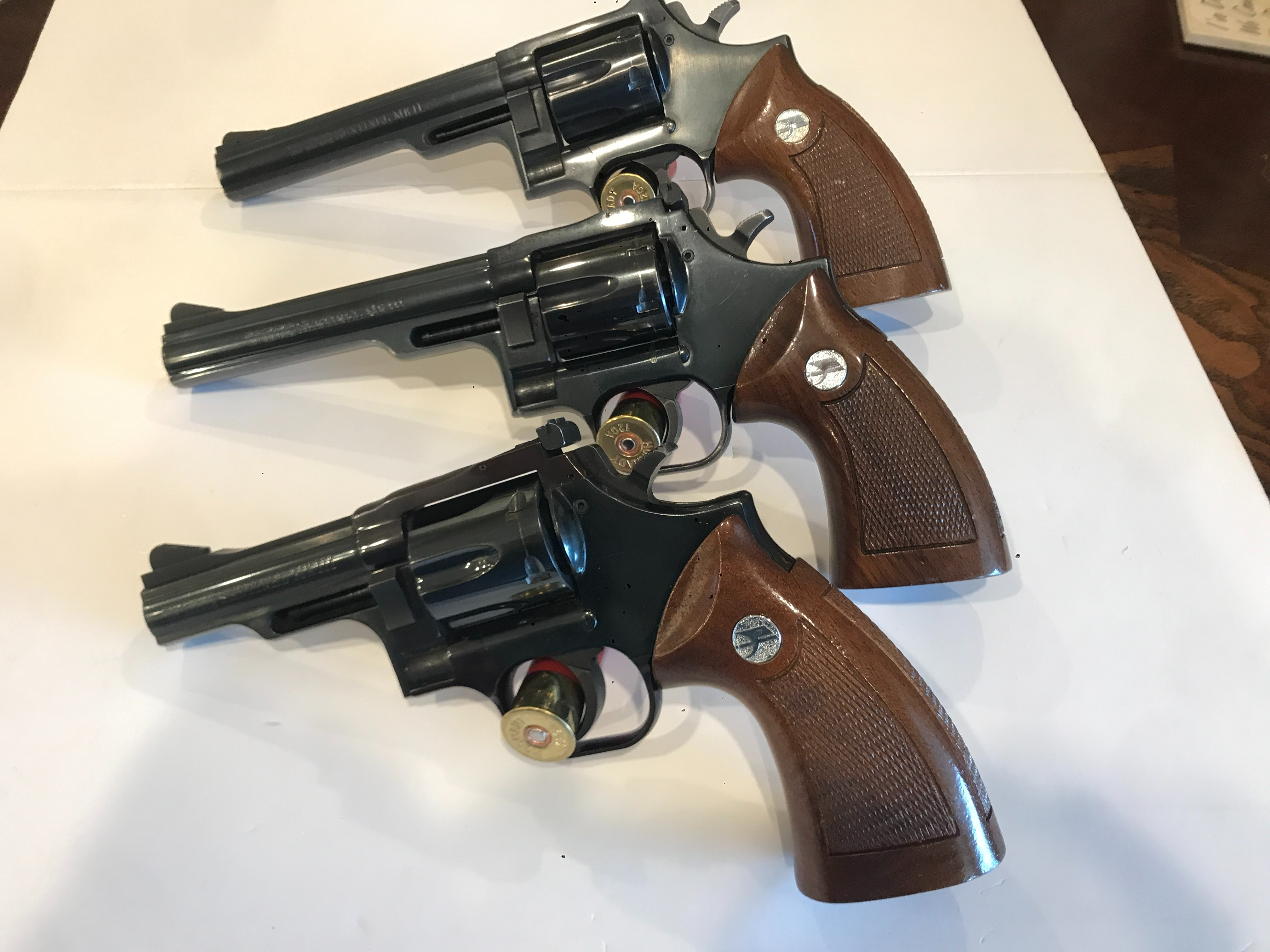

These are my 3 High Standards.
The hue on the MK IIIs are brighter and have a much cleaner look and both have target sights.
The MK II serial number is in between the MK IIIs.
Top:        MK II    H16767
Center:   MK III   H27099
Lower:    MK III   H15453
Sorry I can't get all 3 pictures level.

There are still a bunch of as new HS grips out there that until recently have been reasonably priced. Nice grips.

Nice collection of High Standards, Steve S! It looks like the 6in MK lll is showing the gouge mark I was talking about, but not as bad as my DW 15-1. I think mine has a very high round count. However, since I’ve added the shim, the cylinder bolt cuts no longer drag there as long as I’m halfway careful when closing it. I used a dab of oxpho-blue to help conceal the marks (the photo above was before the shim).
