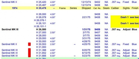

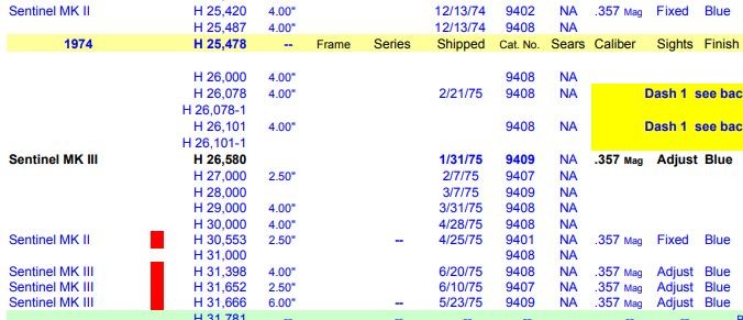

sentinel-SN.JPGImage Enlarger
Ole Dog, Thanks again for the info. That would explain the different hues. And I'm not saying I think there is some awesome value here or something. Not really concerned with that at all. Just trying to make sense of the info I'm seeing.
I tried to upload a pic. If my upload attempt worked, look at the "H27000" range of SN. Mine is H27,1xx. But according to this chart, that means Mine would have been a MKIII with a 2 1/2" barrel, correct?

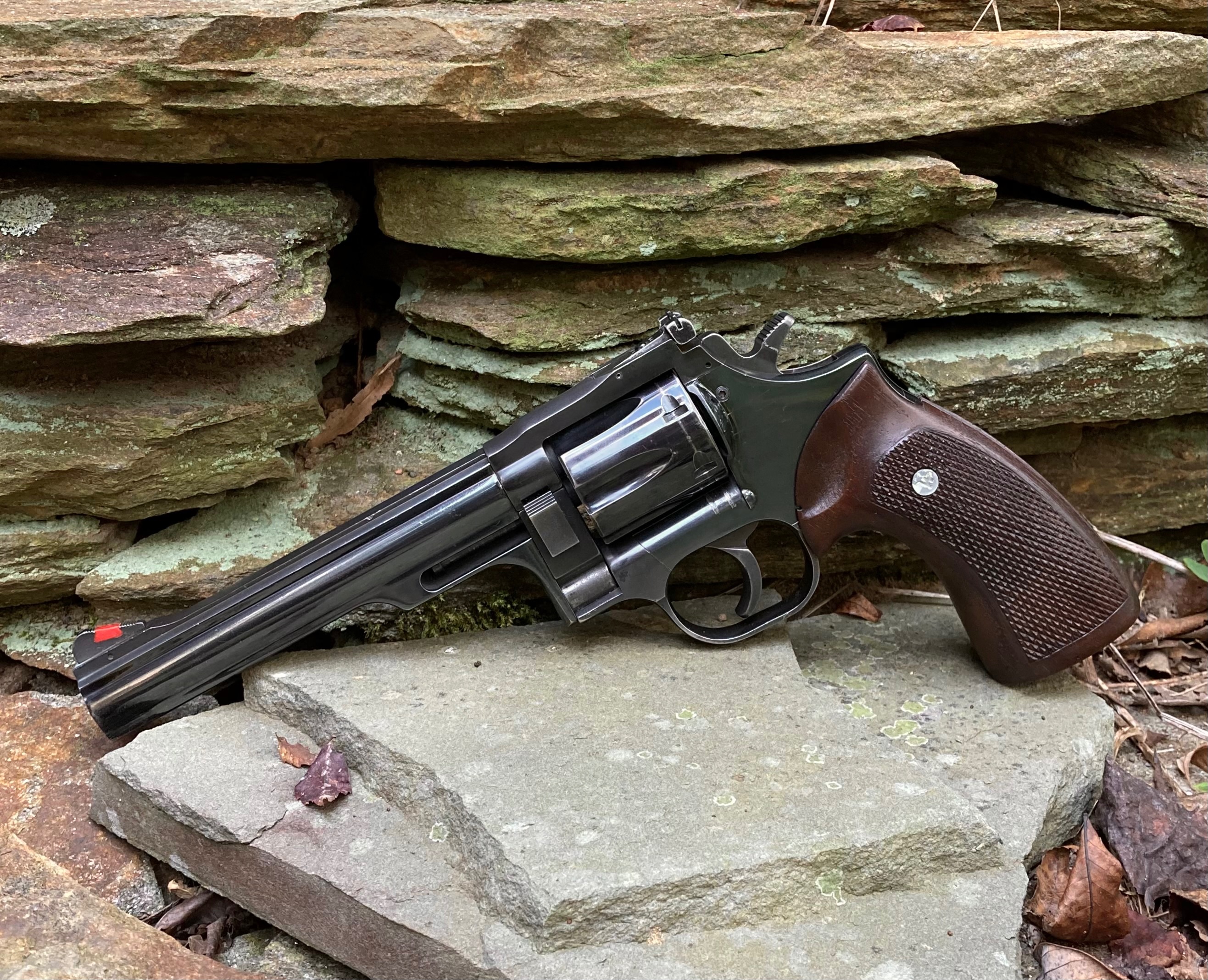

Here is a photo of my DW 15-1. Your gun should not look like this. The Mll Sentinel should be a dull finish with fixed rear sight.IMG_0785.jpegImage Enlarger

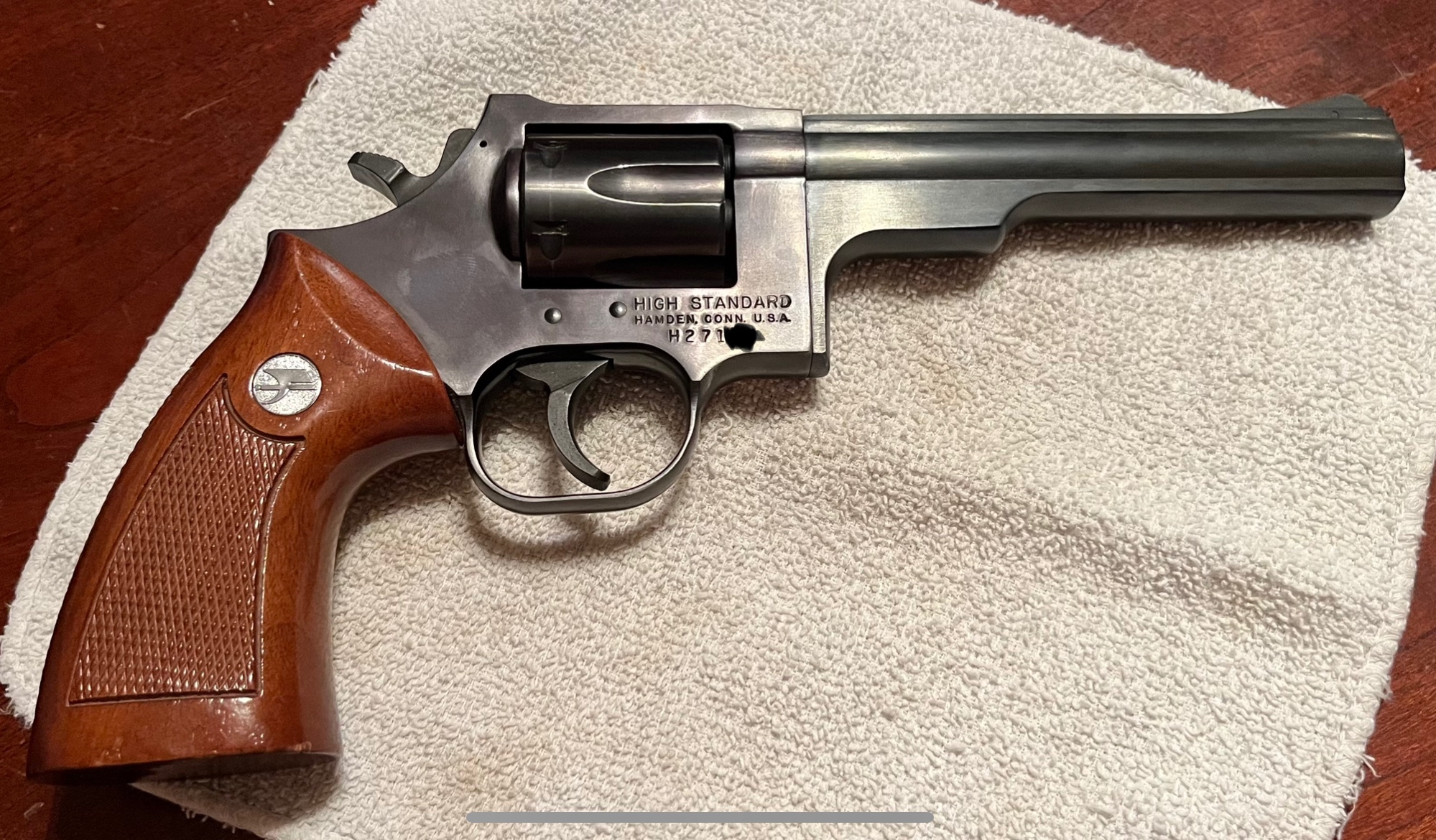

BD33F16B-FDF4-4293-975F-8E0E0A5D2D20.jpegImage Enlarger
Trying to upload a pic of mine now…

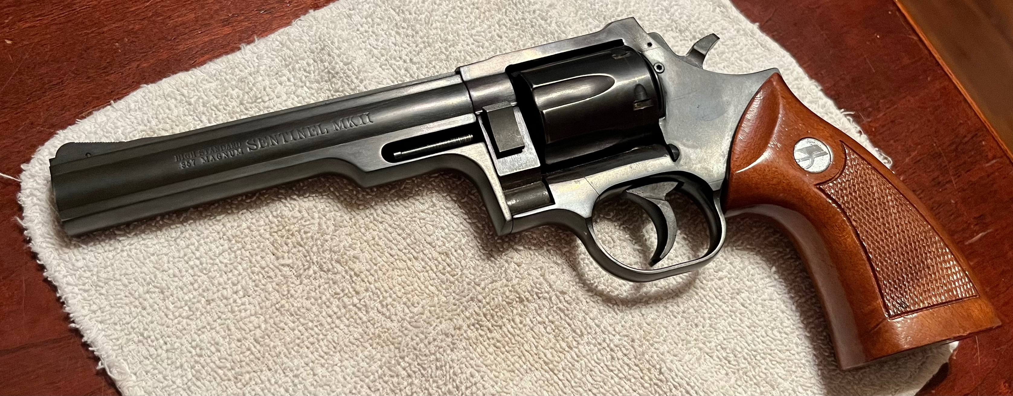

055BFCA6-F26A-4AF5-8D53-CCE75CCD7BA1.jpegImage Enlarger
Yay!!! At least I think I figured out the pic upload thing… haha

Yours is a MKII fixed sight service model, like the DW 14-1.

I get that. I know the fixed Sights was MKII. But look at the SN chart. Doesn't that say the 27000 SN started the MKIII? And that my SN range would have come with a 2 1/2" bbl?
August 3, 2023 - 9:52 am
No. Our S/N Registry is just a list of members guns, not official. His had a 2-1/2" BA, but yours and any other close number could have had any length barrel.

All things considered, you have a very well made, and seemingly little used revolver. My 15-1 is the most accurate in my collection due mostly to its amazing trigger. You are fortunate that yours doesn’t have the telltale gouge marks on the frame like mine does. This is from the poorly fitted cranes of that timeframe. I put a .002 round shim in mine, and this has kept it from getting any worse. The previous owner paid no attention to this and every time he closed the cylinder the notches dug into the frame. Almost every one of these 1974 guns whether DW or HS that I have seen has these marks, except yours.
