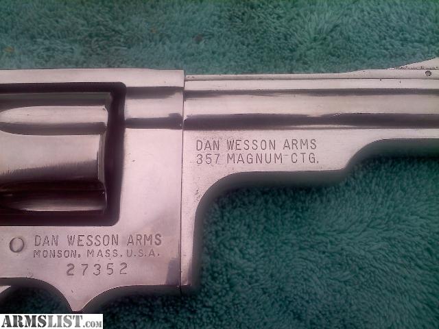

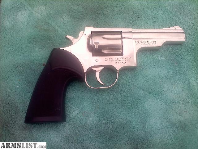

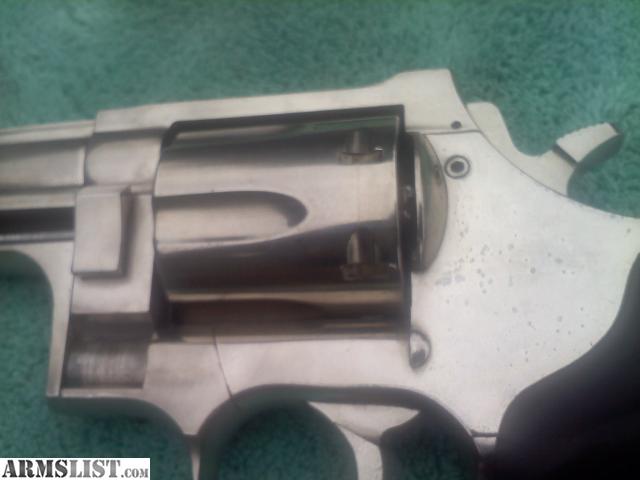

Which leads me to the questions. Yay for me, right? Id like to avoid sounding like a super newbie, but hell, i am so who cares. Ill put up some pictures that arent mine, but are actually of my gun, which has been on armslist. First of all, most common question, what the hell do i have? I cant quite pin the model. Its stainless/nickel, stamped Monson, serial 27352 with no model stamped. Its also porkchop, and fixed sights. Without trying to go into model specifics, ha ha, the gun store i bought it from said it was a 714, (but i think its nickel) and the armslist post i found said it was a model 15, (which have adjustable sights, right?) with a model 12 pork chop barrel, (what?) so, needless to say im confused as hell. If i can get that figured out, i know EWK has my barrel wrench, but where would i go for another barrel, just for future reference? Am i screwed because its a porkchop and have to find one on ebay or armslist? What do i do as far as holsters? I found one on Cheaper Than Dirt, but other than that all ive seen is non fitted crap that i wouldnt carry a stick in. And ive picked up tidbits, but any tips are greatly appreciated, like the cleaning guide on the forums, or somewhere i read that if the grip screw is too long you can bind up your mainspring. I think i might be having that problem just a little actually, i need to check it out better but i know my grip screw is "custom" and not too pretty.

Welcome aboard! More will chime in with the correct info but your on the right track. I would hate to guess exactly what model it is as I'm also kind of a newbie to DW's. However I am learning fast and have acquired 4 more. You'll feel the itch of DWAS creep into your blood, too.
November 20, 2014 - 8:59 am
My guess is 14-1 from 1973-74. Not possible for this to be stainless, it is likely nickel. With that S/N it is not a -2 with a porkchop barrel retrofitted. Grip is not original.
Beware with nickel guns that any cleaner that is a "copper cleaner/remover" can damage the finish. Nickel is/was  often plated onto a copper base, and if a copper cleaner infiltrates under the nickel and gets to the copper layer, the finish may start peeling off.
If you want to clean up the finish, try working very lightly a very fine polishing compound. The operative words here are VERY LIGHTLY! Consider using a gun wax to preserve the finish.
Nice looking gun, Welcome to DWF

For now my best guess was a 14 or 14-1 from 71-74, due to various things, so thanks for a bit of verification Steve.
Im 100% on the nickel too, its quite shiny and nice except for the slight, i dont know what to call it, almost pitting but not quite on the left side behind the cylinder. Hopefully i can perhaps polish that lightly and make it go away, if not oh well.

Steve clued you in on the care of nickel. No strong chemicals. Snake-eye explained the grip screw. Look for shrouds on ebay. Nickel porkchops show up occassionally but bid like you really want it. The scratches on the left side behind the cylinder are probably from the cylinder closing while ejecting cartridges. Almost all dans develope them before the owner learns to keep the gun tilted to the left when ejecting . Also keep your fingers pushing the cylinder with your left hand to prevent closing while the ejector is deployed.  You have a very nice model 14 in nickel. It is a great first dan. That is what DWAS means. Dan Wesson Acquisition Syndrome. The compulsion to buy more dans, barrels, grips etc. You seem to have it already. Your experience with seeing one and becoming preoccupied  is how most of us started. Now you need a 15-2 so you can accessorize easier. Oh, I would get a wood grip that is appropriate to the time period of your model 14. Their were smooth and checkered target grips , Sacremento and Michigan grips in the begining. Also the slender service grips that are like S+W grips of old.   I would only use the rubber grip when you go shooting as moisture gets trapped under them and rust is very common underneath the grip. Oil the Pachmyer grip inside for easier removal. BTW, ebay is a good source for original dan grip screws and parts. Get a barrel wrench too as soon as you can and read the Average Joe Tuneup. You do not need a gunsmith . If you want to know ANYTHING, just ask us.

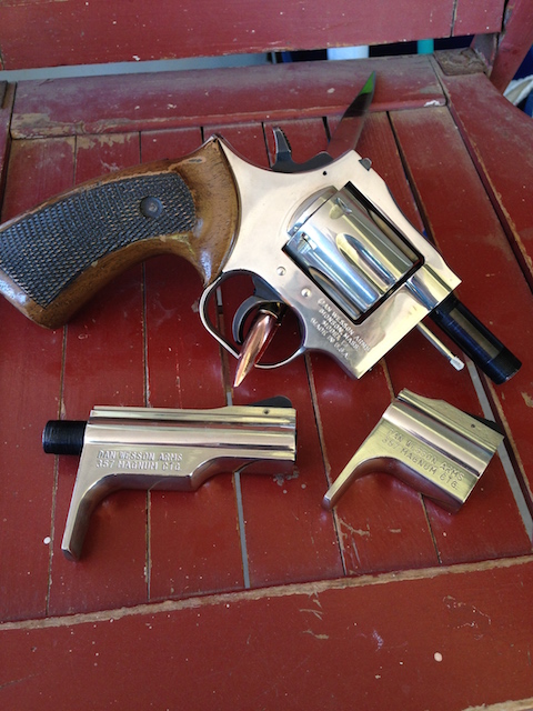

That’s a great looking gun. Has that shinny object appeal that I can’t resist. Here’s a pic of my nickel 14. I just put together the 2” BA. I found the shroud on eBay and Mr Maxwell “Arlen” Silver hooked me up with the barrel. It makes a cool snubby. Now I’m on the prowl for a 6” BA. Watch ebay. I have seen two 2” in the past year. Not often but they do show up, if the seller isn’t asking an arm and a leg and everything in between. I’ll bet Steve is correct (he usually is) on the model, being a 14-1. Mine has the model # marked just above the serial number. Maybe they removed that as part of the -1 mods. Mine also has a black trigger and hammer. Welcome to a great forum and good luck on your hunt for more accessories. That is one of the great attractions of the DW, the “quick shift” accessories. And, yes, I'm also missing a medallion, anybody out there got a stray? It's that small one with the big W.

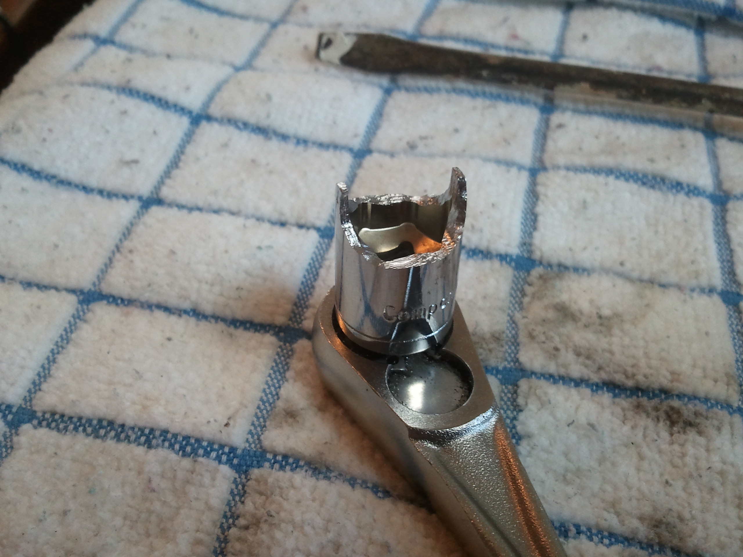

Ok, so a couple days ago, i remembered that i am a machinist, and made myself a barrel tool out of a socket so i could take apart my gun. Easy peasy. Pics incoming, i know you all like pics. Someone tell me why some parts are blued and some arent. please.
I followed the average joe tuneup on disassembly, mostly, my gun has a couple less parts than a 15.
2014-11-25-14.30.56.jpgImage Enlarger

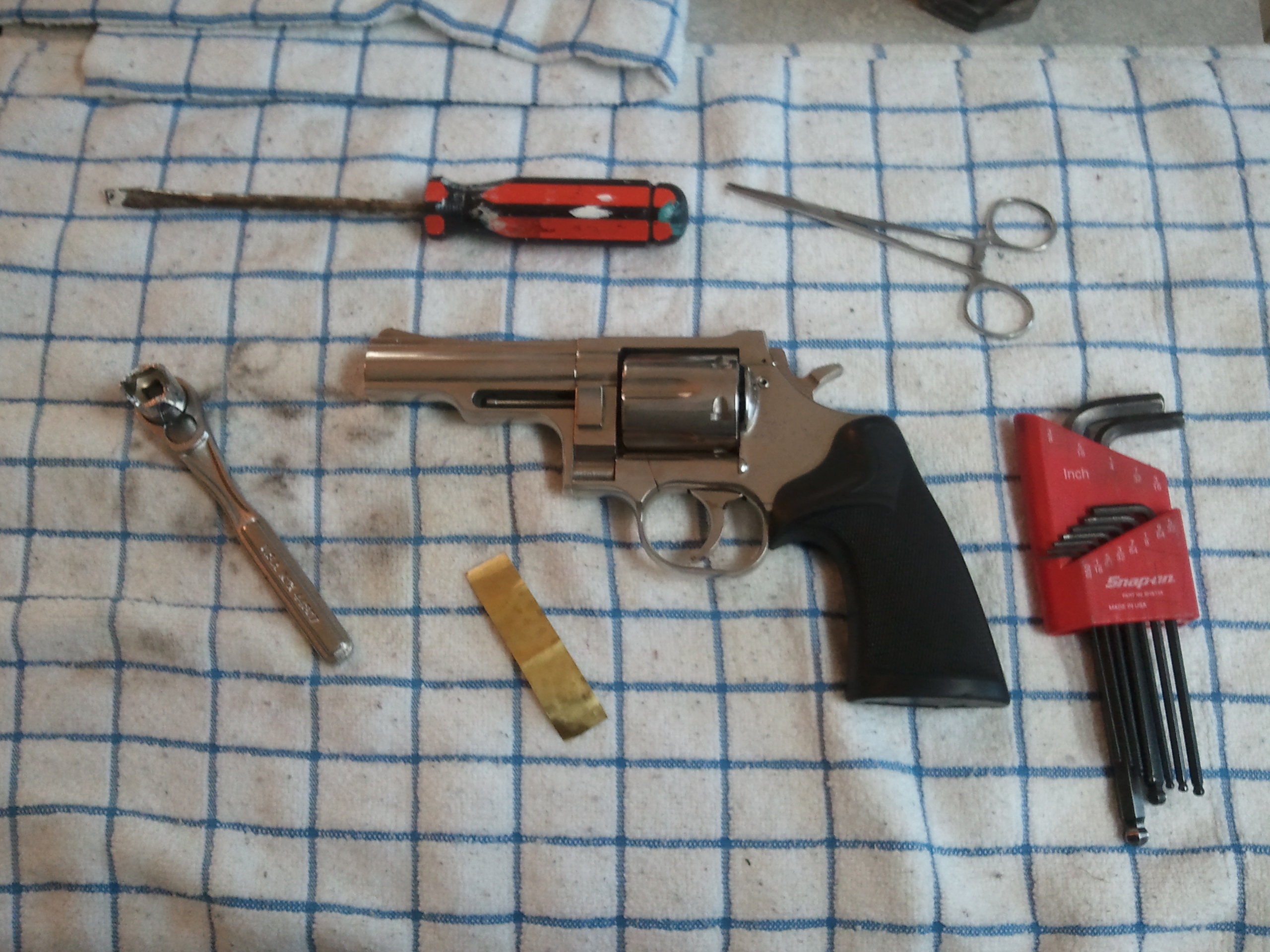

 Arright first off, my homemade barrel tool, not pretty at all, but functional. Its a 1/4 drive 1/2 in socket that i massaged with a dremel and a hammer, for reference.
2014-11-25-14.31.16.jpgImage Enlarger
 Next up, the extreme amount of tools required to disassemble a Dan Wesson. Minus cleaning products. Hahaha. The brass is a 0.003" shim that i had in my machinist toolbox, for setting barrel gap.

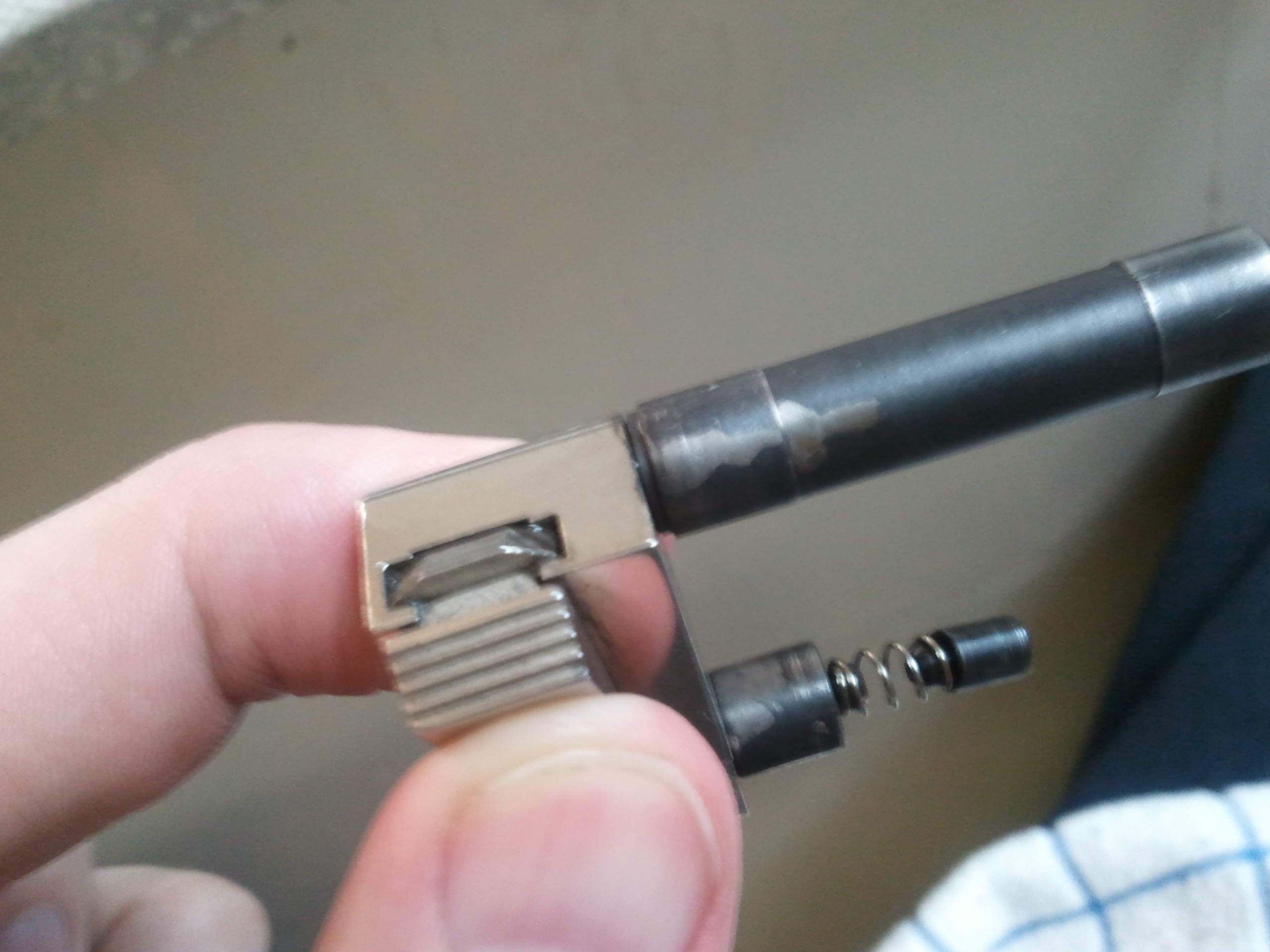

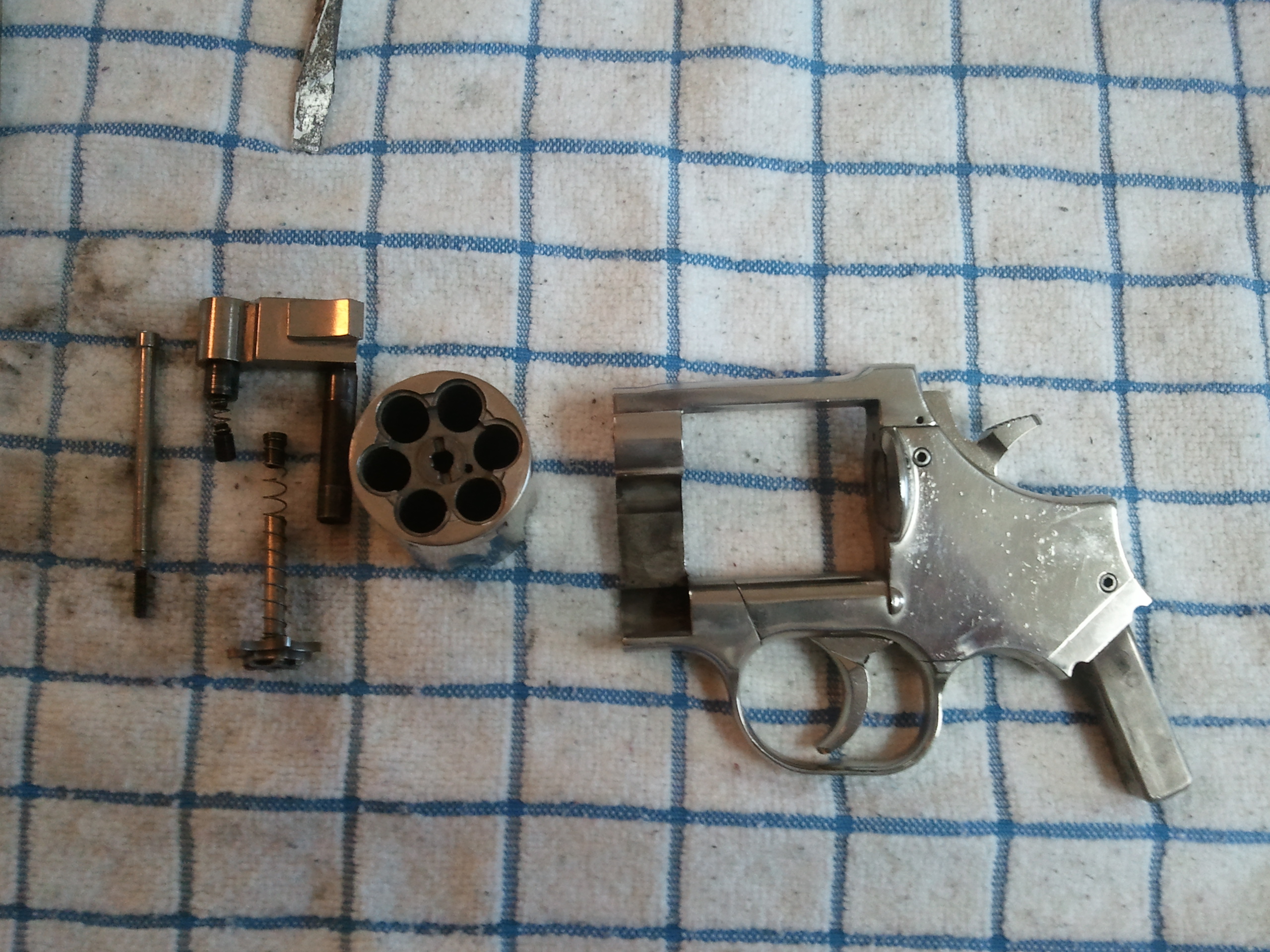

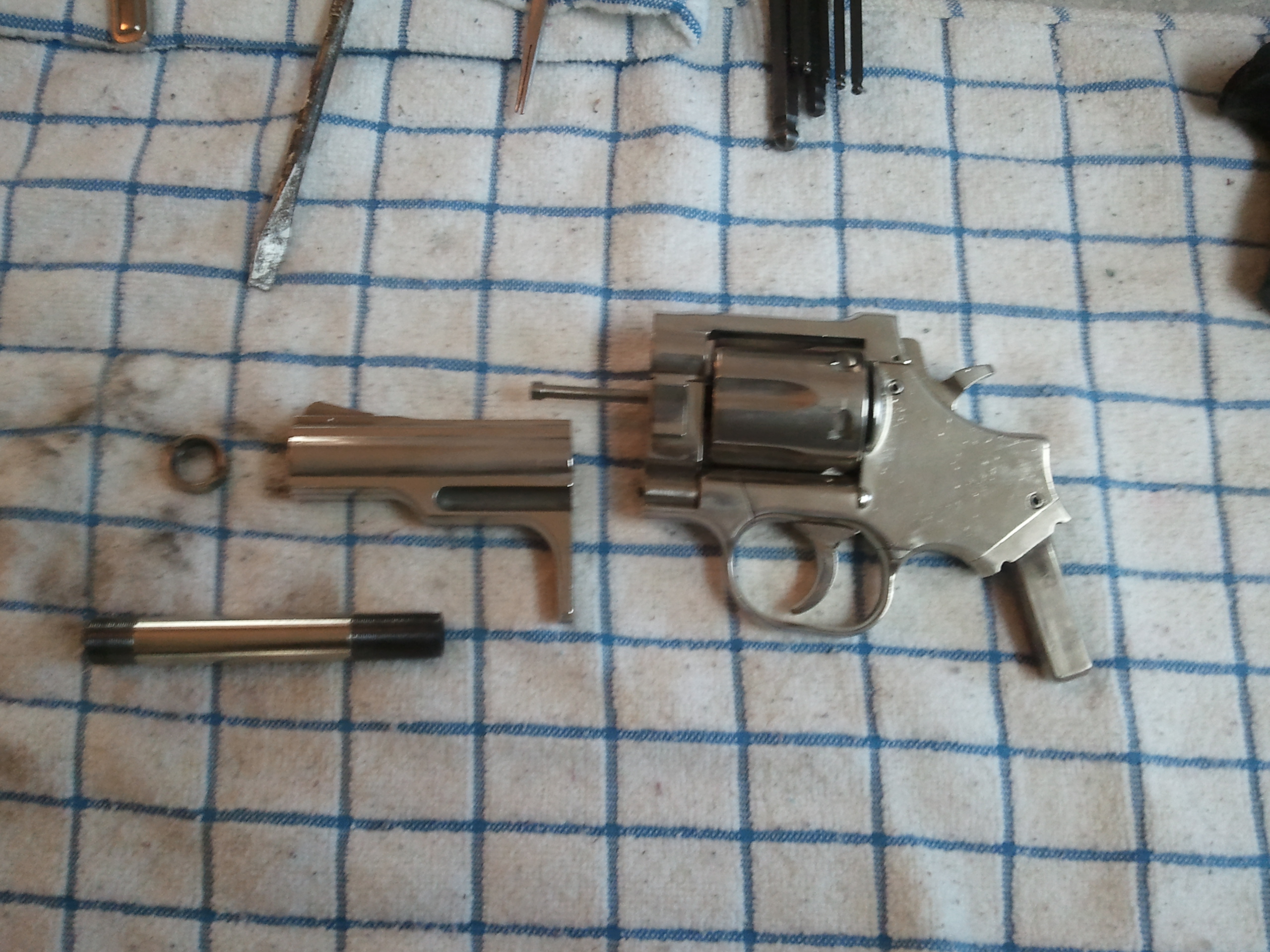

 Step two, barrel nut, shroud, and barrel.

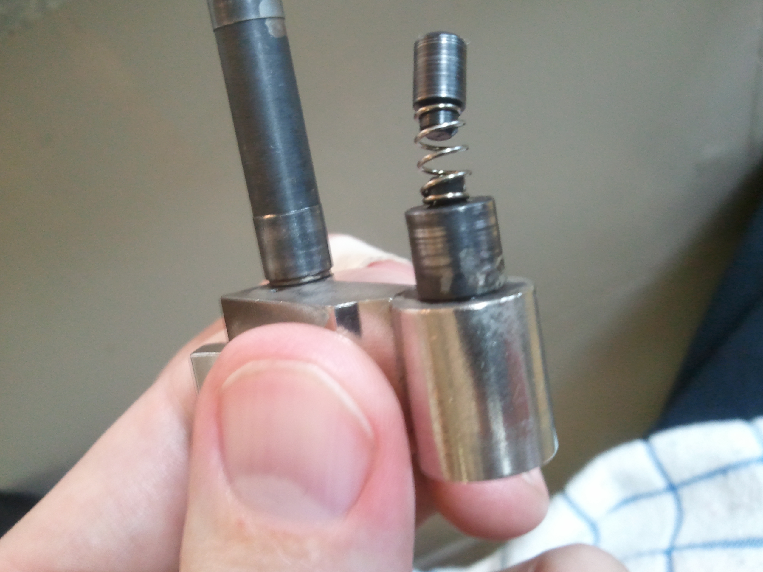

2014-11-25-14.35.01.jpgImage Enlarger
 Step 3, crane and cylinder, and i also took apart the extractor screw/star.

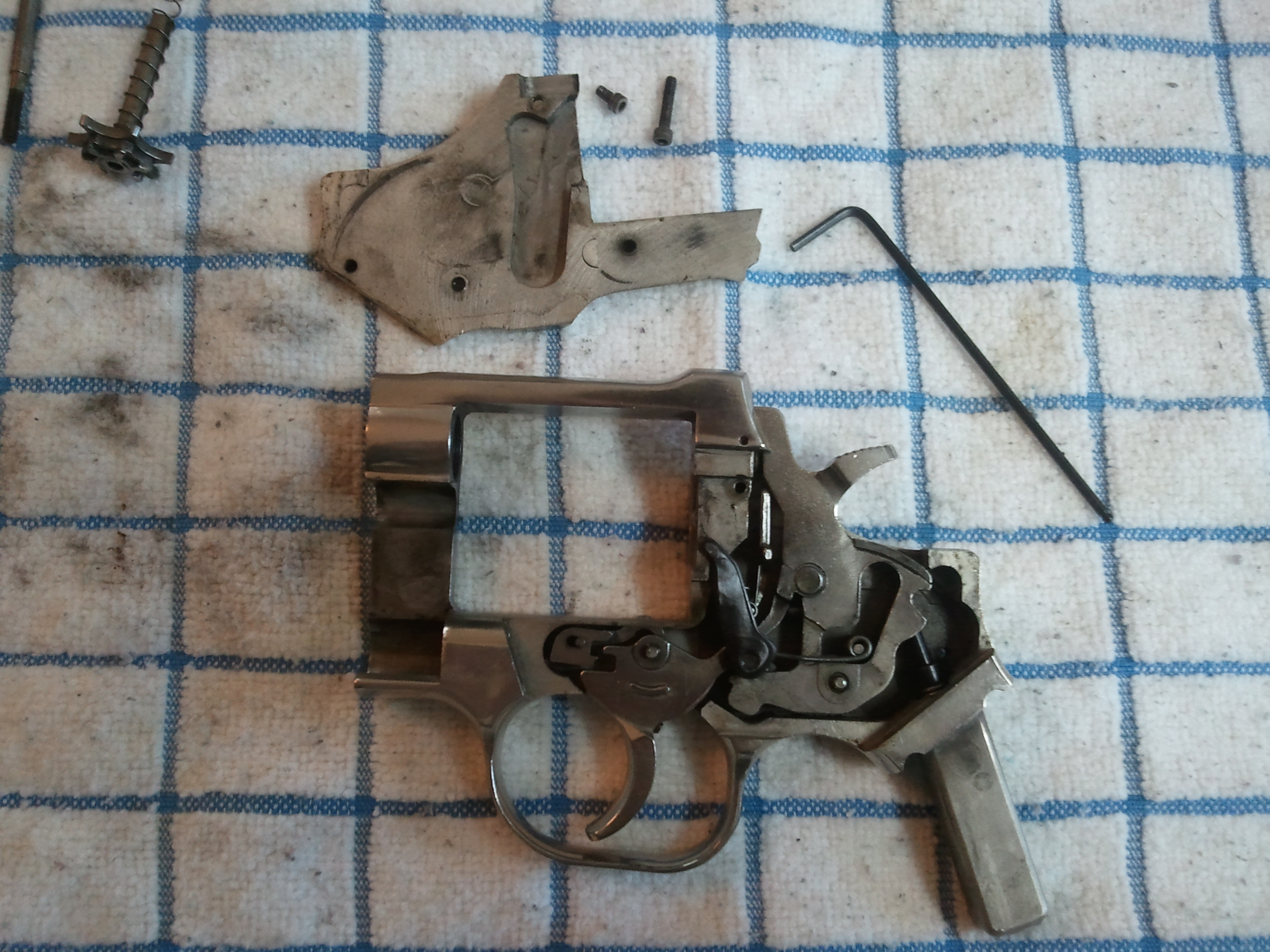

2014-11-25-14.49.44.jpgImage Enlarger

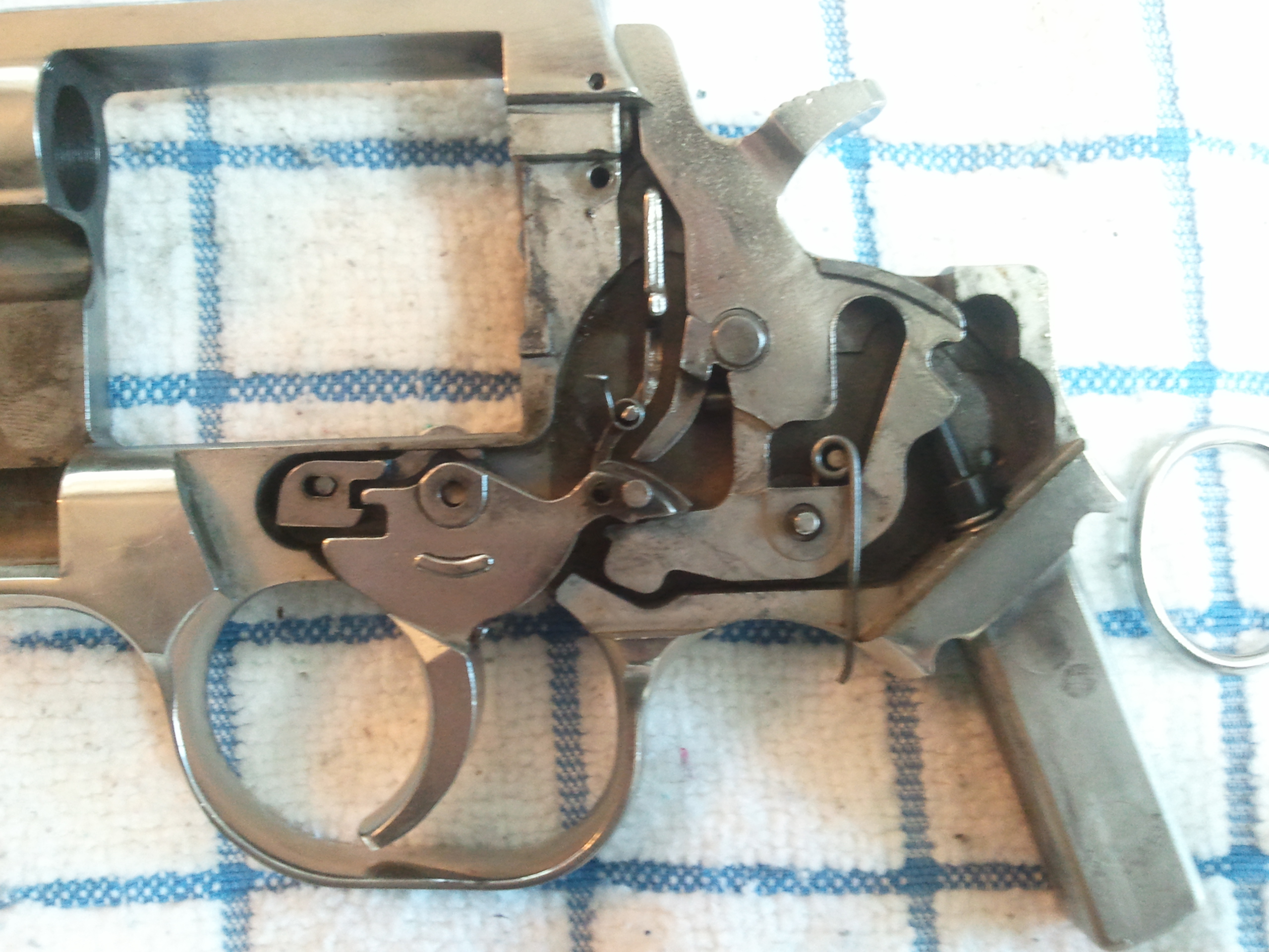

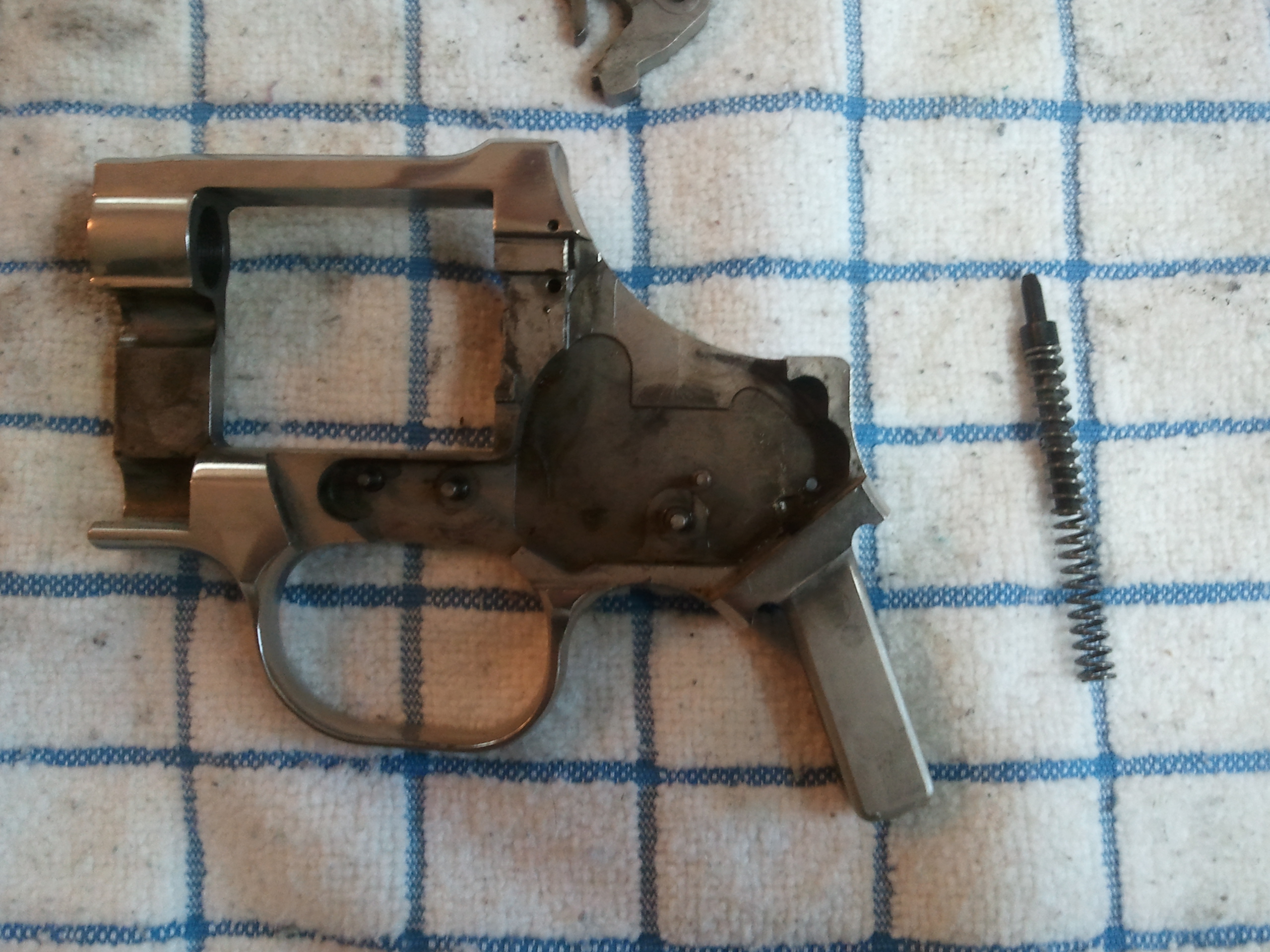

 Step 4, sideplate. Had to tappy tap with the handle of the screwdriver to get it off. Pretty dirty in there.

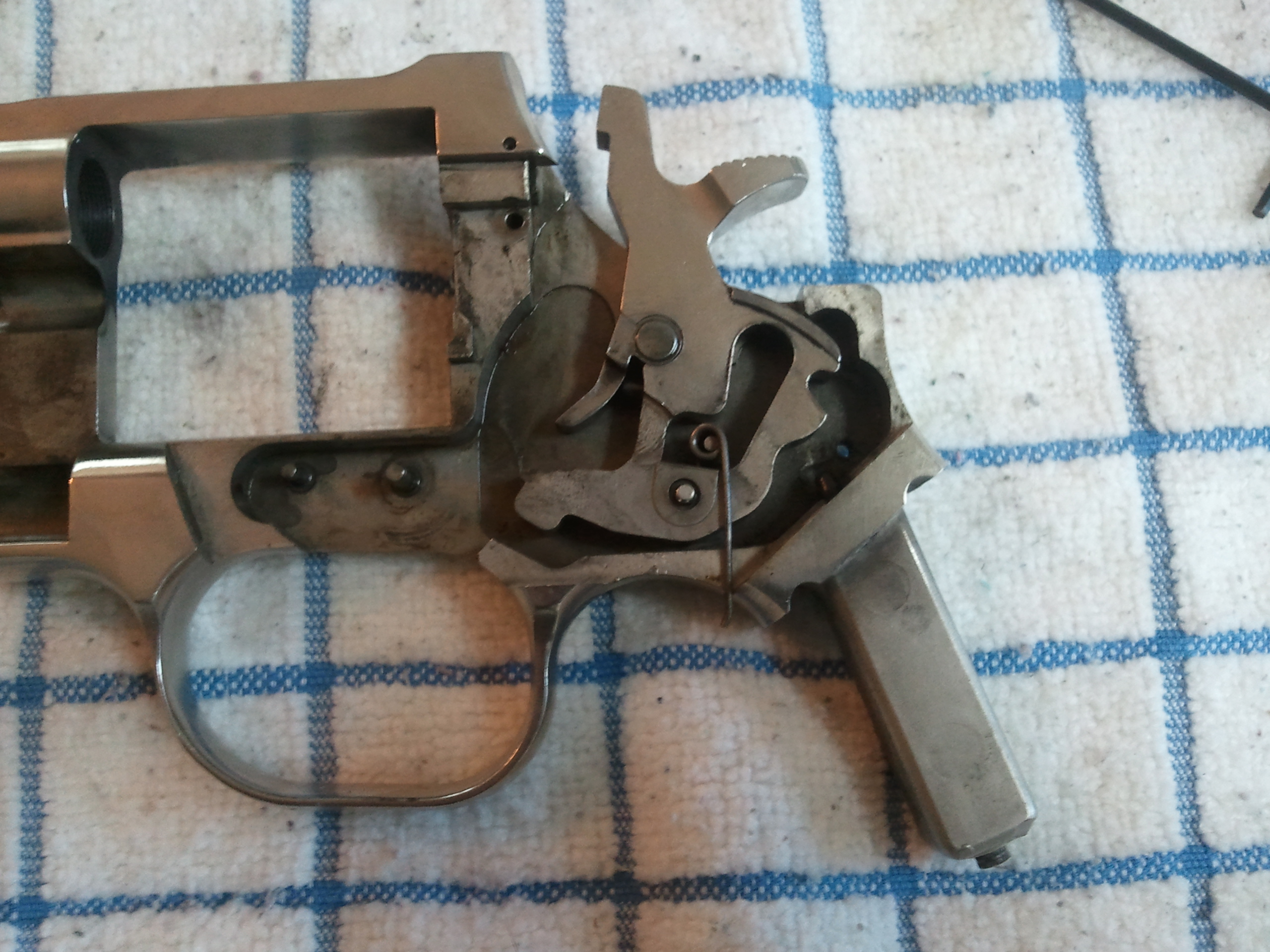

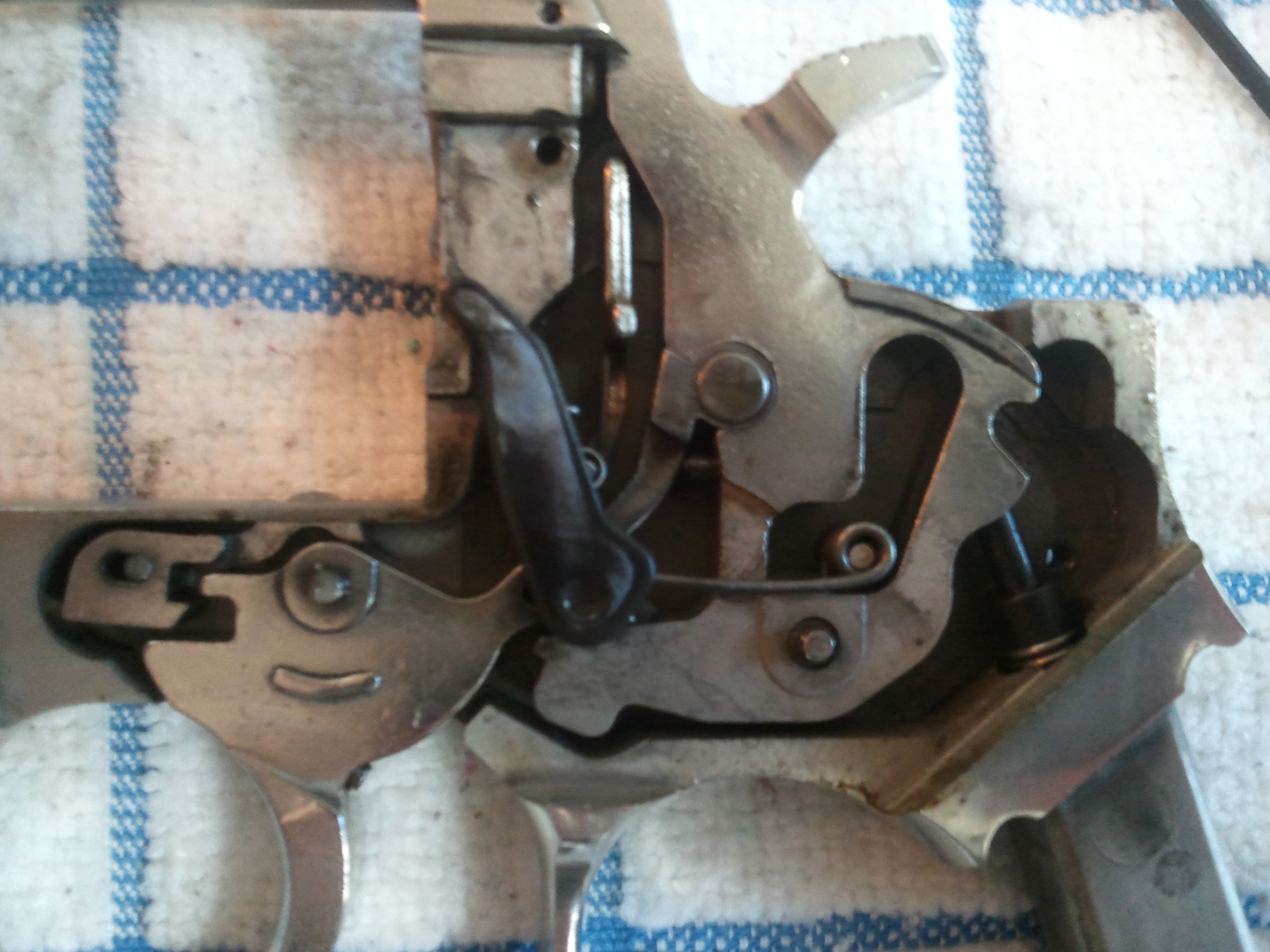

2014-11-25-14.49.55.jpgImage Enlarger
 Closeup of internal bits for reference.

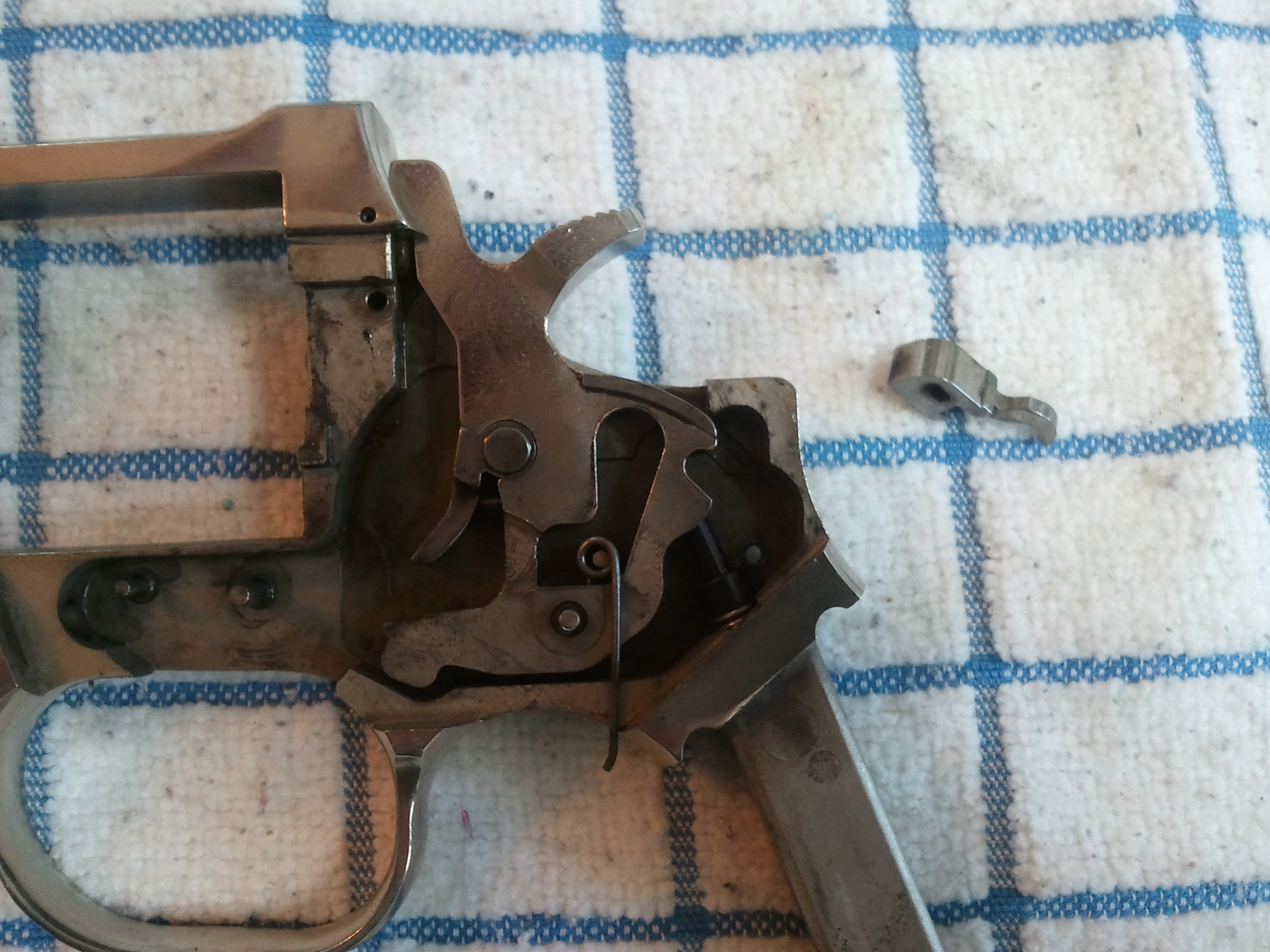

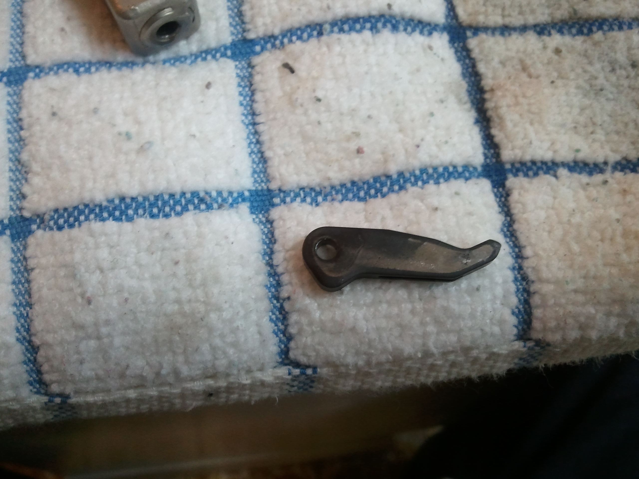

2014-11-25-14.51.01.jpgImage Enlarger

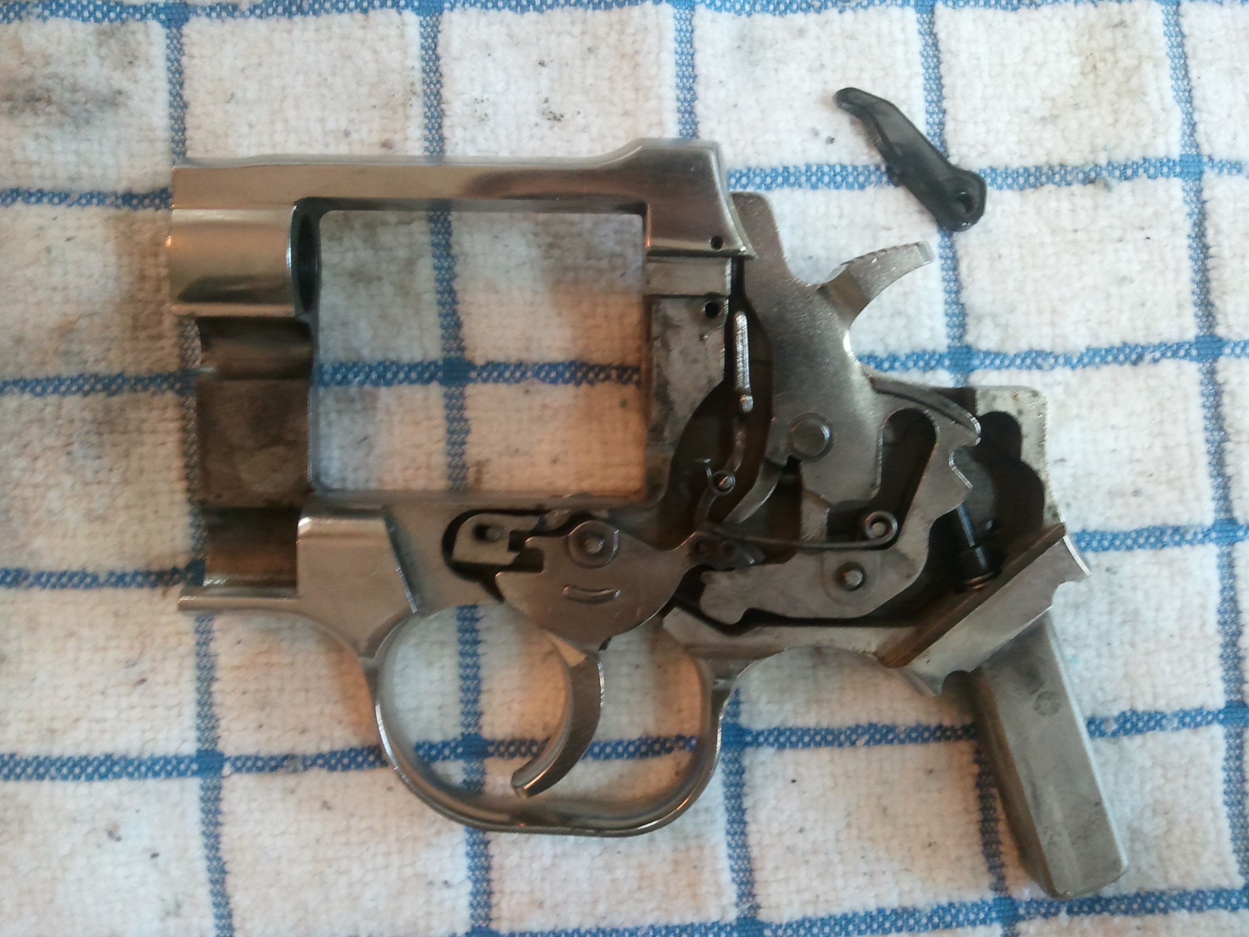

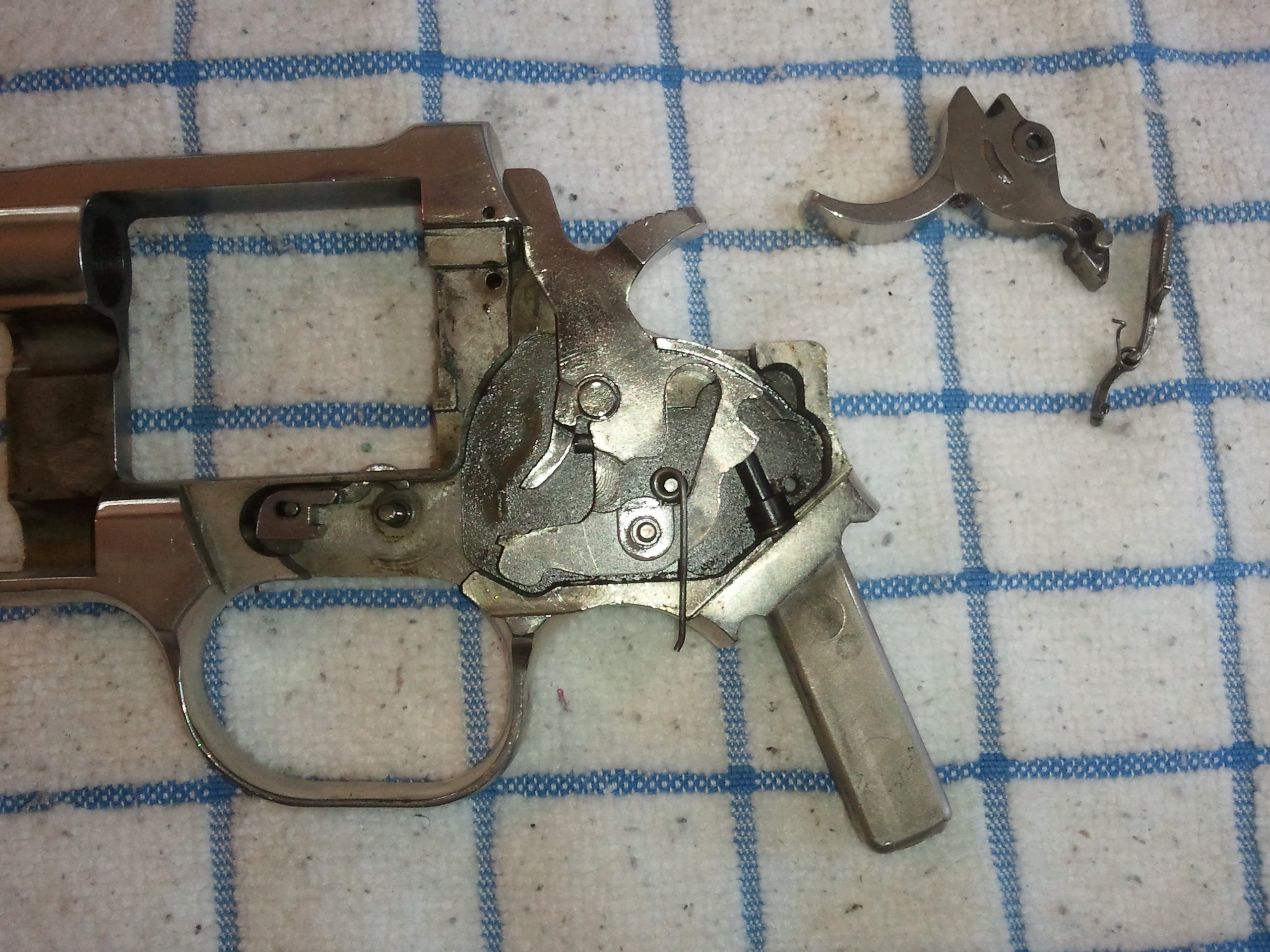

 Step 5, the hand. a little shiny and worn on the side you can see, not a scratch on the side you cant.

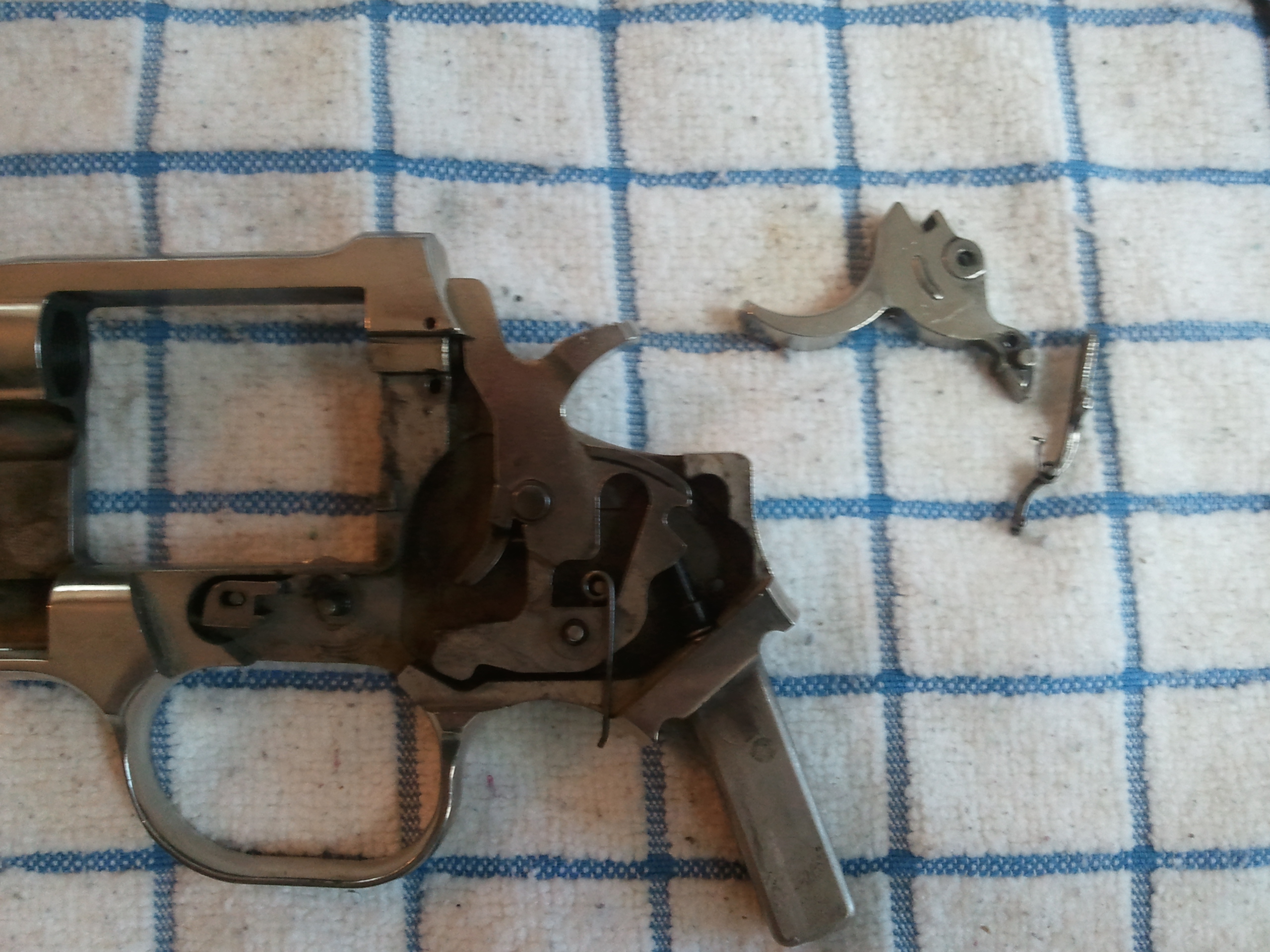

2014-11-25-14.53.01.jpgImage Enlarger
 Step 5, unhook trigger return spring.
2014-11-25-14.53.30.jpgImage Enlarger
 Step 6, take out trigger and transfer bar/spring.

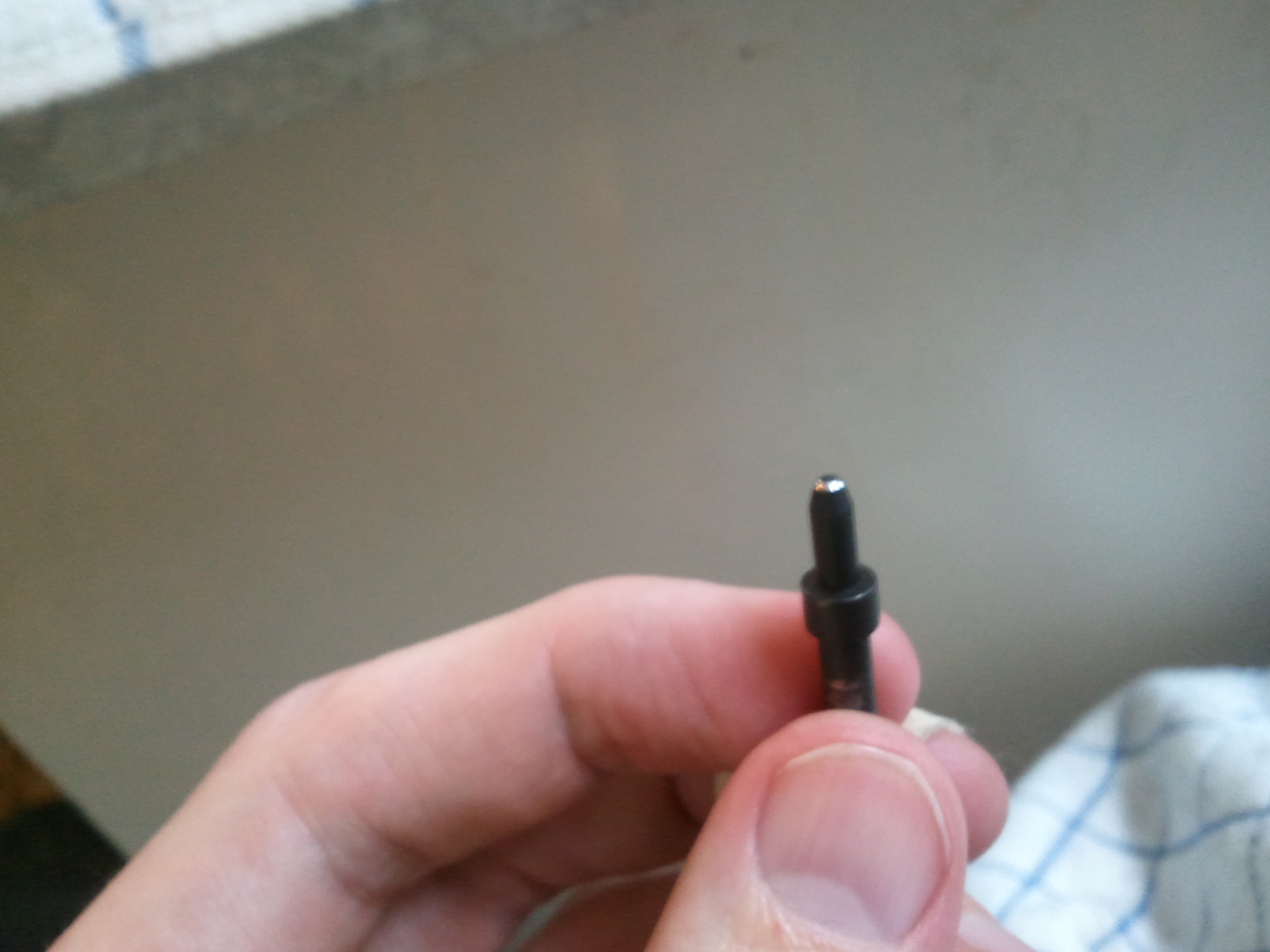

 First pic of crane, showing bluing wear?
2014-11-25-15.26.30.jpgImage Enlarger
 Second pic of crane.

2014-11-25-15.40.09.jpgImage Enlarger
 And hand.

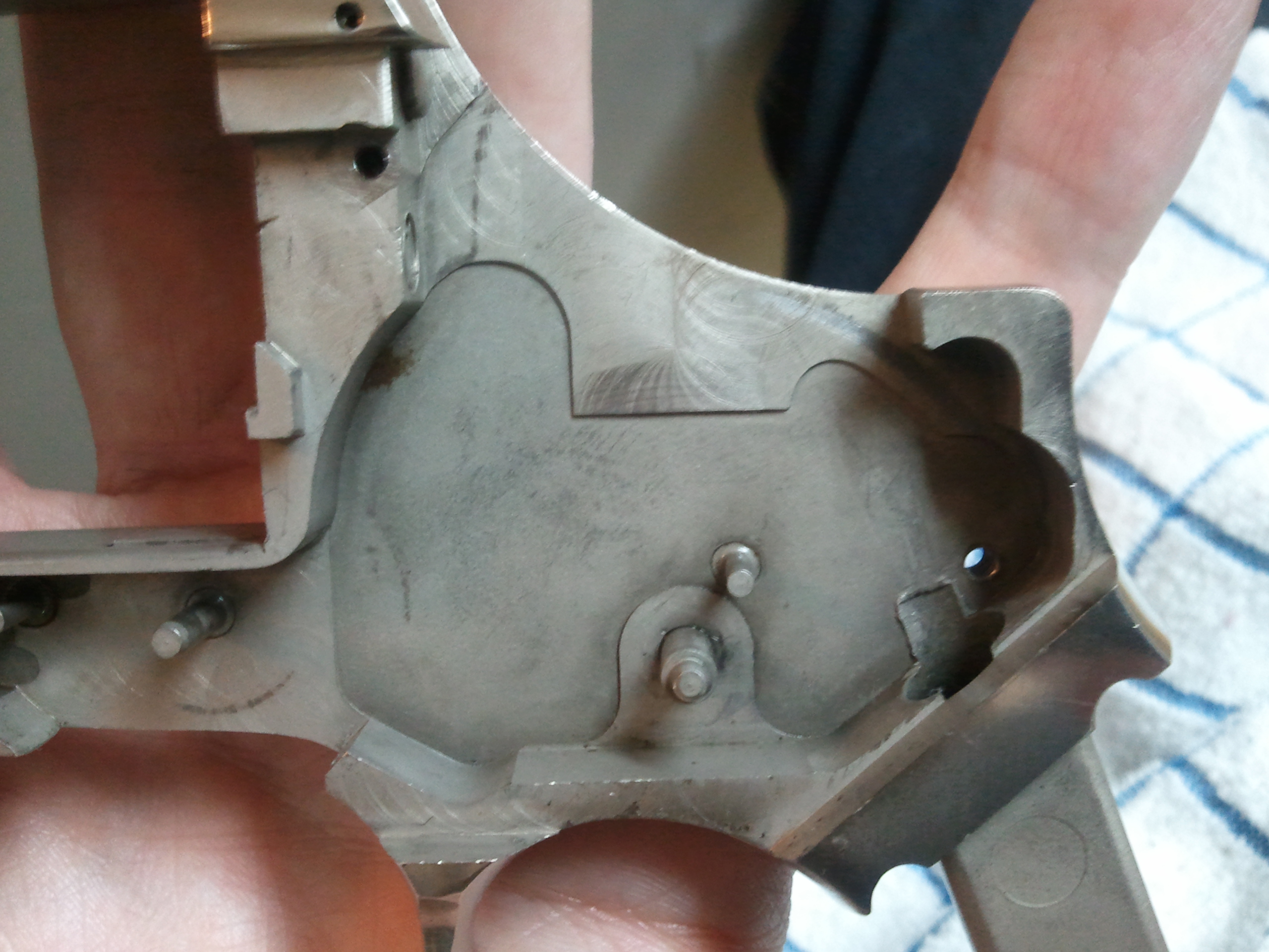

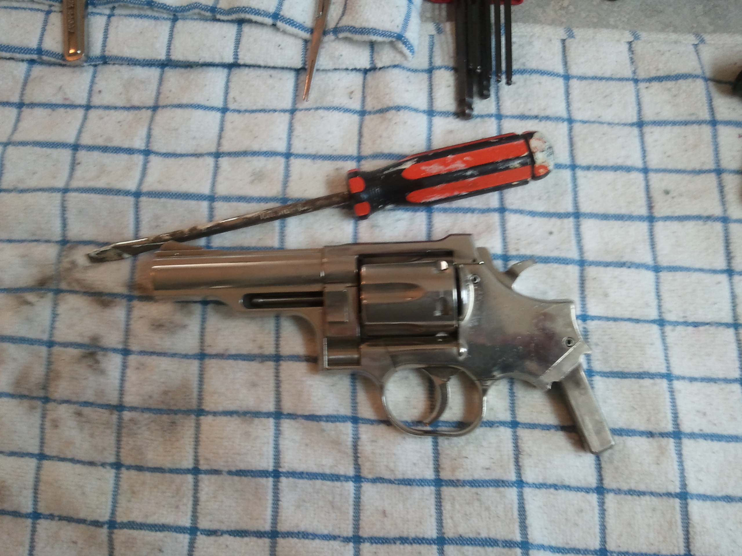

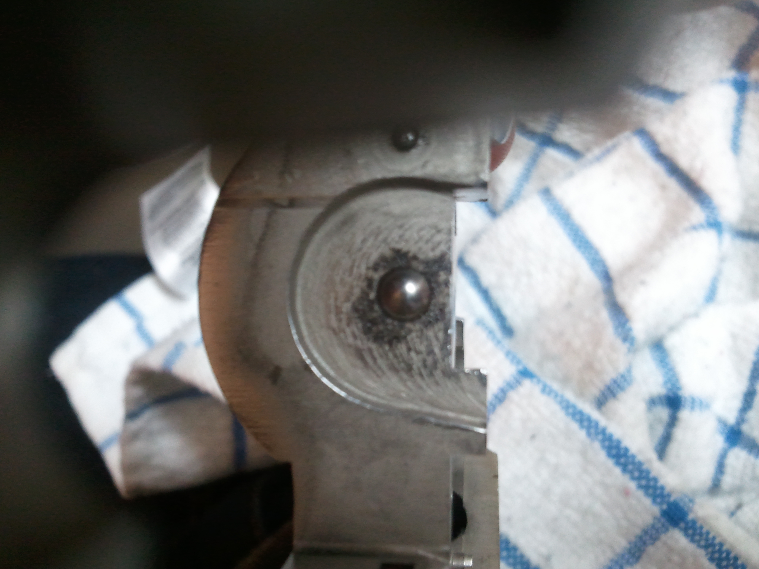

 Forgot a pic of the front of the frame where the barrel goes, its very black with residue that didnt come off, just like the face of the cylinder. Im guessing this back here by the ball is from primers.
2014-11-25-16.03.43.jpgImage Enlarger
 And magically, with no work whatsoever, the gun is clean and ready to be lubed and put back together. lol. Actually what i ended up doing was cleaning, polishing the sideplate just a little, and the tiniest bit on the hand, trigger, and hammer. After that i lubed it all up, cursed at the mainspring again, set my barrel gap, and proceeded to not go shoot it. Im ashamed of myself. I will shoot it soon. The action is definitely a bit nicer, but judging from the wear, or lack of, either i have a gun that has never been shot, not likely, or everything fits pretty much as good as its going to fit and all i can do now is play with springs. Which i may or may not get around to. After i find time to shoot. Argh Thanksgiving. Anyways, enjoy boys
