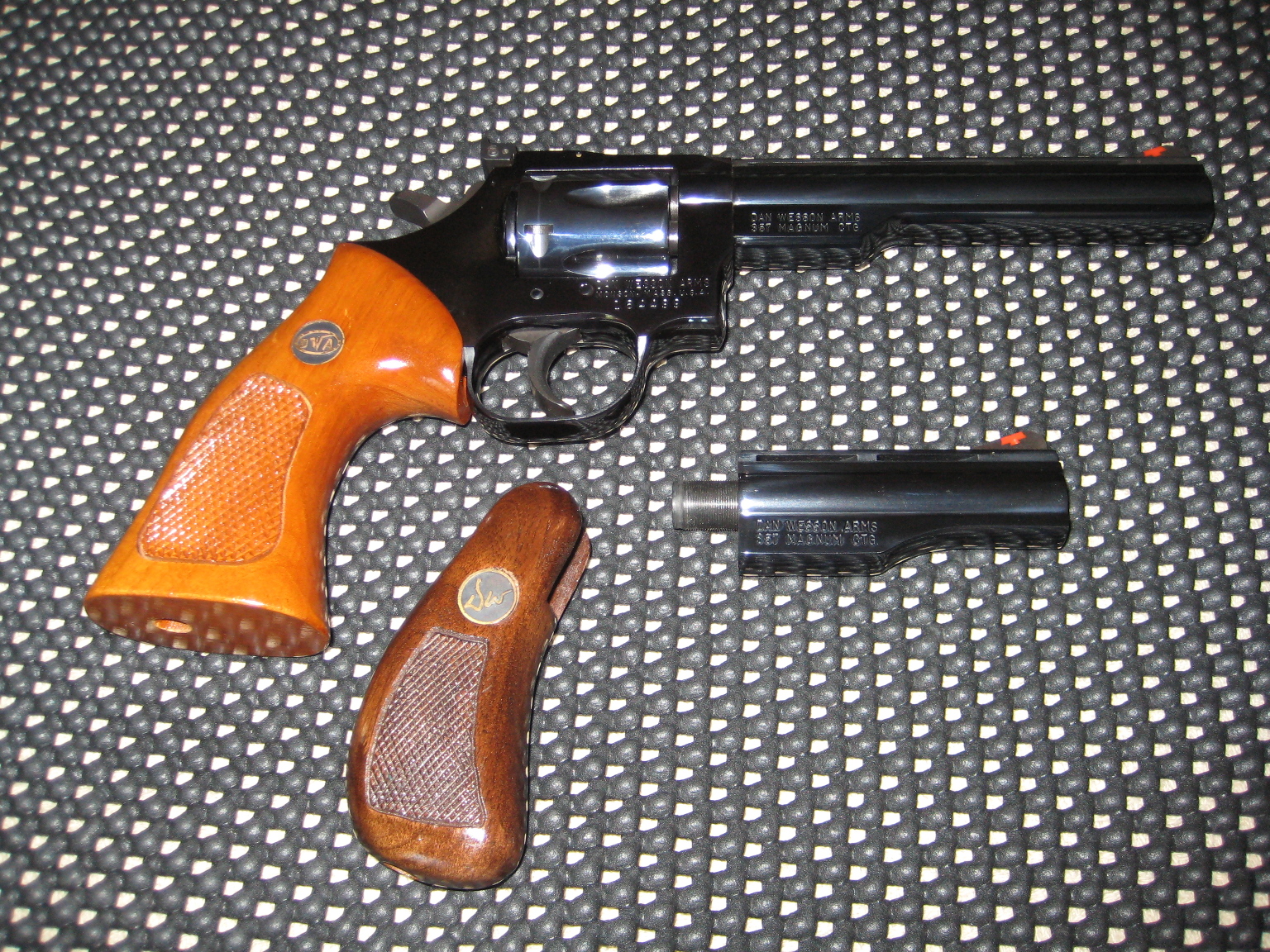

Here are two photos showing my reason for this thread.
The first shows the large and small grip side by side.  While "FBI" is probably not the way DW advertised this small grip, I have seen it referred to as such on the Net (so it must be true...). The 1978 brochure that came with my gun pictures six different grips but not this one, so if anyone can tell me when this grip hit the market and what it was actually called, I'd be grateful.
Anyway, I got this grip because it will aid concealment when I change to a shorter barrel, as with the 4 inch here or with the 2.5 I hope to find.DWF1.JPGImage Enlarger

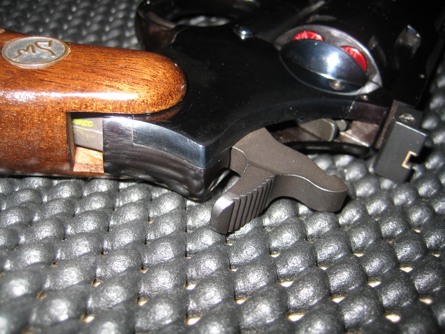

The next photo show the hammer locked into single-action mode with the small grip on the gun.  In order to lock the hammer back, I had to back off the grip screw that came with the square-butt grip, such that pulling down on the small grip created a gap between grip and frame.  Looks to be a 1/4 inch gap, which accords with the difference in length between in the two grip screws mentioned above.

Nice looking DW. I believe the grip you have was/is called the undercover grip. Also the grip medallion with just the DW debuted around 1980 so assuming the medallion is original I imagine the grip came from the same time frame. All of this is just the ramblings of a student of all things DW, and a "C" student at that.big-grin    Bonjour  wink
