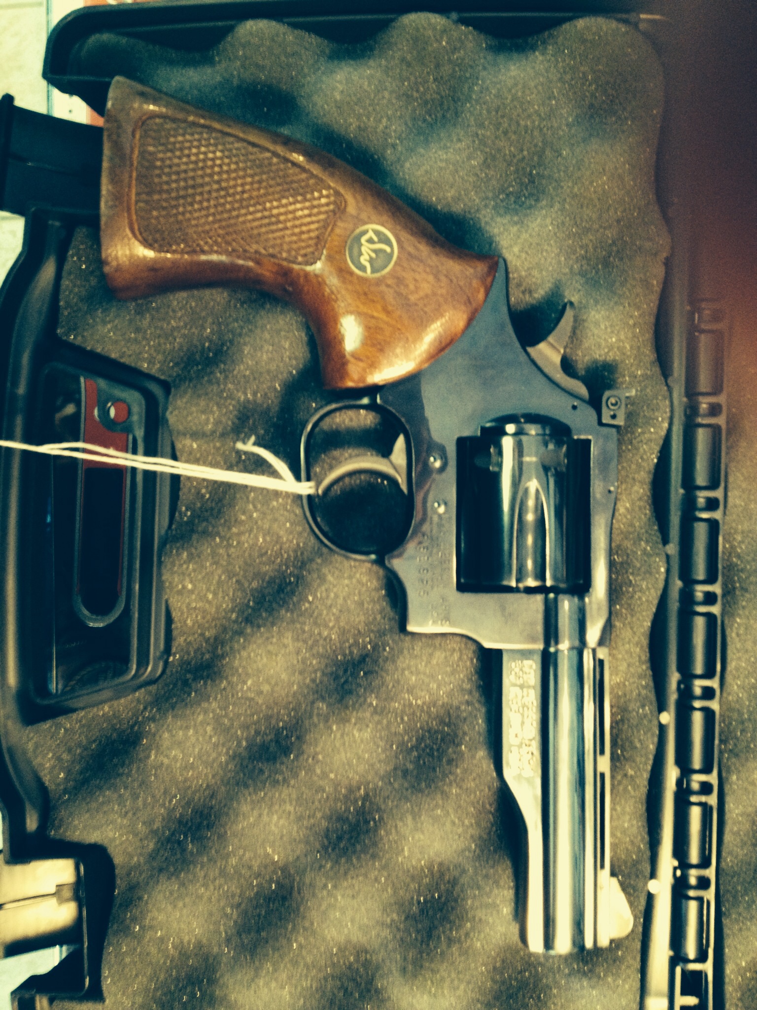

image.jpgImage Enlarger
Appears to be in great condition, except no wrench so I could not check the barrel Nut. Serial is 261925, Monson vintage. Still not absolute but think it is a 15-2. Here is pic. Comments?
December 12, 2013 - 2:24 pm
Nice one. Yup that is a 15-2 V4.
December 12, 2013 - 2:34 pm
Your 15-2 was produced in 1979 and I think you got a very good deal.

December 12, 2013 - 2:46 pm
That's a nice one, the bluing looks crisp and clean.
winkYou have done well grasshoppa !

Thanks to all who contributed. I believe I am going to enjoy this gun and am already looking at additional barrels, etc. BTW--what is significance of V4 designation?
December 12, 2013 - 4:24 pm
The number refers to the barrel (not shroud) length, the letter identifies the shroud type (but a "2" is actually 2 1/2")
