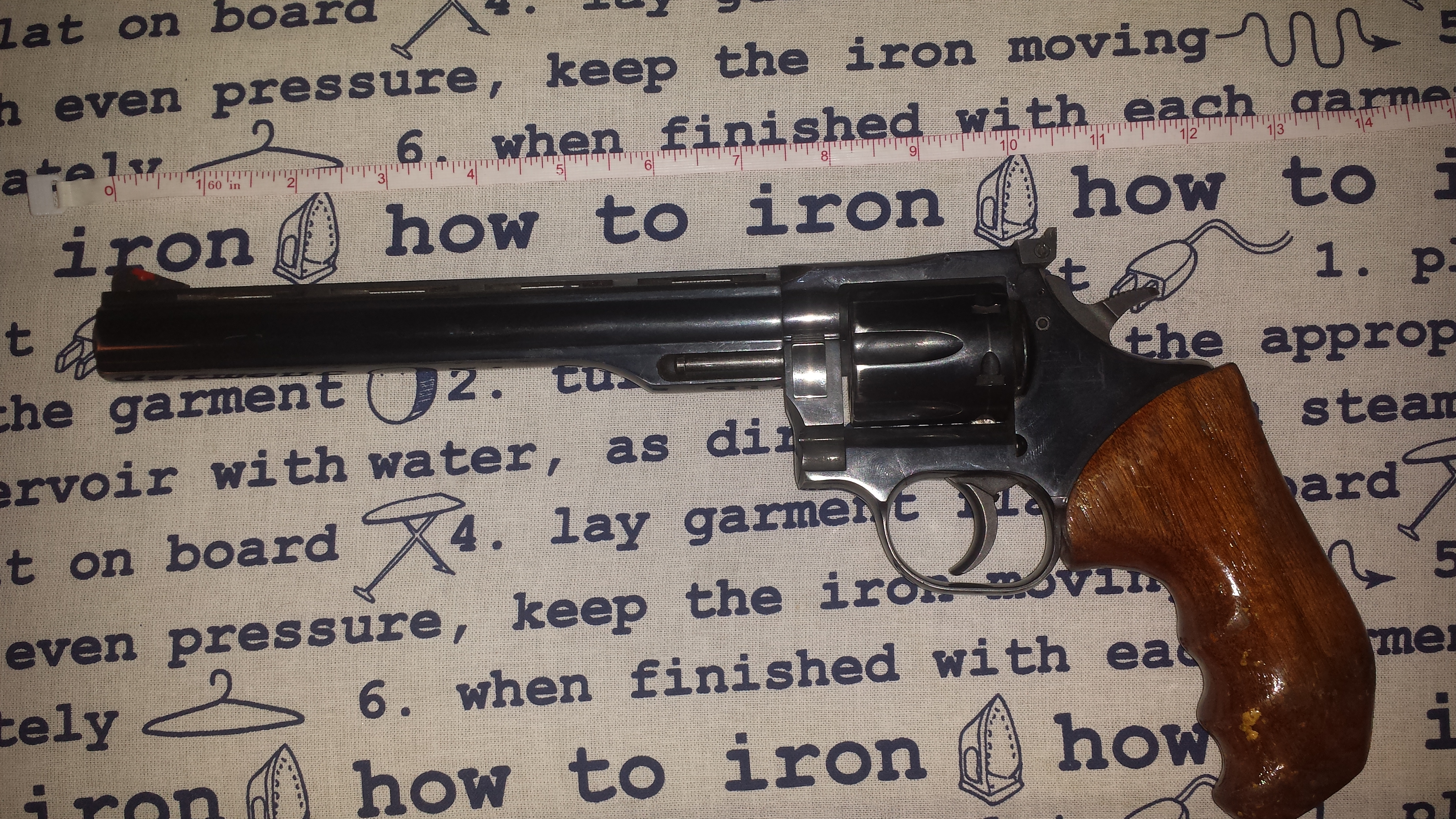

Inquiring your thoughts.   I have not had the opportunity to fire it yet.   A buddy of mine who is and correctional officer said he could take it to their Armour who is a s&w specialist and could do a trigger job on mine and clean it up after making sure all the parts functions properly.   What do you think? 20141020_163516.jpgImage Enlarger

I suggest you clean it well, inside & out, then shoot before having any kind of trigger job done. Smiths are way different than Dans inside. If you pursue the average joe method, which is not at all hard, you probably will not need to do anything else.
In any case, shooting it first will give you a baseline from which to evaluate any work that you or someone else may do on the gun.
I had never disassembled any handgun before I used the average joe method and I had no trouble at all. All my small frames get this treatment now, although I admit that I have not jumped inside my large frames yet.big-grin
Good luck and enjoysmile
October 22, 2014 - 6:12 pm
I second snake-eye's remarks. I also broke my maiden on a dan wesson. Fun it is.  Do not let a stranger near your gun. They may start fileing the action or cutting the spring and ruin it. Dans were designed to not need a smith for most things.
October 22, 2014 - 7:00 pm
I have to third the motion or just say it carries. To quote an Adam Sandler film  " You can do it"...
Trust me, you don't need to let someone else into your gun. If you have too, the send it to the factory first. Heck if your nervous and your anywhere near Shelbyville I'll be glad to help you. The guys who know how to work on Dan Wessons are right here or at the factory. These guys here will tell ya, there are not many DW mechanics and a S&W is totally different animal....
I think that unless your small frame DW revolver exhibits significant functional problems, you would be best served by (in this order):
1) The Average Joe Tune Up, thorough cleaning only
2) #1 with a complete spring replacement
3) #2 with smoothing and fitting of the internal components
Many DW small frame revolvers have gone through various levels of this procedure, the HUGE majority of those guns have been greatly improved by some very basic procedures.
After all of these steps, if the gun does not meet your needs, then a gunsmith. First choice for the gunsmith would be DW in Norwich
No disrespect intended, but being an S&W specialist does not qualify anyone to work on a DW. He may be qualified, I'd ask first if he's ever worked on any DW's

My FFL friend's gunsmith is a master at almost any firearm, but is actually scared to work on dans. That is because there is really nothing for a smith to do. Cleaning and a little smoothing , maybe some Wolff springs or replacing small parts with an inexpensive kit and the gun is like new.You cannot even scratch the sideplate or bugger the screws because of the allen screws. Just remember, snug is good, if it scews in. Don't over tighten.
