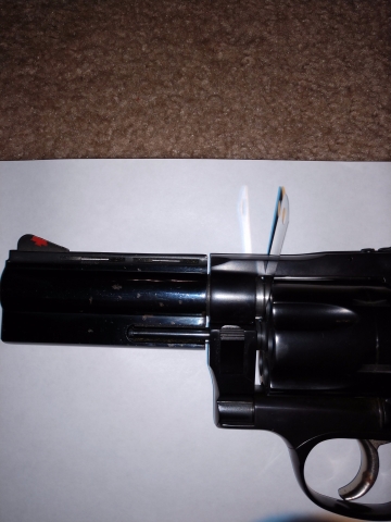

Here's the new 4" barrel. Came in and looks great. IMG_20190131_151248575_LL.jpgImage Enlarger

But now a new issue has arisen. The next barrel has the proper amount of threads. But now that I try the barrel sleeve, it won't flush tight against the frame, because the end of the extractor hits the cutout and won't allow it to draw up. When I tightened it up, the cylinder won't rotate and the crane won't open. Anyone want to chime in and tell me if they've experienced these issues? The right side of the barrel sleeve says, "Dan Wesson 44 Magnum ctg. Just like the other barrels that do fit properly. 🤔

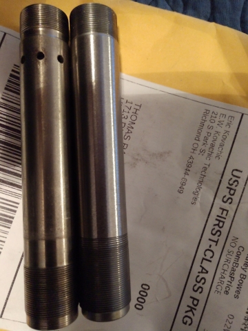

IMG_20190131_222442948.jpgImage Enlarger

Hmmm, this gets messier and messier. First, it is a little confusing. You should refer to the "barrel sleeve " as the shroud. The barrel assembly is the barrel, shroud and barrel nut. My first thought is that you have a small frame shroud but it says 44 mag. Maybe it was made on the Monday after the Superbowl and the machinist had a hell of a hangover. Evidently the shroud was screwed up too. I would send it to Eric at EWK and ask him to set it right. The shroud would have to be milled out for a longer ejector rod and then reblued. I might suspect you had a Supermag ejector rod but you say the other barrel assemblies fit so that can't be. Send it to EWK.

The 8" and the 6" fit perfectly. The slot in 4" shroud is approximately 3/64ths too short, to allow the ejector rod clearance to drop in place. As well as binding the action, if trying to assemble will the cylinder closed. Believe the shroud needs to be milled out more ,or the ejector rod needs to be shorter. Looked on line, but haven't found one, or even two different sizes. Don't want to shorten the ejector rod I have. Contemplating lengthening the clearance of the slot myself, then rebluing the shroud. It does have a different shade of blue, than the frame.

Checked and double checked. Ejector rod is screwed all of the way into the extractor. The overall length of the 4" barrel shroud is 3 1/4", the 6" is 5 1/4", and the 8" is 7 1/4". I don't see anything inconsistent there. The ejector rod slot opening on the 4" barrel shroud is only 1 1/4", but on the 6" and 8" the opening is almost 1 3/8" These two barrels work fine. The ejector rod, screwed all the way in, measures 1 5/16, from the front of the crane to the tip of the rod. The only way the 4" will work is if I have an ejector rod 1/8" shorter or the slot in the barrel shroud is relieved another 1/8 of an inch. Since I really like the 6" VH, (it shoots great), I'll probably have this one on more than any other, but I hate having the 4" and not being able to use it. Could get another ejector rod and shorten it and only use it when I'm using the 4". This may be my best option with the least amount of time and effort.
