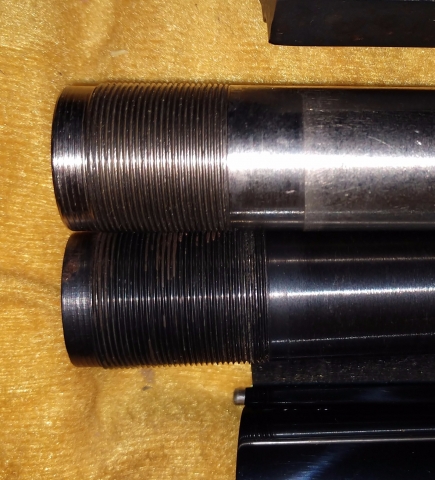

Here is the picture of the two barrels. The one on top is the barrel in question. Why doesn't the threats continue as far as the other?IMG_20190124_230337132.jpgImage Enlarger

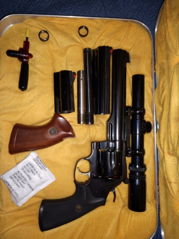

And a better view of the whole shebang...IMG_20190124_230905380.jpgImage Enlarger

I stand corrected. The ports in the barrel don't line up with the ports in the shroud. They're about a half an inch forward of the ports in the shroud.
January 25, 2019 - 5:04 am
Sounds OEM then.  DW may do the threading for you but, honestly, I'd get a non-ported 4" barrel from Eric.  You don't want all that junk flying around inside the shroud anyway...
January 25, 2019 - 8:32 am
I agree with Rwsem, get a non ported barrel.  The power control concept was a good idea, very poorly executed.  They did little to tame muzzle rise and they filled the shroud with carbon, powder residue and bullet shavings, making shroud removal a real chore and sometimes impossible.

Certainly looks like a factory error. Also interesting that it is stainless rather than blue. I agree that it is better not to shoot the "power control" barrel. Get a regular barrel from the factory or EWK. The factory error might be worth more to a collector in the (far) future.cool

Thank you everyone for your in put. Okay I'll go with y'all's advise. Would like to find a barrel only, for the 4" sleeve I have, but I will not be using this one. I believe the frame came with the VH 6". The V 8" ( thanks snake-eye ) and the VH 4" we're someone's attempt to build a set. The V 8 doesn't have the "power control" ports, but is a stainless barrel in a blue sleeve. I fits just fine. I just put the 6" VH on. Think I'll play with this one for right now.

If you use jacketed bullets and clean the inside the shroud every time you shoot it, it will work fine if you get the threads fixed. EWK could do it in a heartbeat.

Just a quick follow up to "Ole Dog's" comment on spacing. He is spot on at .002. I have put enough rounds down wind to get enough heat built up to hinder rotation, but it takes a bunch! By that time you will want to give your wrist a break anyway. I have a few .002 shims made by DW, but I think they were made for prototypes and testing. Never seen one included in a box or a pac.
Also, snake eye caught  the first thing I saw when I viewed the pics. Stainless barrel. Makes no sense, but stuff gets broken up, worn out, and folks just buy what they need and go on. I think the composition of the barrel is a big clue to the difference, but I am not knowledgeable enough to say what it means.
