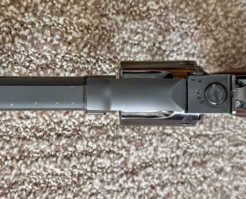

Yes, this is a totally original unmolested W12 frame and barrel. The VH shroud is a much later one, and the grip is a powerwood from 1974 ish. The EWK Arms adapter makes this unlikely pairing possible, and adds a bit of interest of its own. The most interesting aspect is the front sight. I recently purchased a set of patridge sights from EWK Arms in .025 increments. I thought that the “next tallest” one would work well, but I was wrong. Eight inches high at 25 yards with the rear sight all the way down. So, I attached the tallest one, and we’ll see what happens next time at the range. I think it will be okay. In the meantime it’s a very cool looking revolver.IMG_2001.jpegImage Enlarger

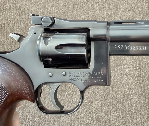

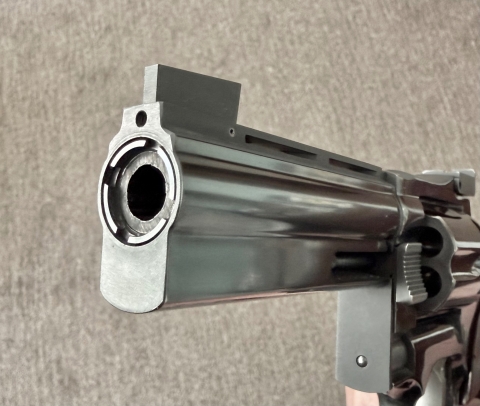

For those not familiar with the adapter, here’s a few more photos. The thickness of the adapter is the same as the depth of the relief notches of the barrel nut, so you end up with a recessed muzzle.IMG_2003.jpegImage Enlarger

Very good looking. I would put on rubber grips to go shooting. Those Powerwood grips do not wear well and yours looks in great shape.

This powerwood grip unusual, I think. I’ve never seen another one that has this color; and all of the others that I’ve seen seem to have a “finish” that does seem to wear over time. Could the previous owner have stripped the finish off entirely, and this is what is left underneath? The closest examination shows no sign of any finish. The checkering is very sharp, but not enough to bite. I don’t see it changing no matter how much it’s used, and I really like the contour and feel of it.

They are plastic.  Whatever you do, don't sand one, the wood look goes away really fast.

So the adapter allows regular shrouds on a pork chop frame?

Yes. EWK Arms has made them in the past, but I’m unsure if he is still making them. I bought this one about 5 years ago.
