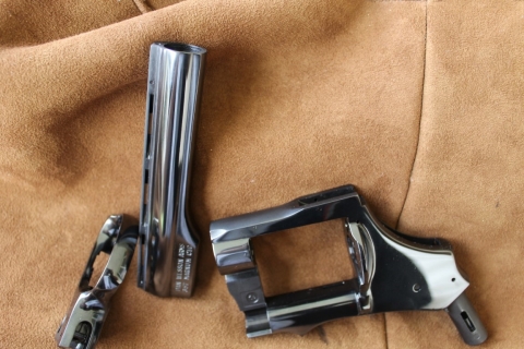

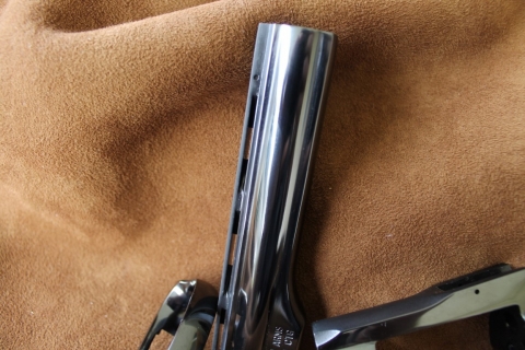

September 30, 2018 - 10:04 am
Eric at EWK did a .357 shroud and .44 frame/trigger guard for me a few years back.
Never seen better bluing ever.
Had to take frame personally as he is not FFL, but a shroud could be shipped easily.
Eric-Blue-015.jpgImage Enlarger
Eric-Blue-011.jpgImage Enlarger

That blue job did turn out very nice.
Thank you for the tip.
