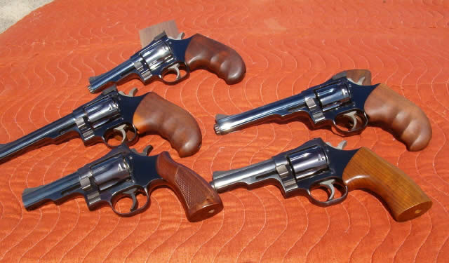

Here's the info on the group shot of 'Chops.Smile

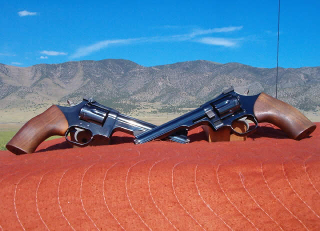

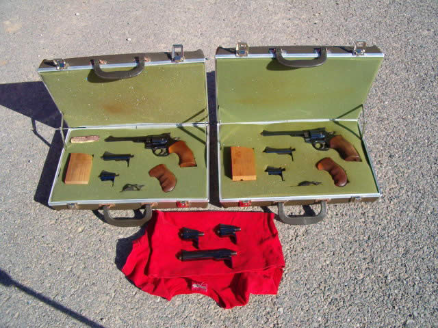

First off are the twins, Ed & Fred. Sequential two digit serial numbered .357 Model 12's made in 1970, the first year of DW production. They were shipped as Pistol Pac's…and so far, have never been fired.
(I'll replace this Pac pic later with a better oneWink )

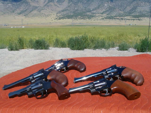

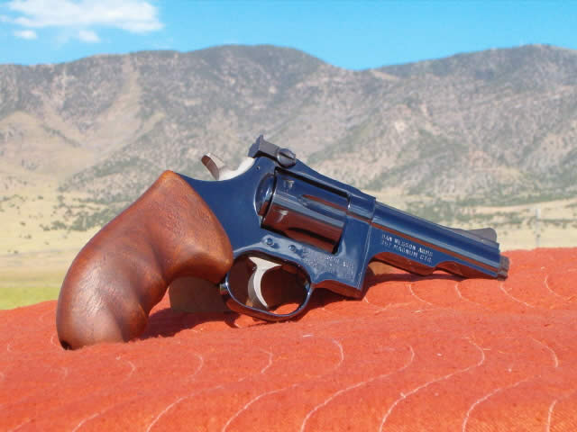

This one's a .357 Model W12. Just guessing, I think this one was born maybe 8~12 months after the Model 12 twins in the previous post, has a 4-digit serial number & is wearing a combat grip.
It's also the the best & deepest shine of the whole clan.Cool

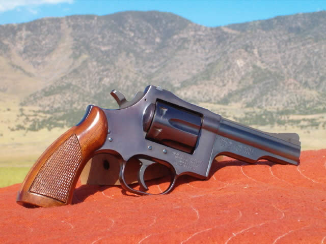

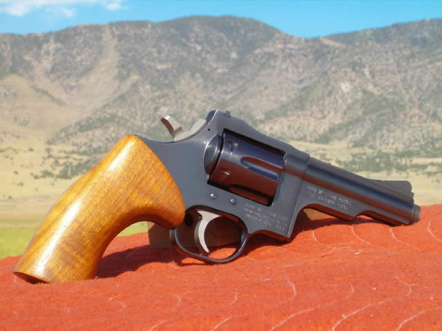

Here's a .38 Special Model D11. I think this one's also a '70~'71 gun…is a service revolver, with target grips, a matte finish, fixed sights & a fixed barrel.
This one's a .38 Special Model 14. A 5-digit gun, from somewhere in the late '74 to early '75 range & sporting a flush barrel nut, which represents one of the first running design changes to the line. This one's a service revolver, with fixed sights, a slim grip & matte finish.

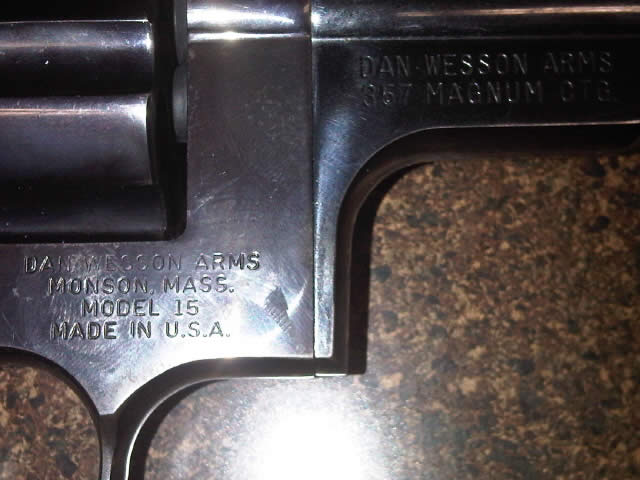

Here's my latest addition to the 'Chop family, a .357 Model 15 with a 6″ barrel.
This is a 4-digit gun, made shortly after the model switch from “W12″ to “Model 15″ & still retains the s/n stamped on the frame under the crane. Later, the s/n moved onto the outside of the frame. At this point in time, I would estimate this as having been manufactured in the '72~'73 era…probably closer to '72.

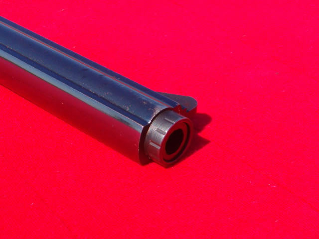

This one's got a unique feature that the others don't share, a smooth exposed barrel nut, with 12 flutes cut into it. The tool from the earlier guns fits, but a 5/8 box end wrench feels like it grabs more firmly.
Another feature is the roll marking on the frame. It uses four lines, as opposed to three on later models. The fourth line was there to spell out “Made In”. This is also marked on the Model 14 pictured above, but that one's a 5-digit gun & has a flush barrel nut.

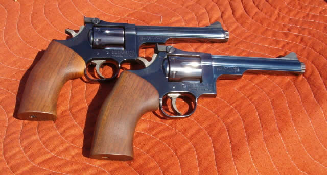

Now we can go back a little further in time and check out the W-12 chop.  Really deep bluing, giant sights, and that beautiful exposed barrel nut....

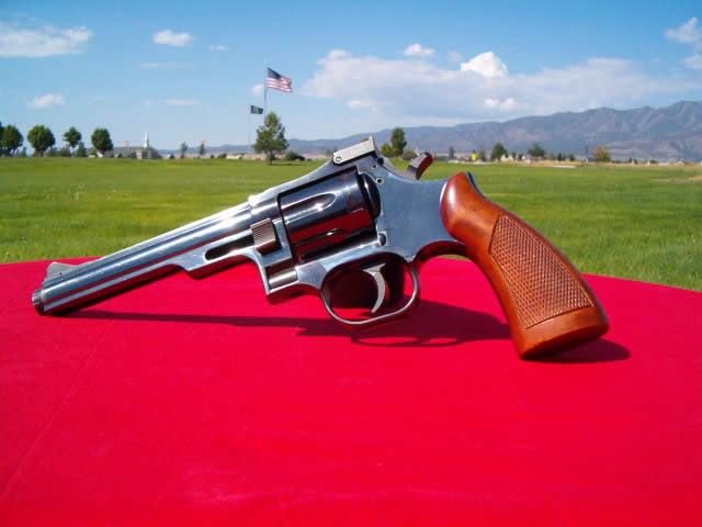

This one below is a Model 15-1.
The features that (I believe) make this a 15-1 are…flush barrel nut, later style crane latch, mushroomed end on the ejector rod, smaller rear sight, s/n moved to the outside of the frame.
