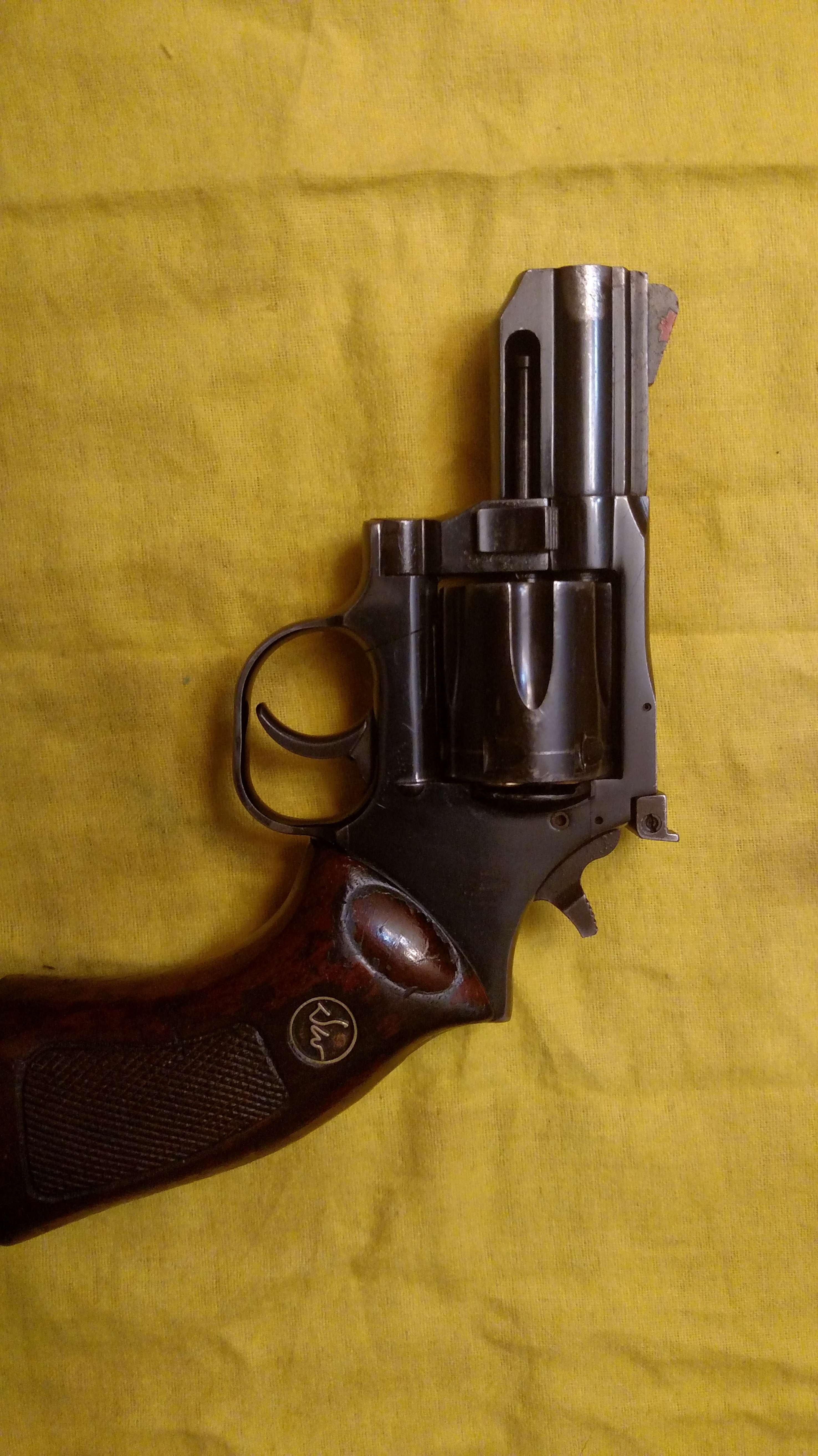

 Got this DW 357 for my wife to have as a home defense gun. I'm putting Hogue grips on it and going to touch it up a little for her. She says the hammer spring is too stiff for her even cocking single action, so I'm thinking of ordering the Wolff reduced spring pak and trying that. My question is, has anyone using these springs experienced any misfires or light primer strikes? Thanks for any help !!

IMO, defensive use of a revolver should be DA anyway. The springs can help with that as well.

I stopped changing out factory for lighter springs a long time ago for the EXACT reason you are asking.  I have NOT changed any springs on My Dan Wessons, but did goof for a while with my Rugers and Wolf Springs and yes, if you put in too light of a main spring you will get light strikes, especially in double action.  If you put in too light of a trigger retrun spring then the gun will not reset properly for a follow up shot.  These are the last things you want in a Self Defense or Home Defense Handgun.  My .2 cents would be your better off just giving the internals a nice polish, no metal removal just slicking things a bit, than changing out springs.  If your wife can't operate the gun then probably better to find a gun she can operate than risk light primer strikes.  Have fun Dan's are fun to take apart and get nice and slick.  I honestly think the design of the large frame Dans to be superior to the small frame Dans when it comes to sweet triggers.

I recommend that if you go with lighter springs, you first make sure to remove all forward/backward movement of the cylinder when closed. Use shims from Triggershims. Otherwise the cylinder movement will absorb the hammer momentum and you could get light strikes. Not a guarantee, but prevention is always good.

I wouldn't use the 7.5lb spring but I've had good luck with the 8. I have not had any issues with the lighter trigger return spring. Clean and polish the surfaces when you are in there.
