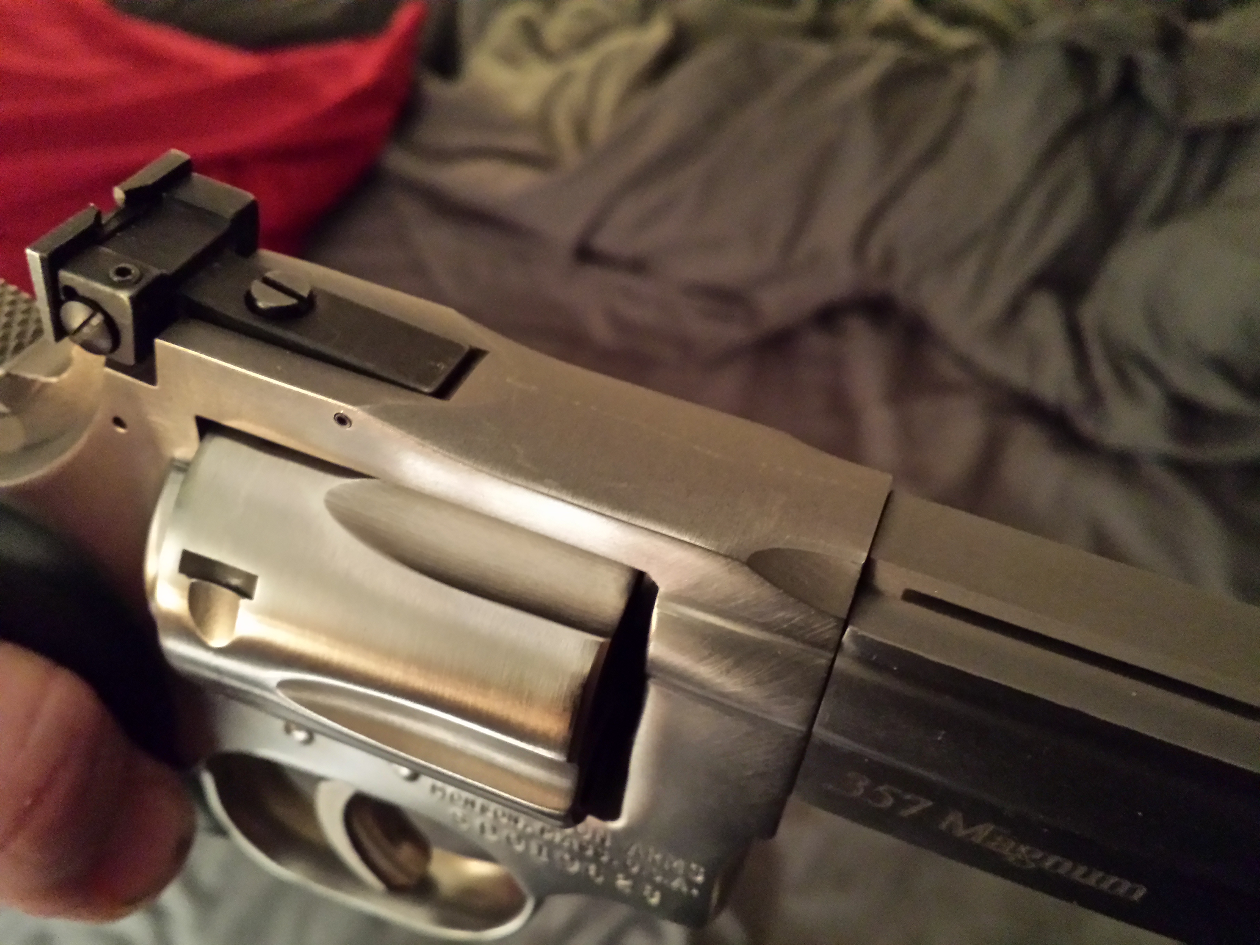

I own a older 715 and just can't shoot for crap with it.   Lets say I just shoot about 10 yards and aim center target but I'm always shooting high like 6"-8" and I even bore sighted the gun.  So the question is where do you guys hold your front sight on a target?

Everything is snug on the gun although the rear sight the main screw on top that adjusts the height kinda sits high not flush to the top of the sight.  Don't know if that's normal.    My sight picture I try and keep the front sight level with rear and keep the front sight just below dead center of target which I thought was a 6 o'clock. Am I wrong on the 6 o'clock hold?  And I have shot from a bench and offhand with the same results which end up high.  The front sight is the EWK fiber optic and that leads to another question.  I see some photos on here and some guys have that sight on backwards or what appears backwards to me why is that?

I'll second everything Bruce said and add that in addition to a tight barrel, make sure the gap is set properly to betwee .004-.006".  Can you post a few pics of your gun?
20160110_180242.jpgImage Enlarger
20160110_180200.jpgImage Enlarger
20160110_175959.jpgImage Enlarger
January 10, 2016 - 10:15 pm
Since you say you are shooting high, I'm thinking the front sights may be low causing you to tilt the muzzle up to align the blade with the rear notch.
BTW your technique seems fine, I'm going with a sight issue.
I have a 1911 with a front fiber optic sight and I'm always high with it for the same reason.  I need to get a sight press to remove that one, but you can replace yours with an allen wrench.
Is that front sight seated all the way?  I would suggest maybe try swapping in a different front sight blade, one that is taller like the stock ramp blades.
Can you see the rear sight move up and down when you turn the elevation screw?  Also, does it stay put when you are shooting?

I agree about a taller front sight that was my next purchase.  And I think I know what the problem might be is I purchased the newer 6" barrel and Shroud from CZ/Dan Wesson few months ago.  If you will notice in the pictures the newer shrouds are slightly smaller and you can see that where the frame and shroud meet.  I'm thinking that might be the problem cause I've lost height in my front sight.

Rear sight seems to work fine and moves accordingly when adjusted.  But the screw never sat flush so I don't know if thats normal or not cause I bought this gun used a year ago.  Other then that the last time I shot it which was last weekend I put 10 rds thru it and had hand sized groups but high.  I lost patients with it and quit wasting rounds until I can get it figured out.  And thats why I'm gonna try a taller front sight like Scorpio suggested.

I will add that I have several Dans that had to have taller patridge front sights to bring the point of aim in line to adjust for a particular revolver.  This may be one of those revolvers needing taller front blades.  While I think the fiber fronts look cool, I have yet to have a Dan shoot where I want it while wearing one.
