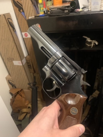

Good afternoon everyone,
I am interested in purchasing my first revolver and came across an individual selling a DW 4 inch .357 revolver. He states he thinks it’s a 15-2 model. I have attached the photos I have of it.
what do you think I should pay for something like this. My only other familiarity with Dan Wesson are the 1911 lineup which I’ve always regarded as being very pricey and finely made! Thank you all for the assistance.
February 22, 2020 - 9:52 am
Yes, it is a model 15-2 with a Standard 4" shroud ... $550 to $750 depending on condition and accessories.

February 24, 2020 - 12:17 pm
well I decided to make the dive in the revolver. I was able to negotiate it down to $400 bucks shipped to my FFL which was pretty awesome. I’m excited to get the revolver, just praying it isn’t a crapshoot. I’ll update once it’s in my hands.

February 25, 2020 - 2:34 pm
Some hopefully helpful info:  When opening the cylinder, hold gun in your left hand; use your thumb to pull down on the latch in front of the cylinder; at the same time, use 2 fingers to push the cylinder open to the left. If you don't push with your fingers, you will think the cylinder is stuck because your thumb is pushing against it in order to pull the latch down.
It looks like your side plate is unmarked. That's great!  To keep it that way, keep your fingers on the cylinder to hold it open while you use the ejector to remove spent shells. If you let the cylinder fall back toward the frame before the ejector star is fully retracted you will have some nasty scratches on your side plate. These scratches are very common on used guns.
