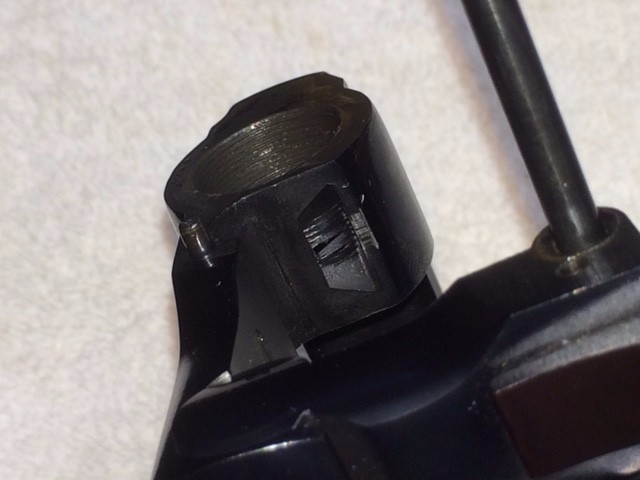

what has happened to this .44 frame at the crane notch?
pasil
Forum Posts: 7
May 28, 2016
December 23, 2016 - 2:32 pm
Hi all- can't figure out what has gone on here.  The frame where the crane latch notch is has worn through to the barrel threads.  It looks like it could be factory or done by a gunsmith?  It is a Monson gun with a 3XXX serial number.  I have another .44 Monson (bottom picture) that looks completely different but is a 13XXX serial.  This was a gun show purchase and I didn't look carefully enough- still seems to lock up ok and the barrel threads fine- safe to shoot or a parts gun?serial-3xxx.JPGImage Enlarger

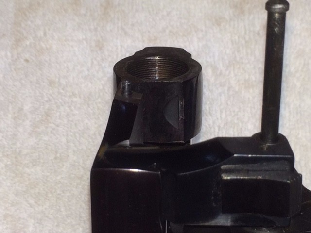

2nd-serial-3xxx.JPGImage Enlarger

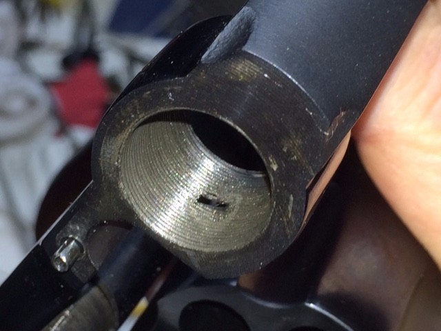

serial-13XXX.JPGImage Enlarger

I'm going to guess it was a hack job to try to correct a latch issue, rather than disassembling and replacing the spring...  I'd shoot it- plenty of barrel steel to take care of pressure.
December 24, 2016 - 1:13 am
Ron's diagnosis makes sense.
pasil
Forum Posts: 7
May 28, 2016
December 24, 2016 - 10:08 pm
Yep- I agree with you guys.  It looked so planned out with the beveled trapezoid that I thought maybe it was some known modification or something.  Not sure why they would have gone so deep, seems like just a tweak would work if you were going that direction- very strange all around.  Bummed that I missed it- buyer beware and all.  Merry Christmas everyone and straight shooting in 2017!
Forum Posts: 5437
December 25, 2016 - 5:55 am
Aesthetically, it leaves some to be desired but functionally, it's just fine.  The majority of the pressure is absorbed in the cylinder before ever getting to the barrel.  Enjoy shooting it.
