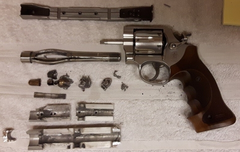

I got a revolver from a customer once that wanted me to check the batch of the barrel I put on his revolver. It "got open" for some reason and he wanted a rework of the job..... for free of course.
The reason for fixing his revolver was a bulge caused by a .38s that got stuck and a second .38S that worked quite alright (my interpretation of what happened). I made him a really nice PPC R1500 revolver with an exchangeable barrel. He called me after the first test and said that something was wrong with the barrel.
When I got the revolver back, I had a quick look and then called him and asked what ammo he had used. First few cylinders was the same .38S that he had before.... hmmm... and then some .357M, but he was unhappy because the barrel broke after "a few rounds".
I opened the barrel to examine what could have happen. I found (from the dangerous end...) 3 copper plated 158 grain bullets, one 158 grain bullet that seemed to have been jacketed and one 158 grain metal jacket bullet. my interpretaion of the case is that he first shot a cylinder of .38Special of the "not so well working" batch where the third or fourth bullet got stuck. After finising that cylinder he reloaded with .357Magnum and shot one or two round before he realized that there was a problem with "leaking gases". Funny thing is that the cylinder is unharmed.

I found the pic of the revolver I got back from a customer for "minor repair".MarTin.jpgImage Enlarger
February 12, 2019 - 7:58 am
Looks like a Warranty job to me ... laughing
Forum Posts: 1697
February 12, 2019 - 10:11 pm
Wow, what a mess lucky no one got hurt.
Bull
Forum Posts: 7
January 17, 2019
February 28, 2019 - 3:12 am
Of course it was a warranty job 🙂
pops2
beavercreek,oregon
Forum Posts: 813
March 25, 2008
March 1, 2019 - 4:43 pm
the answer to thr question that no one got hurt, is that they started out brain deadpokescrewy
I hope you were able to rescue the bullets and reload them... at least?
Cool pic...thanks for sharing it!
