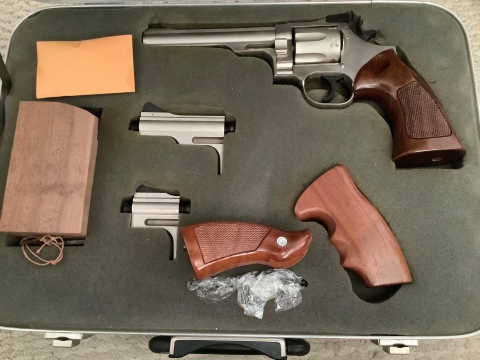

Congrats on landing your first Porker, looks like it's in pretty decent shape. The serial numbers on the very early ones were on the grip tang, I forget when they were moved under the crane.
Brothers-3.JPGImage Enlarger
This is what the grips would look like minus the finger grooves.
HPIM2298.JPGImage Enlarger

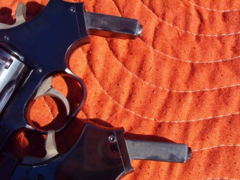

 Charger Fan, I think you and I are porkchop lovers. My latest model 12 had serial number 30xx on the tang. I was surprised it was so high a number. I thought it was probably in the hundreds. It also has a interior barrel nut but that could have been a later addition.
May 7, 2023 - 11:16 pm
Oh I am definitely a Porkchop lover, see below. That was from one buy. smile
If your latest Model 12 has 30xx on the tang, then Needsmostuff should pop the grip off to see if a number is stamped on the tang. That number under the crane may be something else, because from the pic, I only see 3 digits.
HPIM2296.JPGImage Enlarger

Thought I would show my 15-M nickel pistol pac….again, was in a earlier post
i am also a fan of the pork chops
DCD380B0-1649-439E-85AB-8B85C234AE1C.jpegImage Enlarger
