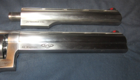

I don't know the weight specs but they are about the same. Both have the under lug cut off but the length is the same! Also you will see some barrels that do not have the vent cuts on top. If you have a 10V there will be 5 vents, and going down an 8 inch barrel will have 4 vents and so on. Of course the non VH barrel will be lighter. The pic shows my 44 mag next to a 357 max which is a large frame gun similar to the 44. Don't let the 357 part throw you it's really as big or bigger thanIMG_6815.JPGImage Enlarger
a 44 mag as far as the shrouds go!

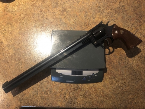

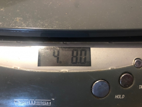

IMG_7386.jpegImage Enlarger
IMG_7387.jpegImage Enlarger
15-2 with 15” BA and empty cylinder = 4 lbs & 8.0 ozs
