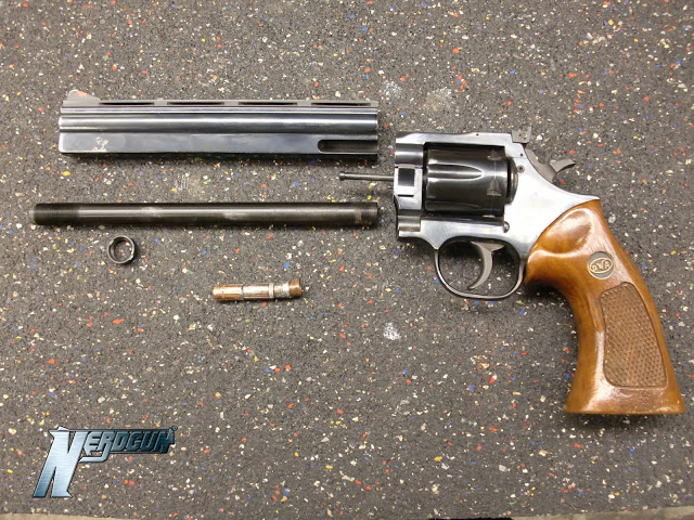

 Below another example of a 357, this time the barrel didn't even bulge.
Chan-Dan-wessonKB01.jpgImage Enlarger

I have seen the same article and will look for it too! I also saw something about DW's having a choke bore!
If the 357 does not go boom something is a miss!

Kind of hard for me to imagine a .357 with no recoil and not much noise. Hmmm, maybe it didn't go off? I'll just shoot a couple more...screwybig-grin
