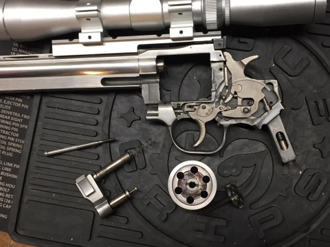

Well I made things worse. I took the side plate off, took some pictures and added a very slight amount of oil. I wiped the oil off so it just had a very fine coat. I put it back together and now about 50% of the time the trigger does not return. I took it back apart and compared the pictures and I don't see any issue. with the side plate off everything appears to function correctly. I re installed it and again 50% or more of the time the trigger sticks. ideas of what to check?

ok it is working better now. i took it back apart and lubed it a little better. making sure to get all surfaces that slide against each other. once I was happy with that i worked the action a dozen or so times without the hammer spring having tension on it. then I put it all back together. it is a lot smoother now then before and the trigger isn't currently sticking. I think it is mostly due to just not being used and still being a little stiff.
January 11, 2022 - 5:26 pm
Glad to hear that, I’ve never had a Dan apart so I didn’t know how to help.  I saved a copy of your picture of the internals so I’ll have it for future reference.

Why does your trigger return spring look so thick? 😂
Here’s a photo when I had my 722 apart.

Some trigger return springs are the square looking wire and some are round. I have found no rhyme or reason. I have taken apart and polished many dozen Dans and often the trigger spring acts up in the beginning when you put it back. Maybe it isn't seated right against the trigger or it is getting stuck on some rough metal of the frame or sideplate. Eventually it starts working right. The factory spring tends to be scratchy. The single best thing you can do to improve the action in my opinion is put in Wolff reduced power springs. The 8lb mainspring is the one to use  but it is the Wolff trigger spring that makes most of the difference. Very much smoother and quieter.

I have no idea… maybe partially due to the close up photo. Maybe this one was thicker or has been replaced. I have never opened one before today.
  Re Ron's suggestion about toothpaste. Crest used to make one with hydrated silica (minescule marine fossils) as the number one ingredient. That is what does the polishing. They seem to have discontinued it. They do have a type with the silica as the number 2 ingredient. Don't use gel, paste is what you want. I have one unused tube of the discontinued type I am saving for a special shooter Dan. I found some on ebay a while back after the stores no longer had it.
Thanks. I didn’t take the spring out when I first put it back, but I still might have had something kid aligned. I have a spring kit on the way just have to wait for it to get here.
