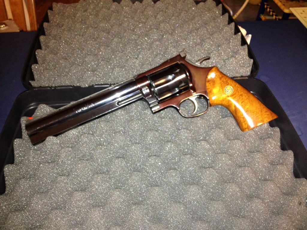

I bought a DW40hv 8" 357 maximum it was in exc. condition. I read on multiple sites that you can safely shoot 38spec. And 357 mags from this pistol, so I put 6 rounds of 158gr 38spc through it and afterwards I noticed it wore the bluing completely off the front end of the cylinder. It's only about a 16th of an inch but it's noticeable and really upsets me. This was the best looking gun I've ever seen before I shot it. It also looks like it slightly cut into the upper frame strap. Images is to shoot it now in fear of damaging it any further. I'll check the tolerance of the forcing cone as soon as I find out what the specs are, I can't see daylight through it and didn't expect it to be a problem, hind sights 20/20 I guess. Has anyone had this issue??? Any info would be greatly appreciated. Thanks!

November 11, 2013 - 12:36 am
image-5.jpgImage Enlarger
image-6.jpgImage Enlarger
image-7.jpgImage Enlarger
image-8.jpgImage Enlarger

I'm not imagining any of these anomalies I can assure you, I shot factory loads out of it and only 6 rounds. The first pic is prior to shooting, the rest post being fired.
November 11, 2013 - 1:30 am
Nice clear pictures, nice gun, great grips. There is no way shooting .38 spc. or .357 mag had anything to do with either issue. If you looked closely before shooting with an eye out for flame cutting than I would suspect a cosmetic job on both areas. Still a very fine gun.Barney going on(plum color) which seems quite common on mod. 40.
November 11, 2013 - 7:04 am
I can clearly see the line on the top strap in the 'before' pic, which I have seen on all the supermags I've looked at that have been fired much. Iits normal and not anything you did and its certainly not a problem or anything to worry about.   On these guns the cutting became self limiting in most cases and went no deeper than a few thousandths of an inch.  I'd imagine someone touched up the line and the other bluing issue with some bottle blue prior to selling and when you fired and then cleaned the gun it was removed.  Again, sort of normal wear and tear and not a real problem.
BTW nice pics of a nice gun.

Forum Posts: 5445
November 11, 2013 - 8:32 am
Using your fingernail, scrape along the cylinder from rear to front.  If you feel a raised edge at the discoloration, it is carbon/ lead build up.  This looks exactly like your picture.  I use a Birchwood Casey lead remover cloth to clean lightly when that occurs on my revolvers.
If you close the barrel gap, that should reduce the amount of buildup.
Regards, Ron
