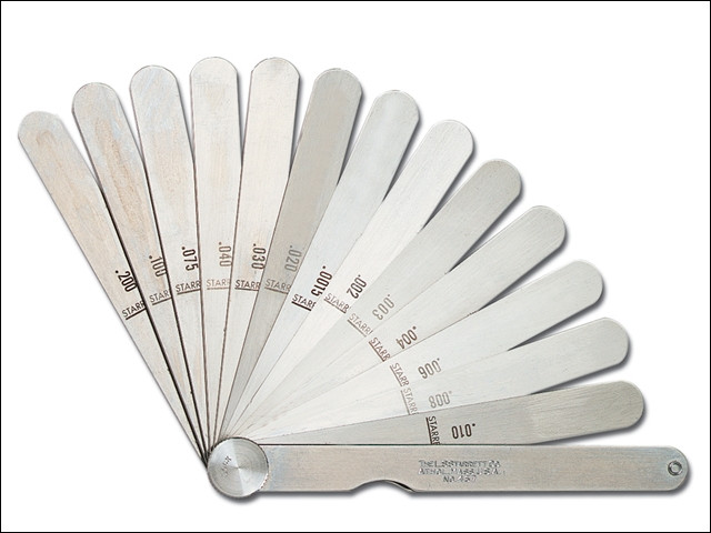

This revolver would have originally come with some kind of barrel assembly/removal multi-tool either metal or plastic, and a feeler shim for setting the barrel to cylinder gap. The metal barrel removal tool is more durable than the plastic one, and less prone to breakage.
You can also use an automotive feeler gauge tool to set your barrel to cylinder gap, if the shim has been lost.
Feeler-Gauge.JPGImage Enlarger
If your revolver doesn't come with a barrel removal tool, you can purchase a used one from Ebay, or a brand new metal tool from EWK Arms on the side banner.

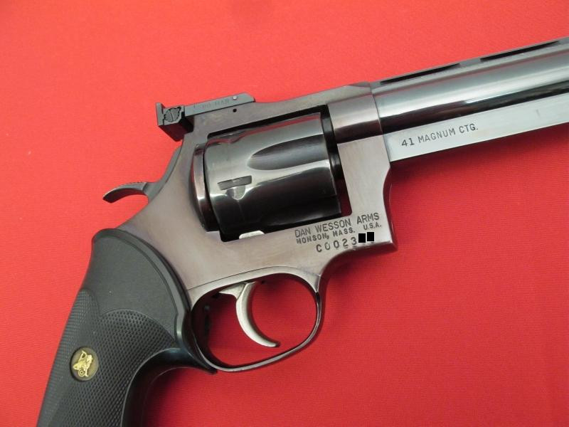

The serial number will be found on right side of the frame, on a 41 Magnum revolver. Just like in the image below, where the serial number is C0023XX
DW-41-Magnum.jpgImage Enlarger
The 41 Magnum pictured above has a heavy full-length underlug, and Ventilated barrel shroud. (The lower underlug runs the full length of the barrel shroud) It would be abbreviated as VH, for Vent Heavy on the box.

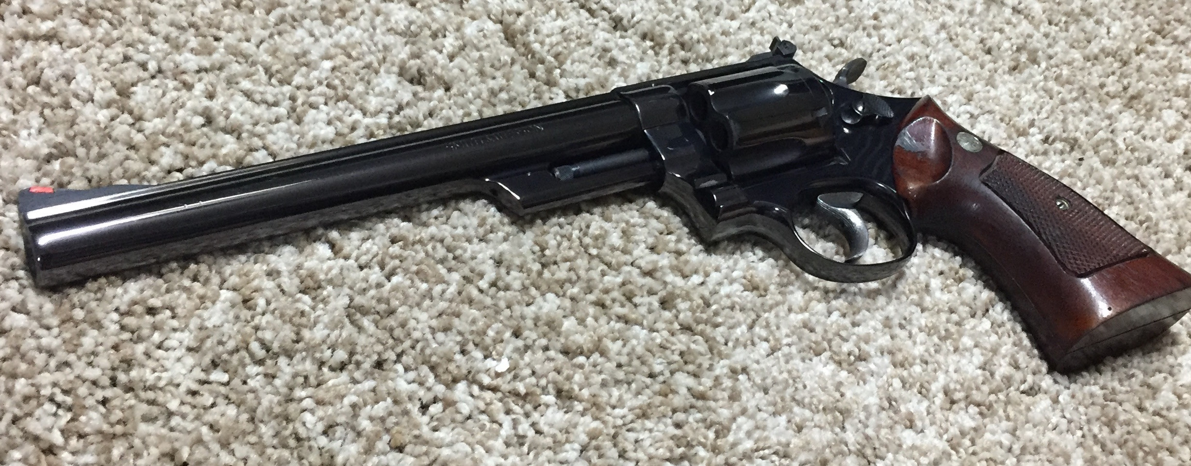

In closing, I'll share a picture of the Smith that is temporarily in my safe.  It's a Model 57-0 from 1974.

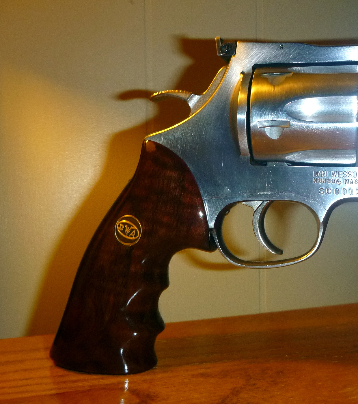

January 11, 2017 - 6:17 pm
P1030398.JPGImage Enlarger
He maybe an "ornery cuss", But he makes some BEAUTIFUL grips!!!!!

Is it just me or does this grip look extremely thin and small?
bikeridertim
Concord NC 28025
Forum Posts: 389
February 16, 2013
January 12, 2017 - 6:38 am
It must be the angle of the photo, it's as big if not a bit bigger than the original shown in my signature! 🙂
January 12, 2017 - 6:59 am
It is a well known phenomenon that the angle can make an object look smaller than it really is😆
January 12, 2017 - 10:32 am
That is gorgeous !  drool

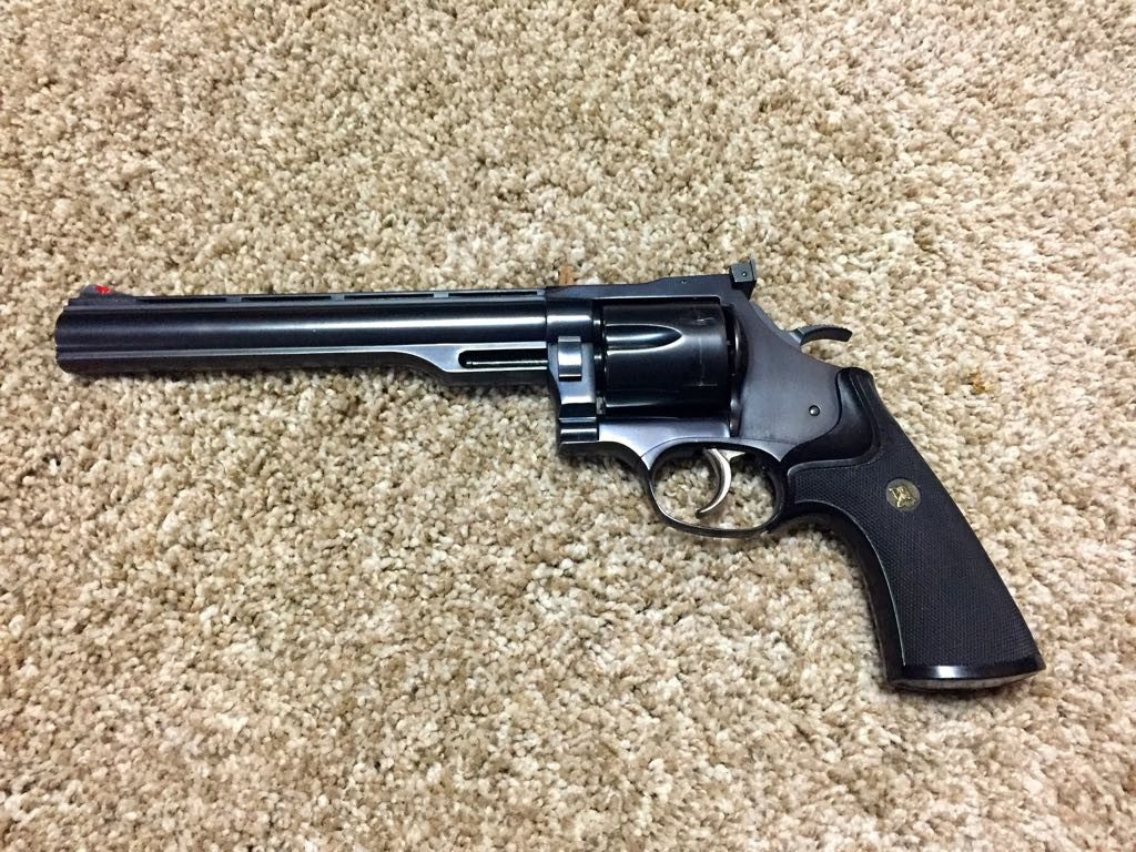

January 14, 2017 - 4:57 pm
Loose the Smith already and getcha a nice Dan 41 !
Since you made such a compelling argument, okay.
Dan_41.jpgImage Enlarger
January 14, 2017 - 6:40 pm
Beautiful 41-V8 .. you will really enjoy shooting that baby, I've got one of my own.

January 22, 2017 - 11:01 am
Took it to the range yesterday.  It shoots like a dream.  Better than the Smith, in my opinion.  Felt recoil is less.  The single-action trigger is smoother.  I like the double-action trigger better, too.  I like the sights on the Dan better.  All the way around I like it better.  One drawback IMO is the angle on the hammer; it's a little lower, so cocking it to shoot single-action is a bit tougher.  Return to target is a bit longer because of it.
Overall, I am really happy with my purchase.  The Smith seems to shoot a little left.  I've adjusted the sights a couple of times, and it has helped, but it still has a left-ward tendency.  The Dan is smack dab in the middle of the target.  It's a little high, but that is easier to fix than left or right.I've got an Uncle Mike's holster.  It's worn the bluing on my Smith, and I don't want to put my Dan in it.  I see in another thread some recommendations of leather holsters; how do those treat the finish?
