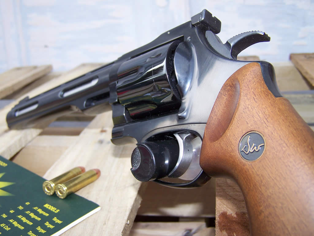

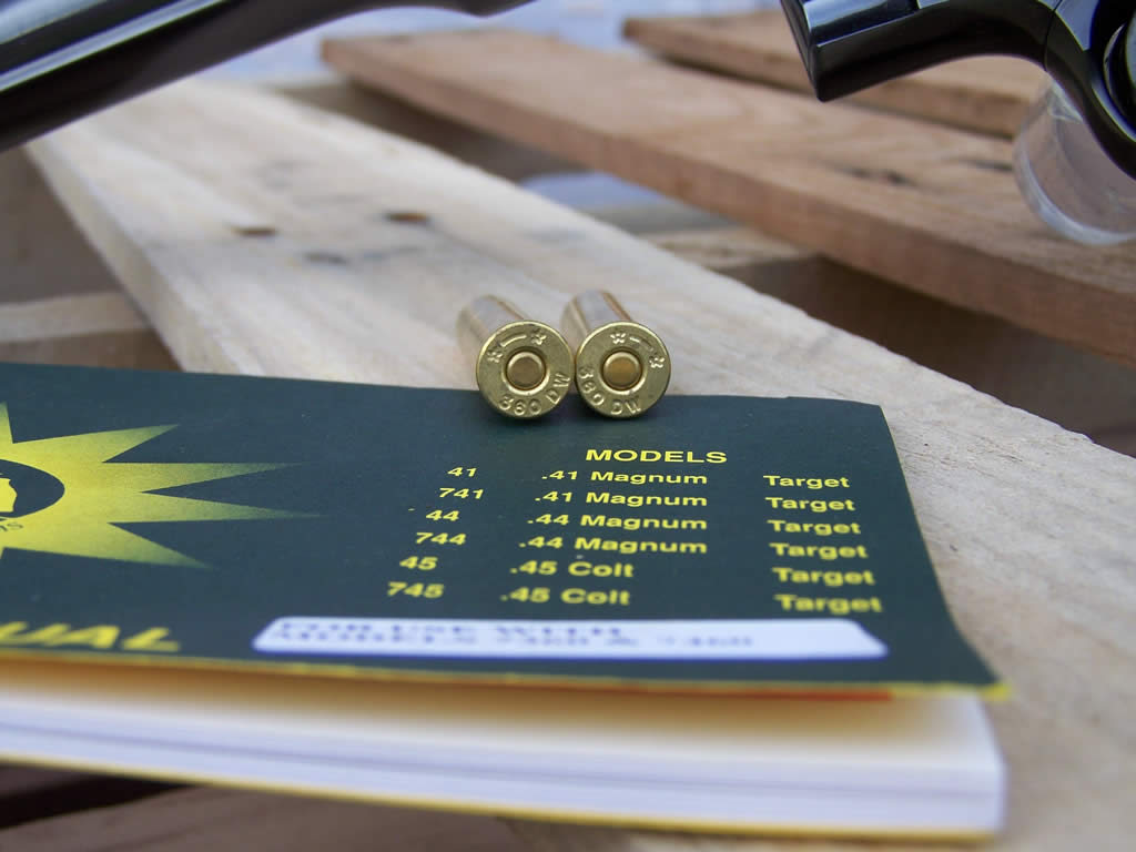

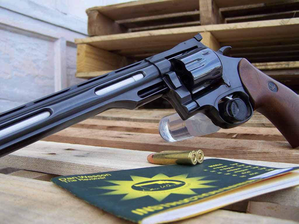

Here are some 360 pics of one I had.
February 13, 2012 - 10:08 pm
drooldrooldrooldrooldrooldrooldrooldrooldrool
