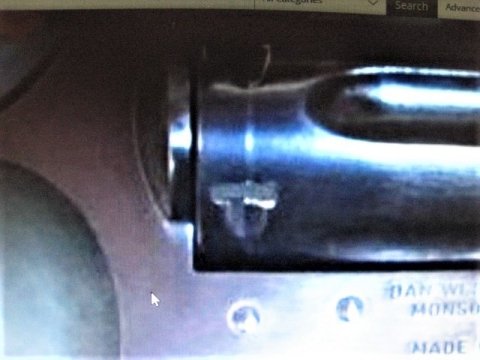

The "new" 15-2 frame I bought has peening on the opposite side I'm used to seeing it on other revolvers. It is present to a much lesser degree on my other 15-2. It appears on all the notches on the same side. No peening on the side you'd expect it from much use or speed shooting. It seems to be a very little used frame and the rest of the cylinder is perfect except for a very light drag line. The gun shoots very well and all the chambers line up with the barrel when I inspected with a bore light. It doesn't shave lead. It locks up tight and just before the hammer breaks. The locking bolt shows no signs of wear. What do you more experienced DW owners think is the cause? I'm wondering if the bolt is a little thicker on the side where the peening is occurring or a timing issue but that's just my guess as a novice.IMG_1097.JPGImage Enlarger

I have never seen that on any of my Dans and I have many dozens. Granted, a lot have not seen much use. I have many more blue guns than stainless and the steel is a lot harder. I would call the factory and ask them. Sounds like a trip home. BTW, I, am a real person. Lol.

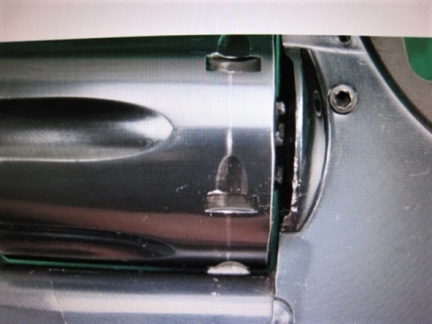

You're my go to guy for good advice, so I agree contacting CZ/DW is a good idea. I inspected photos of DWs currently on GB and there's at least two with a similar issue although they're more worn than my frame/cylinder.IMG_1103-2.JPGImage Enlarger
IMG_1105-2.JPGImage Enlarger
August 25, 2020 - 4:42 pm
I checked one of my 15-2's and it has similar wear on every slot. I think it is a result of the bolt sliding over the edge of the slot as the cylinder turns and gradually wearing down the originally sharp edge rather than peening. My DW does have a significant wear line on the cylinder.

Thanks for the input, snake-eye. I tend to be a little anal about inspecting a "new"used revolver and maybe it's just cosmetic and won't get worse. I might not have noticed if the cylinder had been more worn but as it is it jumps out at you when you look at it. When locked up the cylinder has no play rotation wise and very little end shake. If it's just wear from snapping into the notch, I don't know why it's peened over(creating a ridge) only on one side which I'm able to catch with my finger nail when I drag it across. Two of my well worn LE trade in model 10s have peening on the other side of the notch where you would expect it but not there. I'll contact CZ/DW with a photo to see what they think. I just don't want to further bugger up a very nice cylinder.
Forum Posts: 5437
August 25, 2020 - 8:47 pm
All of my blued DWs (more than a few) have some degree or another of the same wear.  I'd say completely normal...

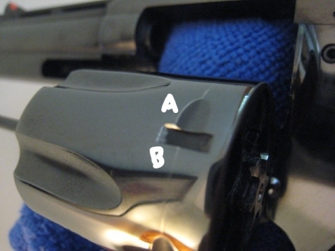

Ole Dog, I realize my S&W and Rugers rotate counterclockwise To be more clear: my worn model 10s have peening on side "B" and my DW has peening on side "A" . For lack of a better term, the "ramped" side of the notch the bolt slides down to get to lockup is where my DW's peened and the M10 is "opposite side." I'm beginning to think it's normal to some degree.IMG_1097_LI.jpgImage Enlarger
