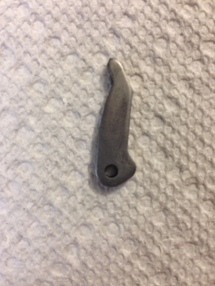

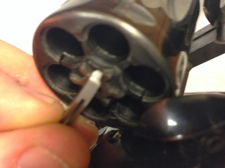

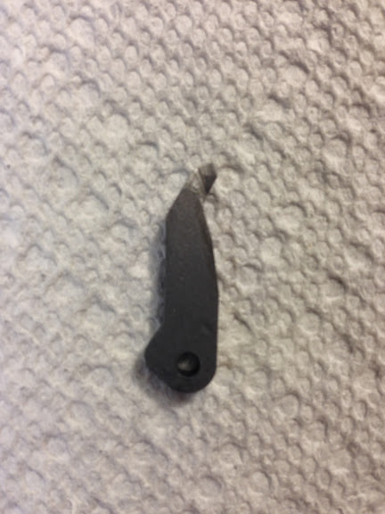

I'm far from an expert on the subject, but I just went through an issue with an out of time DW 15-2 that I purchased.  The hand in the gun when I bought it had been filed down on top which is NOT where you want to fit it (as I found out when I made the same mistake with my replacement hand).  A brand new, unfitted hand will function, but you will feel some resistance as the teeth on the rear of the cylinder drag along the unfitted hand.  Eventually, if the hand is harder than the teeth, I would suspect that it might wear down the teeth on the cylinder. You want to fit (file and stone) a notch on the upper right edge of the hand.  You want it to push the cylinder into position, then clear the tooth and slide out of the way without any drag.
Left side of the hand
Right side of the hand.  Notice the notch that has been filed/stoned into it to clear the cylinder tooth.  I ruined this hand by taking material off of the top of the hand before I realized I needed to just clear the tooth after the cylinder had been rotated.
This is how the groove and the tooth interact.  Sorry I couldn't get a better picture, but you try this solo with just an iPhonebig-grin

Thanks for that info hAkron. I knew that the hands were filed on the one side but was not sure why. The first hand I tried to fit a few years ago would not function without fitting. Unfortunately I made the same mistake by filing the top down and ruined it. Live and learn.
