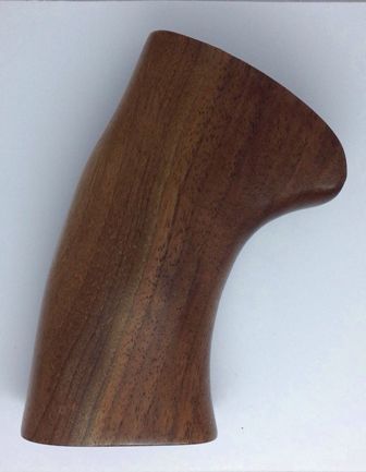

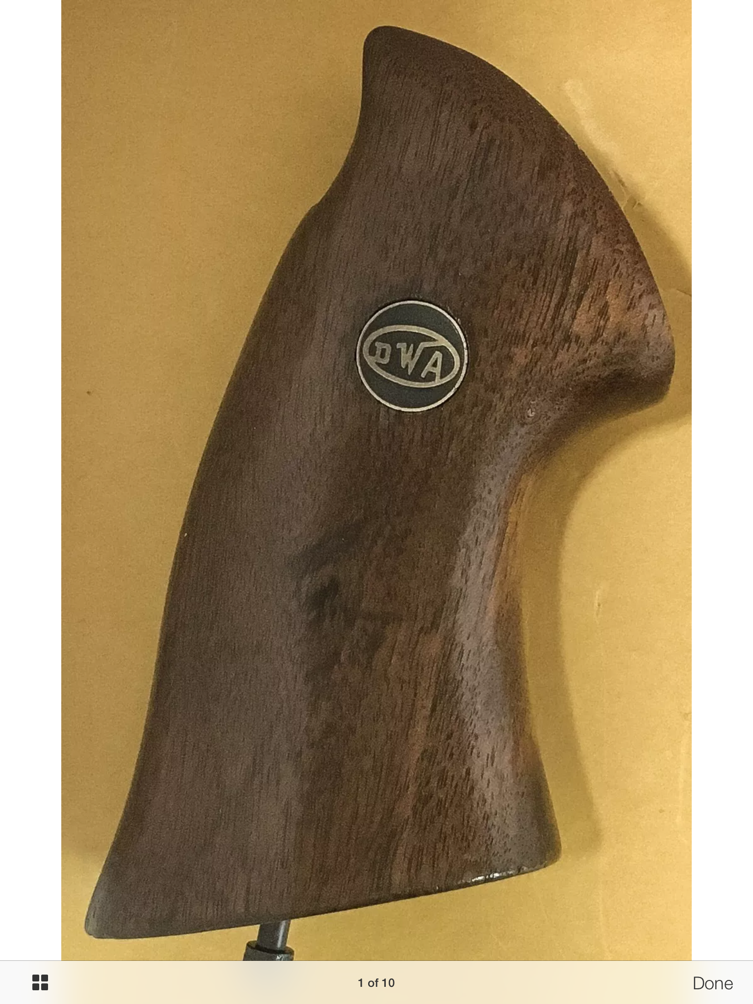

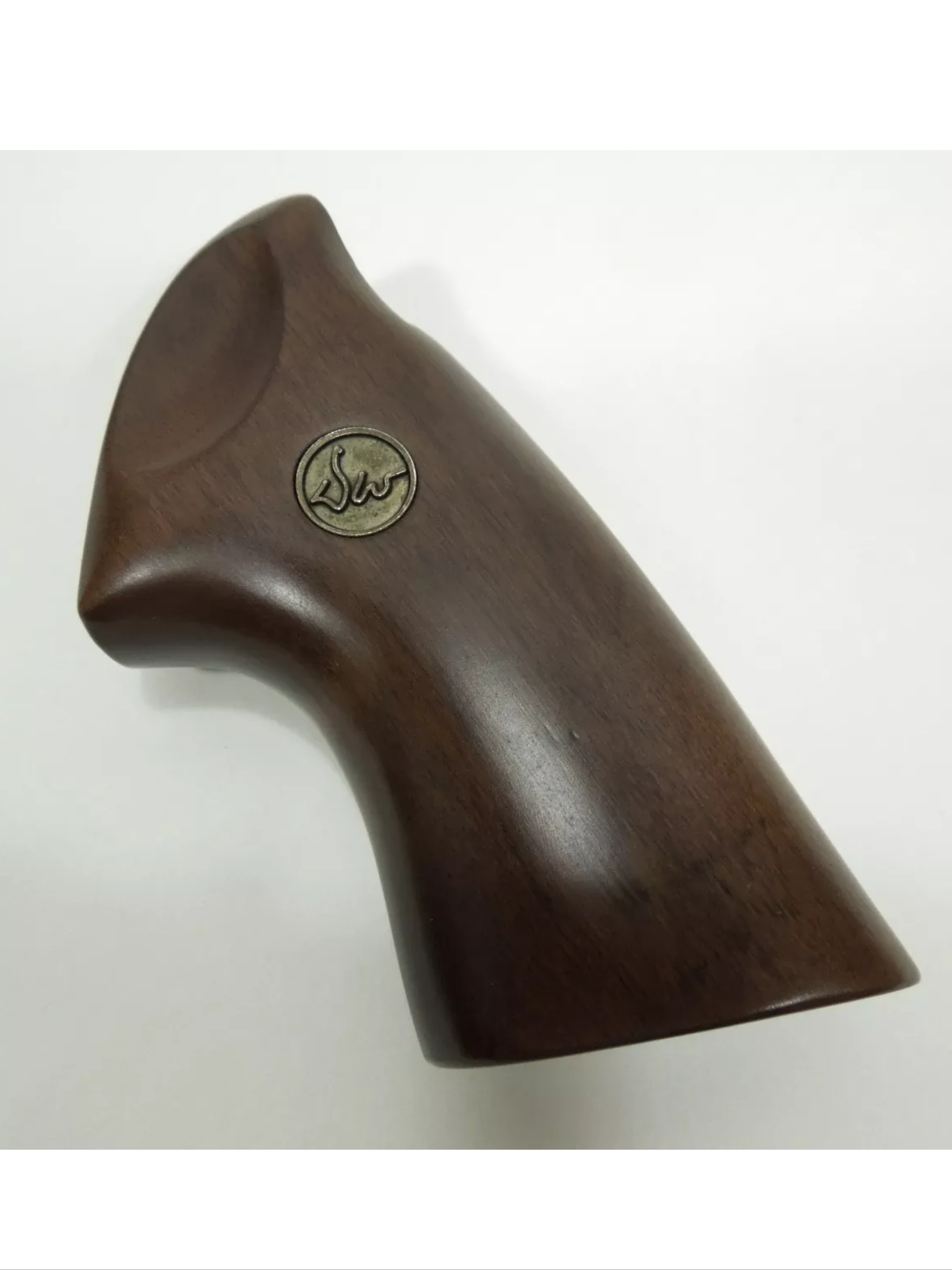

Can anyone share hare info on either set of these grips?  I've gotten them as replacements for the Pachmayr presentation grips that came with the gun.
IMG_0557.PNGImage Enlarger
IMG_0558.PNGImage Enlarger
Also, I have a set of small/medium frame combat grips in average condition that came with my large frame gun.  I'm looking to trade or sell them for other DW, but have no idea if they are worth $10 or $100.  Any info there would be spectacular as well.
October 6, 2016 - 10:30 am
Both appear to be large frame walnut grips. The top one "may" be one of my customs or may be a OEM refinished. Hard to tell from a picture. Worth is subjective to who is selling and who is buying.  Check the online sources (GB, Fleabay) for a idea of the current market.
October 9, 2016 - 10:36 am
The top one appears to be a large frame  with early DWA medallions put on instead of DW ones. The  DWAs were used before large frame guns were sold so they could not be original. If the bottom one has a square tang hole it is a highly desirable small frame smooth target grip. If it has a round hole it is a large frame grip. All the large frame grips were smooth I believe. That was to let the gun  slip in your hand to help tame recoil.
