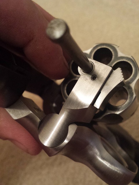

The latch seems to be hard to depress. Not a smooth motion. If this makes any sense at all.
April 10, 2014 - 12:15 pm
I am going out on a limb here and please take no offense if this seems elementary. A lot of folks who are used to other brands of revolvers have an issue with Dan's. Try holding the revolver by placing the trigger guard in the palm of your left hand and with your thumb holding down on the cylinder release, simultaneously push the cylinder out from the back side with your finger tips. Also you should take the latch out and clean and lube that area. The latch should move up and down without issue.

April 10, 2014 - 2:08 pm
Just remove this screw and the latch and spring will slide out.
I shamelessly swiped this pic from superdan. The screw is normally an Allen head but I have seen a few flat head models, not sure if they were OEM or not.
Guests
April 10, 2014 - 3:35 pm
I removed the screw and thanks to you I found my problem. The latch itself is dragging making it difficult to open the cylinder. How can I solve this problem?
Now how do you adjust the screw when replacing it-how far in & how far out ie: what position does the latch have to be in when replacing the screw? Several times I replaced the screw and the latch wouldn't move at all.

April 10, 2014 - 3:53 pm
A good scrubbing to start as a lot of crud gets blasted into the area during firing. If that doesn't work make sure the latch slides freely without the spring. Clean the spring anyway as a matter of principal at this point. More spray cleaner everywhere on the cut & the catch/spring.
Basically the catch should be 1/2 way between UP & DOWN, there may be a little wiggling to get it to fit back in properly. The screw should go back in just far enough to be flush with the front of the crane, no more.
Once the parts are clean & if the springless catch slides smoothly reassemble & test again. Its a step-by step process where you'll find as you fix the big problem the smaller one reveals itself. Then you fix that & look for the tiny one & so on.

April 10, 2014 - 5:01 pm
The other part of the latch problem is the notch that the latch locks into. The notch that the latch locks in to must be very clean (I use a dental pick to clean this area).
The DW cylinder lock up relies very heavily on the front cylinder locking up very firmly and consistently.

I just took the latch out and upon checking, I found that the latch was grabbing-seems to be catching on something. Not all the time, but most of it. I took some 320 grit paper and smoothed several areas, and cleaned the area. Working better, but still have a way to go.
Forum Posts: 5418
April 10, 2014 - 7:37 pm
Please use emery cloth or a stone- #320 is too coarse. With the cloth you can get to the inside of the groves on the crane..  check your spring too; there may be an issue there as well.  Be careful not to round the groves- use a well fitting square stick or something...
